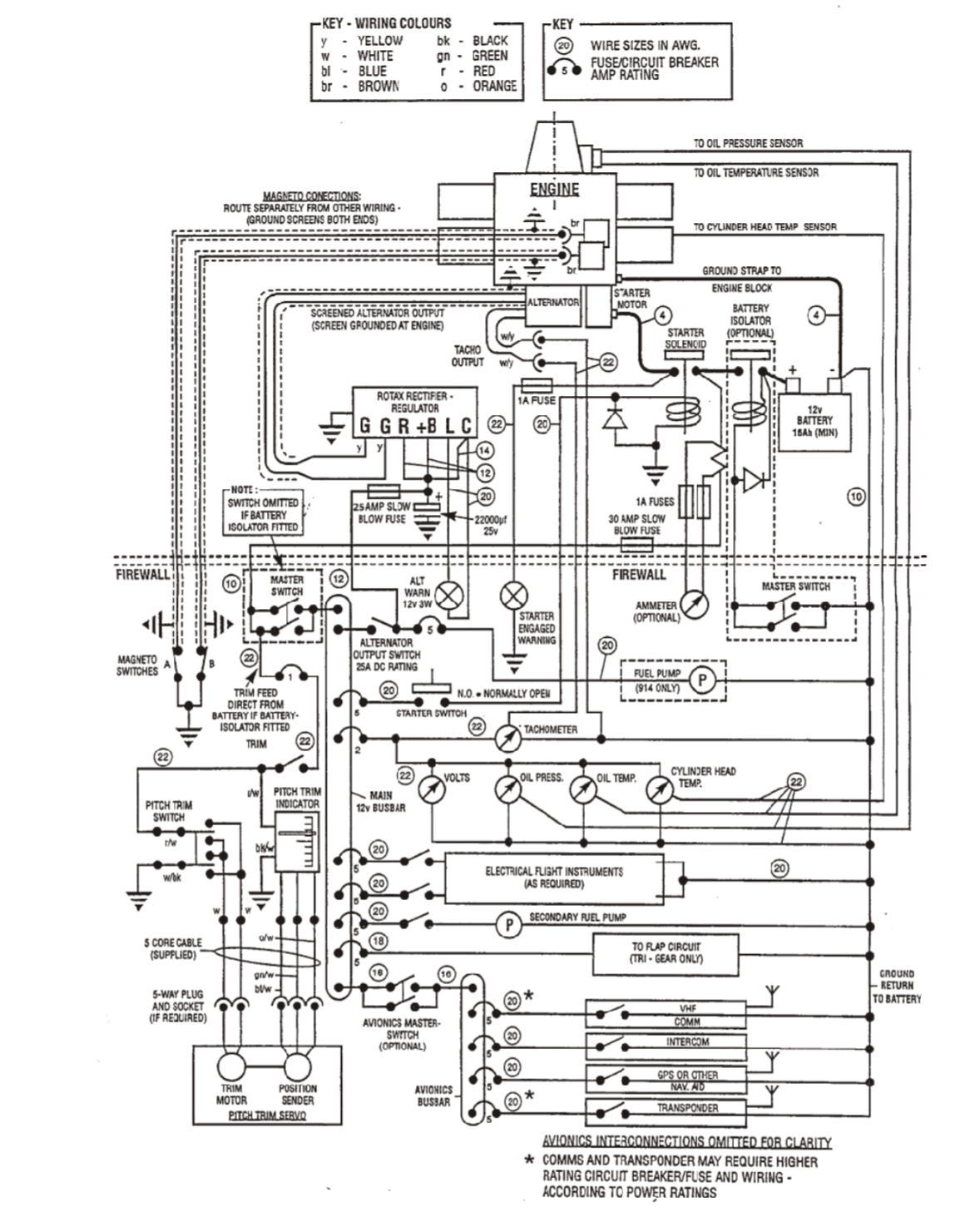

1.  Here is the wiring schematic which is stock Europa.
2.  the "slow blow fuzes" in the diagram where replaced with 25A and 30A Circuit breakers respectively
3.  The spike occurred when I pulled the ALT circuit breaker while the engine was running.  I didn't leave it out for long because I was worried about damage to the system.
4.  I did not pull the battery CB at the same time.
So in summary the ALT CB, when pulled, shuts down the ALT feed to the bus.
My understanding was that one needed to be able to power the electrical system from either the battery or the alternator alone in the case an emergency.
Many thanks
Will

From your diagram, I cannot see any reason for an excessive current spike when the alt switch/breaker is pulled, and the battery is left in the circuit supplying the total load (since the capacitor i referenced is before the alt switch on the alt side).  You are correct that you should be able to run off battery with the alt disconnected. What is the voltage on the bus when on battery only? What is the buss voltage and battery current with everything turned on and engine stopped (and alt cct bkr pulled)? You could also try starting and running with the alt disconnected, and monitor/record the current and voltage.
Something seems amiss if you are seeing a 60A current spike when taking the alternator out of the cct. Could it be that you actually have a short somewhere on your buss, and the alternator is working like crazy to satisfy it, partially masking the ammeter reading? Is the alternator actually charging the battery when in the cct and engine running? What is the buss voltage in that condition?

PeteMany thanksStand by.   I am in, of all places, istanbul.  On my way back to base tomorrow.
Will perforn checks over the weekend and report back.

Pull the batt cb: no change:  8A 13.8v assume everything runs off alternator.
Pull both cb: non dynon  instruments go dead...dynon continues to function on back up battery.  Indicates 1a 13.9v.  I am assumjng the 1a is the dynon back up btty
So to me this seems normal.
1.  When you turn off the battery everything runs off the alternator - normal volts and amps.
2.  When you turn off the alt the system runs off the batt...i dont understand why the batt should be 1a (the back up batt).   The main batt is an 18 amp hour batt.
Does this sound ok?
Will
