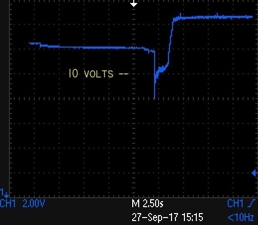

This trace I captured of my 87 GMC pickup
was no doubt produced by inrush from a wound-
field starter. Here we see that the bus
falls to 8v for a few hundred microseconds.
[img]cid:.0[/img]
Figure 1.
I suspect that my younger cars may have PM starter
motors. I'll look into that.

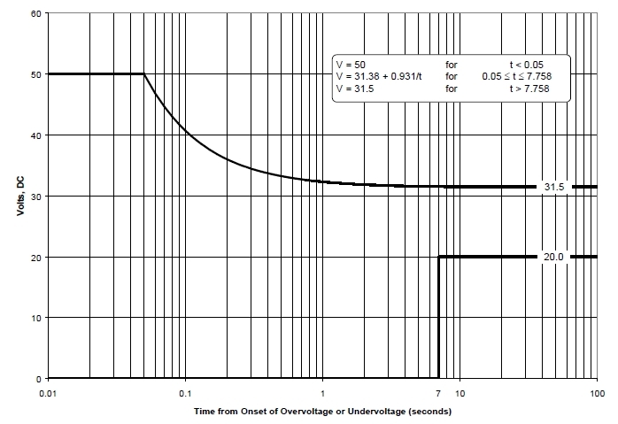

We had some discussions at B&C many years ago about
the market shift of permanent magnet starter motors.
We elected not to join the parade . . . primarily
because the wound field motor had lower inrush
currents and offered better cold weather cranking
efficiency when the battery was being degraded
by the cold weather.

At the risk of being redundant, I'm repeating an assertion
that was offered some years ago when engine cranking inrush
reboots first raised their heads . . . I think it was back
in the days of Blue Mountain market roll out.
At that time, I posted the image above excerpted from
Mil-STD-704/DO-160 assertions suggesting that suppliers to
the industry should expect power perturbations over the
constellation of conditions illustrated.
Since that time, a number of processor based products have been
introduced to the market that re-boot when the bus falls
into normal/expected regions during engine start. While
the condition doesn't damage the appliance, it does
interrupt normal operations until the thing stands back
up. Intuitively, I believe it's possible to design this
characteristic out of most such products . . . but until
and unless the marketplace makes their desires known to
suppliers, nothing will change.
In the mean time, consumers of such products are obliged
to make fundamental changes to power system architectures
to accommodate an appliance that might well have been
designed for airplane friendly operations in the first
place. It wouldn't be out of line for Listers who
own such products to put the manufacturers on notice
that they've stubbed their toe.
