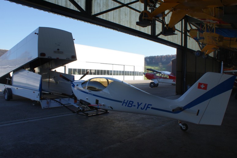

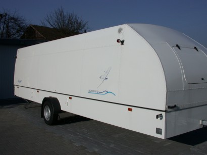

I bought an excellent trailer by
http://avionic.pl/index.php/pl/kontakt-2/ Laszek Matuszek
from Poland. It's special made for mine Europa Classic. The only information
he had for construction were some photos and the drawing from the AFM.
Price was about € 12'000.- in 2013.
For the Tri-Gear it must be a little wider and the fuselage should turned
to prop side back, giving enough space for the wings.
I don't know where you live, but the best way would be visiting Laszek
with your Europa
for discussion and planing.
Best regards
Ruedi Vogel

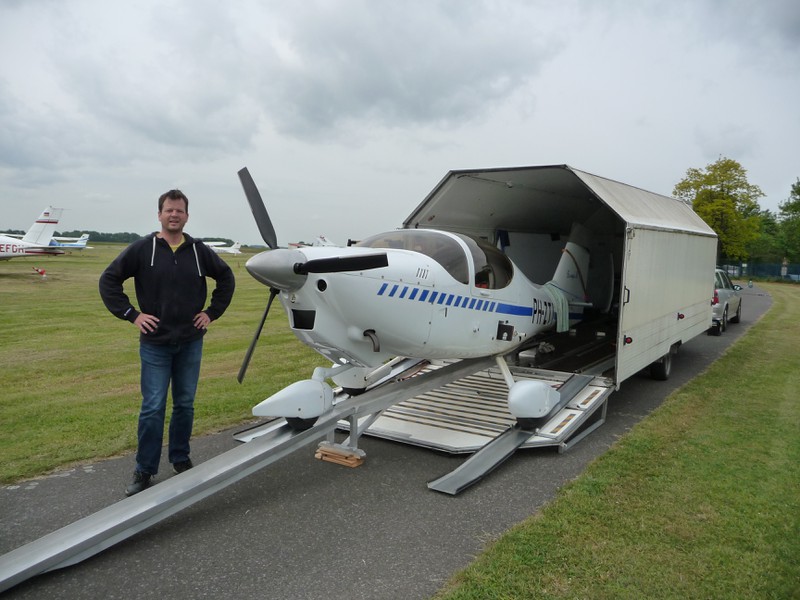

Hello,
I have one from https://www.anschau.de/english-version/ . It costs some 17k EUR. The Wheel-pants don't have to be removed and I use it for 6,5 years now to transport my Europa anywhere I want.
I add a photo.
Roland
PH-ZTI
XS TG 914

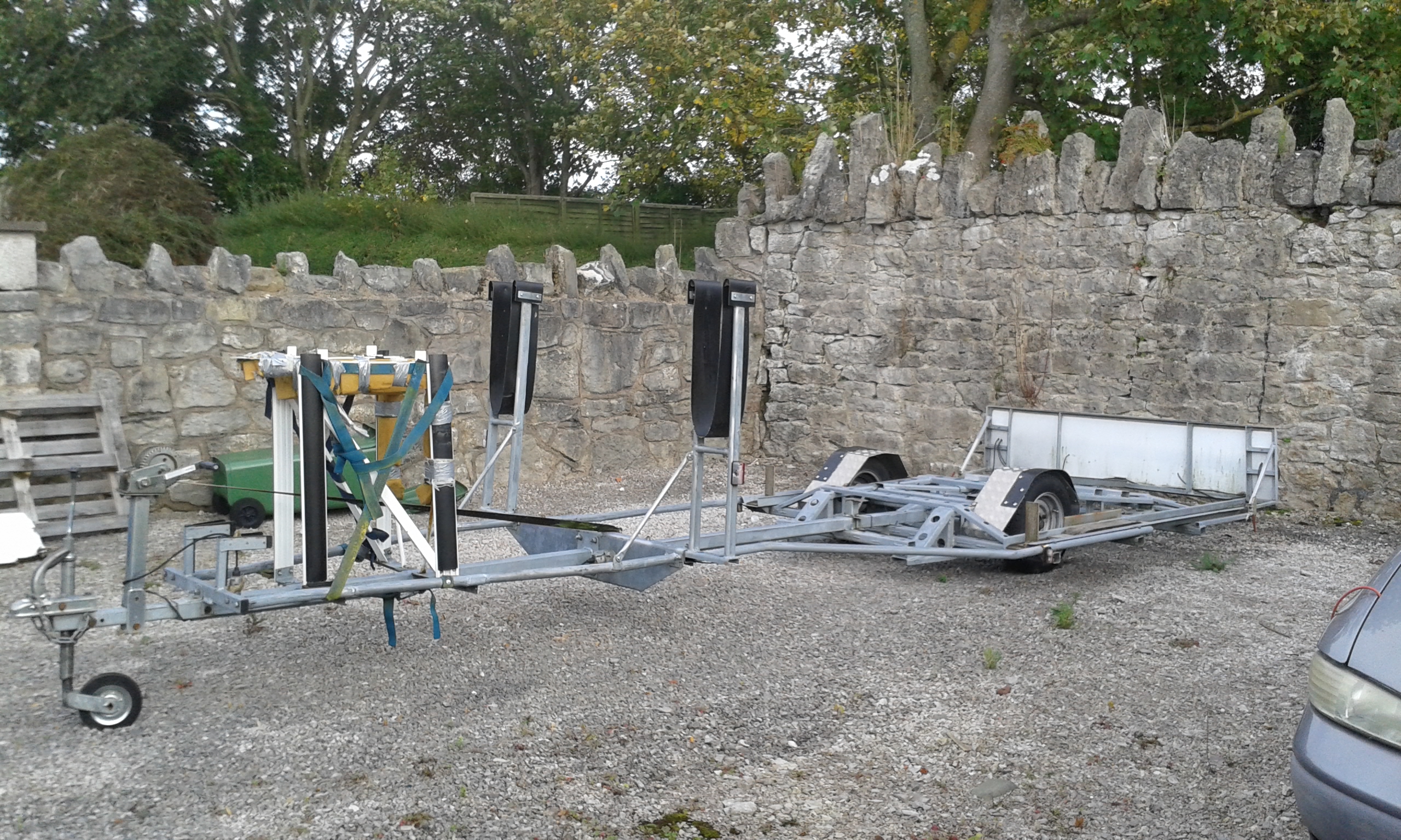

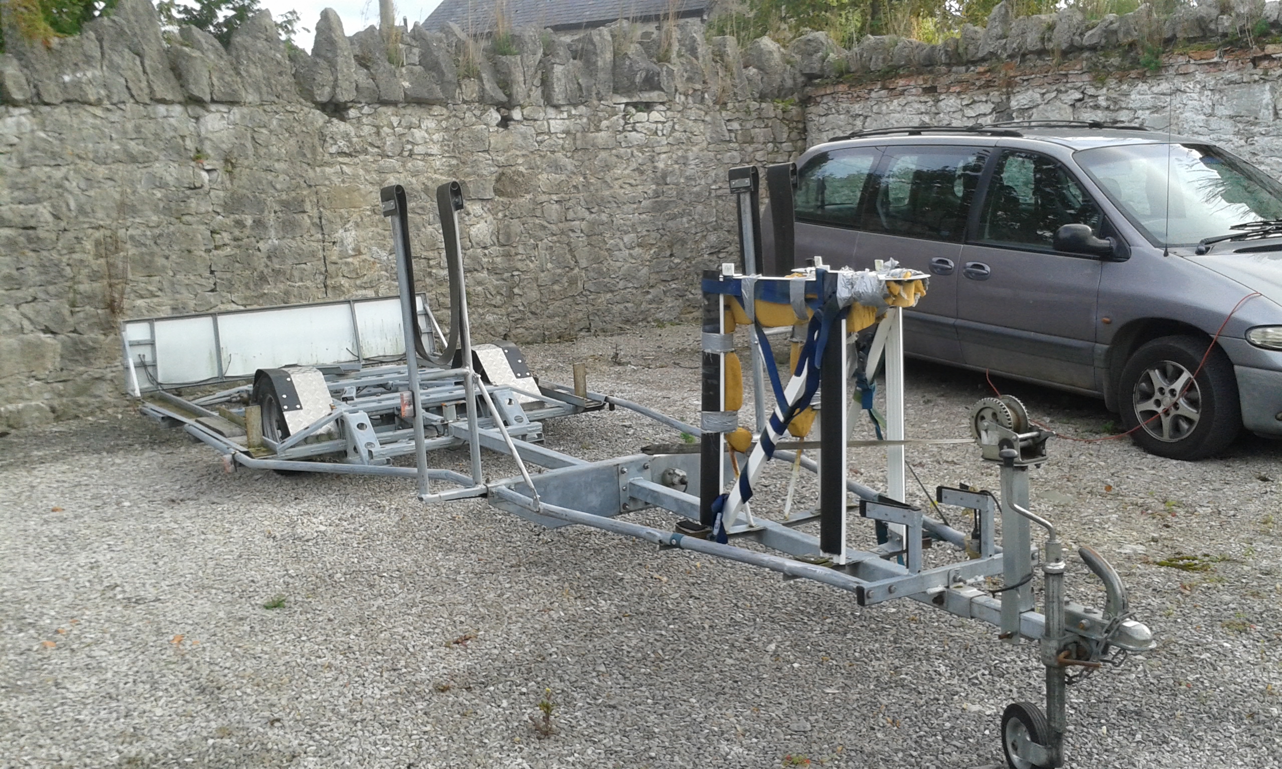

Hi , what type of trailer do you need ? if it's an eclosed
then the one's others have surjested look ideal. In my case I only need
a basic trailer to take my a/c home once a year for it's annual. I was
fortuneate to have a friend (aircraft fitter) who worked at Manchester
airport who inturn had a friend who designs trailers for racing cars. It
was a few years ago.
If you do some research you should find some metal fabricaters who could
make one up for you. I've attached a couple of pics. I think it cost about
 £ 2.500 . the only thing they needed was the wieght and balance of the
a/c.
Danny shepherd g-ceri
