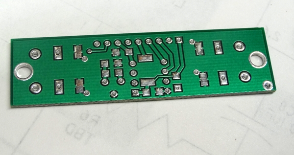

Somewhere in the pile on my bench, I have some of the
development ecbs shown on the linked page.
You could assemble one with driver transistors
and build an array of relays to handle video
switching.
Found one . . .
[img]cid:7.1.0.9.0.20171011132126.06006048(at)aeroelectric.com.0[/img]
 Filesize:  132.26 KB
 Viewed:  3963 Time(s)

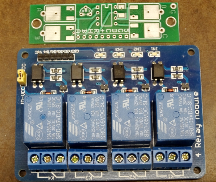

PostPosted: Wed Oct 11, 2017 10:54 am    Post subject: Constructing an automatic RCA video camera feed splitter Reply with quote
switching.
Poked around a bit in the residual components
and assemblies from other tasks. Ran across this
4-relay assembly that already has driver couplers
and transistors. This board could be combined with
the timer board (sans drivers) to get you
75% of the way to video switching Nirvana . . .
[img]cid:7.1.0.9.0.20171011134858.070b7d60(at)aeroelectric.com.0[/img]
You'd need to box the thing up with connectors
to mate with your external components. I'd probably
fabricate a box about 3.5 square by 1.0 thick with
a d-sub connector on it.
 Filesize:  358.46 KB
