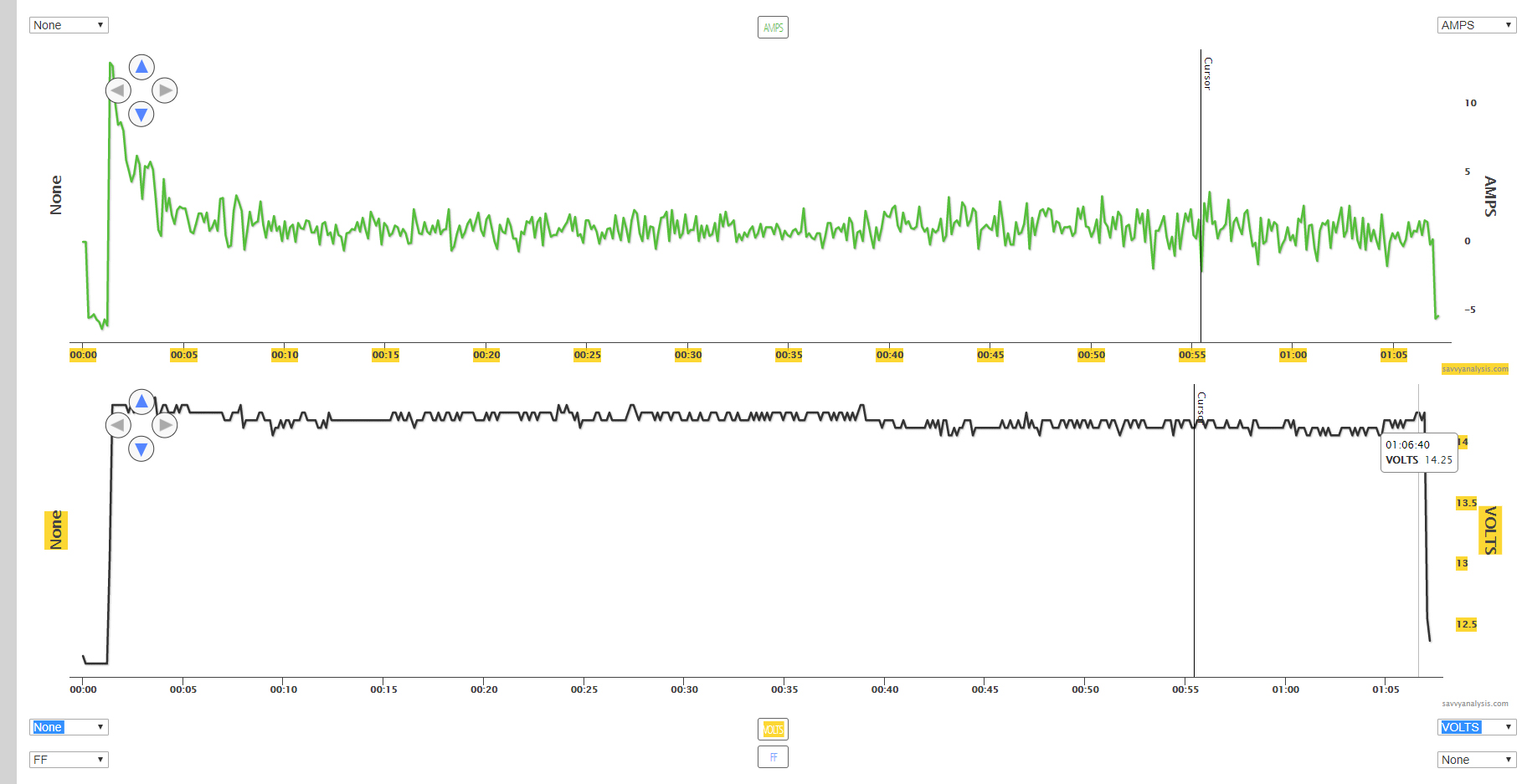

I am doing the test flying on a friend's RV-6 and as part of the preparation I set up the engine monitor (Dynon 120) to display the following on the voltmeter and ammater:
Voltmeter: Red below 10V, Yellow 10-13.8V, Green 13.8V-14.5V, Red > 14.5V
Ammeter (wired to show current flow in to the batter): Red < 0A, Green 0 - 5A, Yellow 5-30A, Red > 30A.
Battery is an Odyssey PC680 AGM. Alternator and regulator unknown, came with the kit from Van's 10-20 years ago. My guess is Plane Power.
First Question: Do the ammeter settings seem reasonable? Obviously any discharge (<0A) is red as indicative of a problem that requires landing ASAP. Normal charge after a start has been observed to be < 5A within a minute after start, a hard start or low battery would obviously make this worse so I set green as 0-5A but don't have any good basis for this. Same for the yellow and red bands. I want the yellow band to indicate that a long time in this area is a problem, and red to be an immediate problem. Normally once the battery has been charged after a start the value should be zero so perhaps the green band should be 0-1A? What charge level going into this battery would indicate an immediate problem (red band)?
After first flight the low current alarm was constantly going off so I changed it from <0 to <1. Second flight had similar but not as frequent problem so I was going to lower it a little more but then I was able to download the engine monitor data to Savvy and WOW is it fantastic being able to look at graphs of engine data. I have no idea what normal would look like but here is a snap shot of the second flight:
You can see the battery amps wander between -2 to +2, with excursions to -3 +3 later in the flight (during large engine power changes).
Second Question: Is this behaviour indicative of:
A. Normal operation
B. Sensor problem
C. Charging system or battery problem
D. Something else
Thank you all for your input.
A. Normal operation
B. Sensor problem
D. Something else

Very interesting Joe, thanks for the reply. Did you try upgrading the firmware? Did you follow up with Dynon about this behaviour? In view of your experience I think I'll give them a call on Monday.
Sebastien

cluros(at)gmail.com
PostPosted: Sat Sep 23, 2017 8:25 pm    Post subject: Voltmeter & Ammeter normal ranges Reply with quote
I'm guessing from some of the responses I'm getting that the picture I attached did not go through. The apparent current flow out of the battery is not from a high load. We're talking a 40-60 amp alternator powering 10 amps worth of instruments and radios. The load cycles from -2 to +2 amps at least 50 times over the course of a 1 hour flight and it's not because someone's hiding under the floorboards flicking the lights on and off Smile.
I'll try attaching the engine analyzer data again tomorrow. I did manage to check a few minutes of data from an identical analyzer in a different aircraft and while it did cycle up and down a bit, it never showed negative.
Sebastien

I did get the pic, but honestly didn't pay any attention to it. Just took a look. Note that voltage never drops below 14V. So the charging system is working great. My personal opinion is that you have too much of the wrong information, and not enough needed information.
Where is the shunt wired into the system?
Is it really a shunt, or a hall effect sensor?
What does the current do with *all loads except the battery removed*? (Yeah, I know you can't do that since the monitor is embedded in the EFIS.) How about with everything turned off except the EFIS/monitor?
A typical shunt has, IIRC, a 50 millivolt full scale output to the meter. Assuming it's a 60A shunt the output at the currents you're measuring would be wandering around a few thousandths of a volt. That is a very small signal, and as others have hinted, relatively easy to impress noise onto the lines. And the most minute variations in resistance of any connection anywhere in the sense circuit could cause large variations in voltage at the meter.

Exactly. Joe could you please confirm that the jpeg below is visible? If so it's obvious that while the voltage seems to be moving around a tiny bit, it never gets to the point which would allow the amperage shown. It's always above 14V. Also I checked some data with the engine shut down and while the amperage still wanders around it's 1 A or less (-5.5 to -6.5 A)

As long as system voltage is above 13, it is impossible for current to flow out of the battery.
Digital data acquisition is fraught with
opportunity for confusion/error. Depending
on how the variable is sampled, pre-filtered
and software filtered, data displayed or plotted
can take on the appearance of instability.
Unless you're measuring the output from something
like a battery . . . or a laboratory power supply,
the stimulus being observed will have some noise
on it. This is especially true of signals gathered
from the DC power system of any vehicle.
When I'm gathering data on relatively low frequency
events, my DAS pre-filtering is usually rolled
off at 10 Hz. Then interpretation software is
designed to do a 'rolling average' on sampled values.
For a DAS set up to gather 100 samples/second, we'll
buffer 16 samples in a memory stack, take the sum
of those values then divide by 16 for an average
of that 'packet' of data. When the next sample comes
in, we add the new value, throw away the oldest value
and do the average again.
This pre/post processing of data does a nice job
of ignoring the high frequency perturbations that
are riding on top of the value of interest. The
processed data plots are nice smooth lines that
are more meaningful.
I suspect that data plots taken from most
EIS systems have little pre-processing and no
post processing . . . so the traces are understandably
'ragged'. So while the voltage traces might
be interpreted as 'unstable', it's probable
that the system is operating normally.

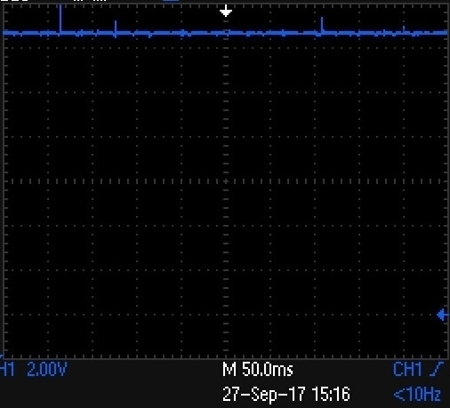

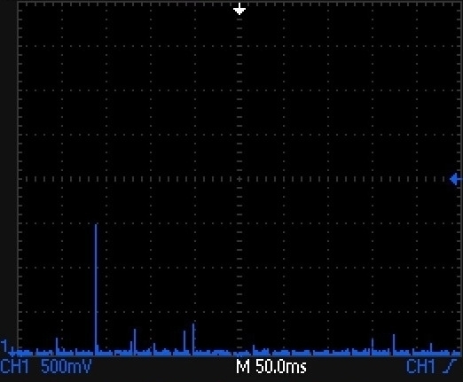

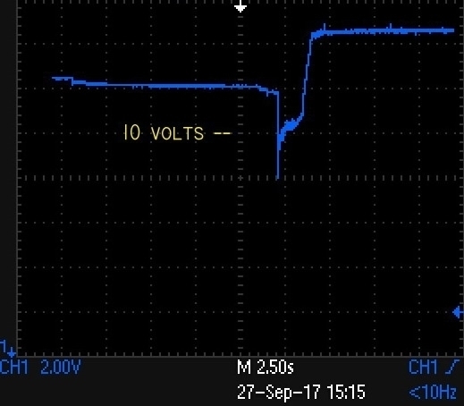

Just for grins, I took the 'scope out to peek at
the 14v bus in Dr. Dee's '87 GMC Sierra. With
the 'scope set to 2.5S/div H and 2V/div V, we
get the following trace when cranking the engine.
[img]cid:.0[/img]
Figure 1.
Note that battery voltage starts to sag from
about 12.8 volts but takes a steeper slope
as the starter contactor is energized followed
by a profound drop to 8 volts as the contactor
closes. A few milliseconds later, the voltage
rises to about 10v until the engine catches
approx 1.2S later and the alternator kicks
in . . . whereupon but bus rises to about
14.6V
[img]cid:.1[/img]
Figure 2.
In the next plot we see that the bus is 'steady'
at about 14.7V with the occasional perturbation
combined with some little 'spikes' with an amplitude
of 1 to 2 volts.

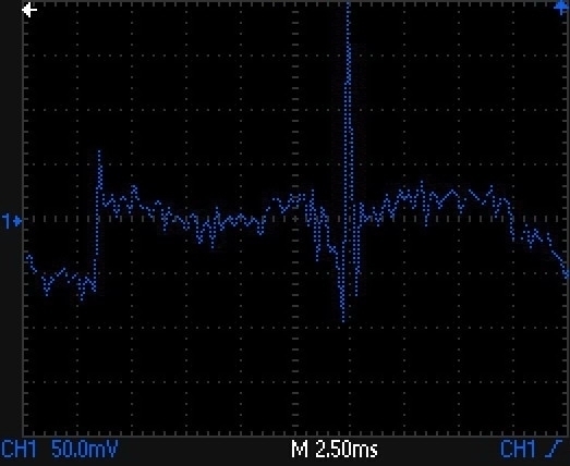

To get a closer look at the voltage in the
next plot, we need to turn up the 'scope sensitivity
and to to AC coupling:
[img]cid:.2[/img]
Figure 3.
With a vertical scale of 0.5V/div and horizontal
of 0.05S/div we can get a better look at the 'noise'.
This particular trace caught a 1.5v transient amongst
about 10 smaller artifacts.
We see that even when there are no obvious
transients, the horizontal line has 'thickness'.
Zooming in closer:
[img]cid:.3[/img]
Figure 4.
We find that the horizontal line is 'fuzzy' with
positive and negative going transients on the
order of 300mV peak.
Depending on where your digital data acquistion
system takese a 'snapshot', the sampled votlage
might appear to 'wobble' by as much as +/-0.5V.

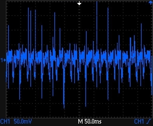

Spreading out the major transients by a factor
of 20 . . .
[img]cid:.4[/img]
Figure 5.
Shows that they're about 400 microSeconds wide. These
plots offer a small peek into the nature of DC power

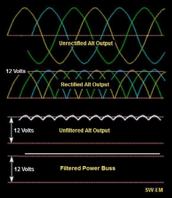

systems on vehicles. A few weeks ago, a thread on
another list server offered this image suggesting
that the full-wave, rectified 3-phase alternator
would produce wave forms something along these lines . . .
[img]cid:.5[/img]
Figure 6.
Theoretically true, but I've never seen so 'clean'
a picture in the wild . . .

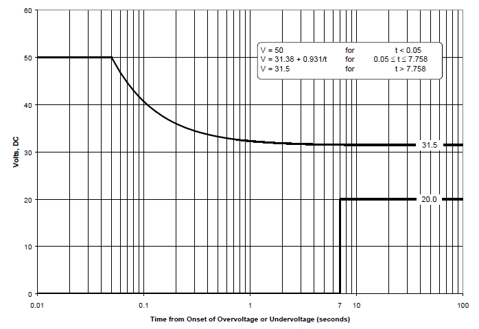

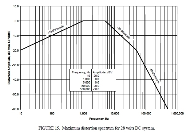

Referring to Mil-Std-704 we learn that DC power systems
demonstrate a certain amount of noise (distortion)
under normal conditions. The document cites
the following plot for a 28v system (cut the
numbers in half for 14 volts).
[img]cid:.6[/img]
Figure 7.
Over the range of 1000 Hz (1 milliSecond period) and
10,000 Hz (100 uSecond), we should expect artifacts
of noise up to 0.5 VRMS (1.5 volts pk-pk) on a 14V bus.
Above and below those frequencies, the allowable/exoected
noise levels fall off. When you hook an oscilloscope to
the bus, the best you can do is sample small features
of the noise as illustrated in the first 5 figures. Further,
you'll never see the pristine plots hypothesized in Figure 6.
[img]cid:.7[/img]
Figure 8.
The most significant attribute of a DC power system is VOLTAGE.
Referring again to Mil-STD-704 we find the plot above. Again,
cut the voltage levels in half for a 14v system.
This figure suggests that any voltage vs. time condition
below the upper trace . . . and above the lower trace . . .
is a condition to be expected for designing and operating
appliances powered from the DC system.
  of 1 to 2 volts.
 of 20 . . .
[img]cid:.4[/img]
 Figure 5.
[img]cid:.5[/img]
 Figure 6.
[img]cid:.6[/img]
  Figure 7.
[img]cid:.7[/img]
Figure 8.
[img]cid:.0[/img]
  Figure 1.
  14.6V
[img]cid:.1[/img]
  Figure 2.
[img]cid:.5[/img]
 Figure 6.
[img]cid:.6[/img]
  Figure 7.
[img]cid:.7[/img]
Figure 8.
