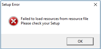

I understand that the owner has had a stroke. I wish the best. But in the meantime, has anyone taken over Kitpro? I had issues with windows 10 for a couple of months, but the fix was posted on the Kitlog page (thanks). Now, I can't load my database and I am getting no response from Kitlog emails and/or phone calls. Does anyone have any information?

It probably requires an older version of .net. I'm not at home or I would look it up.

I had similar login issues with Windows 10 each time MS pushed a W10 update. I followed Matt's instructions in the attachment each time Kitlog couldn't load the DB after a W10 update. It's worked twice for me. Seems to be a conflict with .NET Framework. I made sure to copy the DB, twice, just in case.
Note, this was based upon my specific reported issue of Kitlog simply not loading and giving the following error:
I am using W10, 64bit.
Bob O.

Simple fix for this. Look at Q1/A1 here:
http://www.kitlog.com/Windows10

Upon some digging, I found out that I still had .net 1.1. When I installed version 3.5, I could open and load my database. However, not I find that I can't upload to my builders webpage. Any ideas there?
