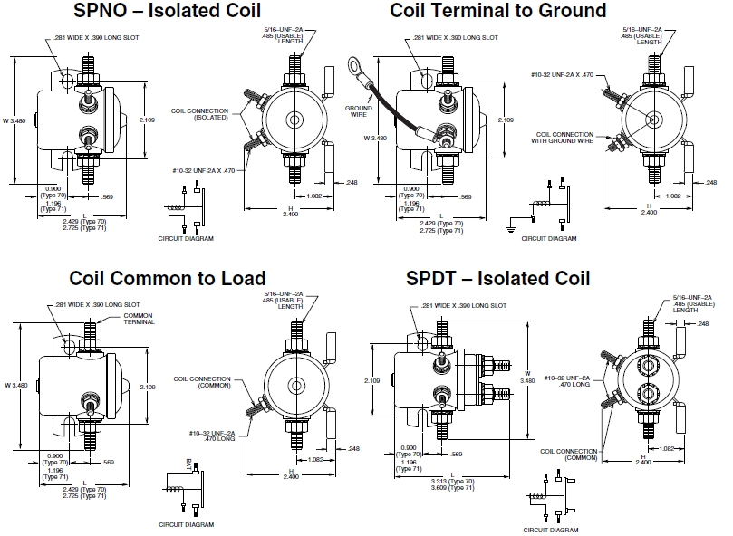

Virtually all manufacturers of contactors will
offer all variants of coil termination. Here's
a sample from the Stancor catalog on the 70/71
series devices
[img]cid:.0[/img]
Note that all variants of coil termination are
offered.
I am surprised that your starter contactor is a ground-to-
energize circuit. I'm aware of no Cessnas that left the factory
that way . . . what year/model is your airplane?

You're absolutely right. I was misreading the mickey-mouse diagram in the POH. When I refer to the wiring diagrams in the service manual it's much clearer. The starter contactor is indeed 12v-to-energize.
