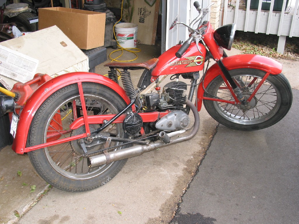

Here in Minnesota there are plenty of snowmobile dealers. So I have been using Polaris two stroke oil, sold in bulk, bring back the one gal jug for a refill. OK that was to keep it about Kolbs. John H. , you touched a nerve! here is the Harley 165CC my dad bought for me back in the mid sixty's. I still have it.
