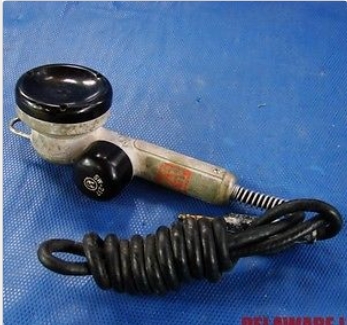

Airplane radios of the 30's and 40's
had a similar problem. The airplanes were
very noisy and there was no practical way
to do the dual-port cartridge to reduce ambient
noise. Aircraft mics of this era typically
had one or perhaps three small holes which
served as a simple, noise attenuator. To be
understood, you put your lips to the microphone's
face cup. Those WWII movies with John Wayne
hollering over the radio with a microphone
10 inches from his face were a bit laughable.
[img]cid:.0[/img]

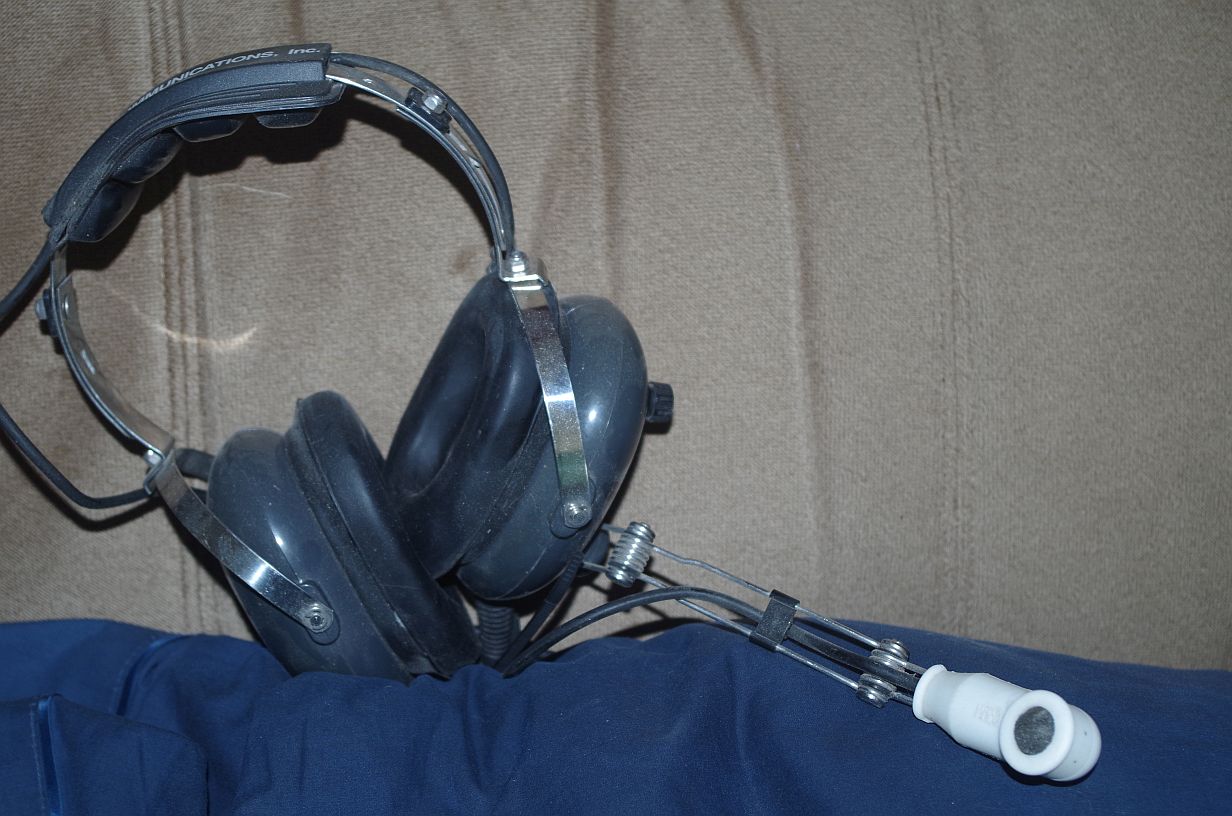

I made a mic cover from a battery terminal cover and some porous foam. Helped with the wind noise in my trike.
Rick Girard

That is clever, I'll try that. I've also been experimenting with using a tablespoon measuring spoon as a wind shield. The two together might be a winner.
Jeff
Sent from my iPad
Rick Girard
