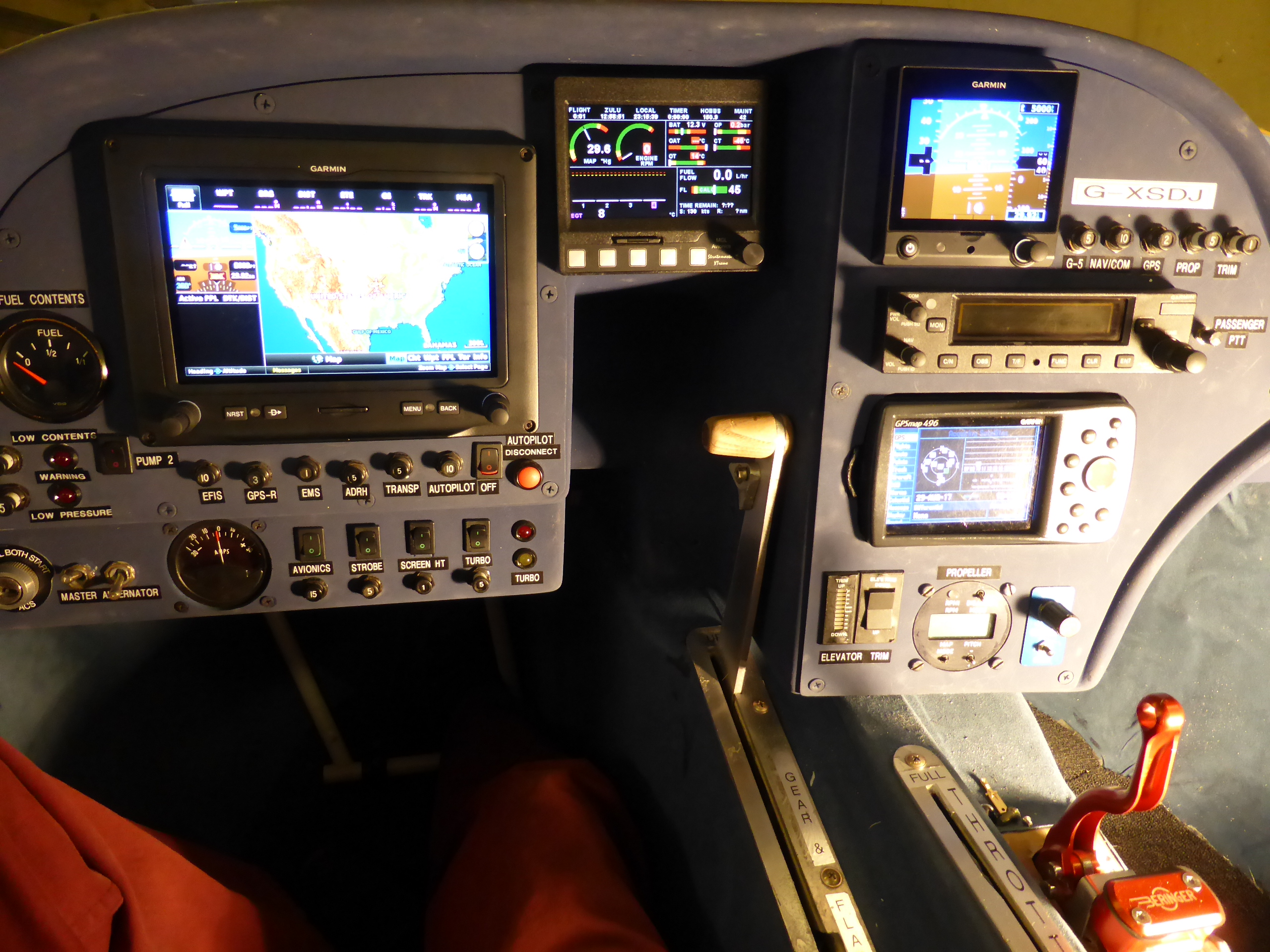

PostPosted: Thu Sep 07, 2017 12:38 am    Post subject: Rebuilding my panel Reply with quote
Pete, A preliminary picture - not set up yet - still thinking I am in US (although it has worked that one out now). My old 496 kept for sentiments sake and because plenty of room on panel. Incidentally my new Beringer brake system also shown.
Regards, David Joyce, GXSDJ

PostPosted: Thu Sep 07, 2017 9:53 am    Post subject: Rebuilding my panel Reply with quote
Looks great! Did the G5 give any issues since the panel is canted in relation to the direction of travel? Can it be calibrated to accommodate? Im also curious what the G3x does without engine instruments, is it just missing from the menus?
Cheers and thx,
Pete

PostPosted: Thu Sep 07, 2017 10:04 am    Post subject: Rebuilding my panel Reply with quote
Pete, I can only answer your first question when I have flown it, but there is I believe a setting up whilst straight & level for the G5 and it is on a Can bus with the G3X system and subservient to that whilst it is switched on so I do not anticipate problems of that sort. The G3X needs an extra module to give all engine data and has to be set up to display it. I positively did not want that, preferring to keep my engine data separately, with purpose designed warning system and not cluttering my EFIS.
Regards, David

peterz(at)zutrasoft.com
PostPosted: Thu Sep 07, 2017 11:36 am    Post subject: Rebuilding my panel Reply with quote
Thx, looks great!
(And do please keep us posted with all your installation experiences Smile

<P1020063.JPG>

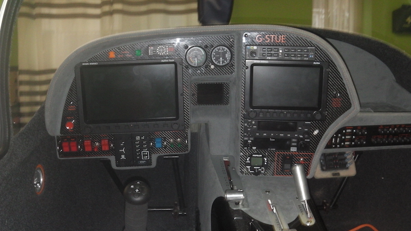

Hey Matt, have you thought about dynon?
 Filesize:  257.03 KB
 Viewed:  19904 Time(s)
