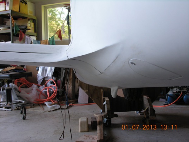

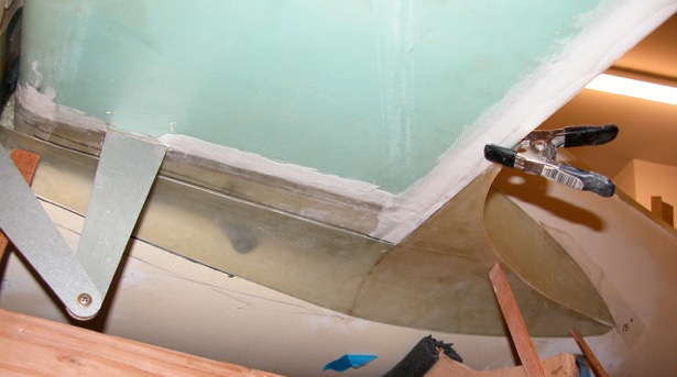

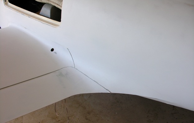

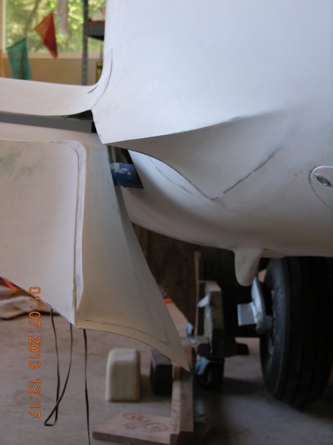

I had a CO problem about a year ago and carried out some investigation. The big clue, found by using a CO meter, was that the CO doubled when the flaps were down. I talked to Andy Draper who said the exhaust gases could enter via the flap slots and travel forwards through the tunnel and into the cockpit via the various control slots. I resisted cleaning my aircraft for a period and traced exhaust stains along the fuselage that travelled to the (Trigear) leg/fuse join and up to the flap slot.
These enhanced wing root fairings cover the flap slot…
Also…one of the reasons my bird has yet to fly...

Finding exhaust intrusion into the cockpit is not intuitive. Your very nice wing gap seal is the key to many of the exhaust intrusion problems.
From older posts on the subject:
NACA cockpit vents supplied in the kit placed low on the cockpit side, allow a direct inlet of exhaust gas to the pilots side.  Placing the vents on or near the fuselage glue line helps.
Always seal the wing root area well as the stock exhaust will arc up right into the leading edge of the wing and come in through the gap, enter the rigging hole and into the cockpit through the tunnel.
Mono wheel extension causes a draw behind the gear arm and can suck in exhaust into the wheel well. Holes in the wheel well around throttle, brake, gear handle etc. and a cockpit that has high draw out will exacerbate the problem.
Exhaust pipes should be long enough to move the exhaust well clear of the cockpit inlets. (This is where my nice short exhaust stack out of the 914 leaves a easily seen exhaust lead trace on the fuselage, that exhaust trace showed that during climb, exhaust gas goes from the pipe, and arcs directly up and over the wing root during climbs below 100 knots. My NACA cockpit vent is right in line with the exhaust trace. As you know I have my Ultimate Ventilators in my windscreen corners because of it.)
You can’t get quality air flow in the cockpit unless the cockpit is a low pressure. The lowest pressure area is on the top of the canopy. If the cockpit seals are not tight, this will lower the air pressure in the cockpit improving the draw of air into the cockpit and through the wheel well to cockpit holes.
The rear fuselage is generally a lower pressure area. I put vents or stand offs the D panel cover to exhaust air out of the cockpit and improve pressure vent performance. At low speed or high angles of attack the suction of air at the wing root fillet is quite high.
Jabiru exhaust pipes coming right out of the center cowl will, at high angles of attack, inject exhaust into the wheel well with the mono gear down. Pipes must be angled to clear the mono trailer arm for transport anyway so move the Jabiru pipes outboard and exhaust intrusion can be reduced also.
Trigear aircraft built with a sealed wheel well, rarely have an exhaust intrusion problem unless the cockpit vents are in line with the exhaust, or the wing gap seals are leaky.
Pay attention to the hole behind the wing root right where the flap and root come together. Looking into the wing root from behind the wing will show a direct path to the rigging hole and a direct cockpit gas entry. (I’ve never had a problem with this hole if the gap all around the wing fillet is sealed tightly.)
Mono wheels in the retracted position tend to have a large bubble of air causing pressure in the wheel well that makes for a high flow of air through the gear, brake and throttle slots in the wheel well making for a cold cockpit at altitude. Keep the gaps around the main wheel as small as possible. Silicone cowl seal or similar will reduce the gap in these slots and help keep dirt, grass and cold air out of the cockpit. (Exhaust also I guess.)
