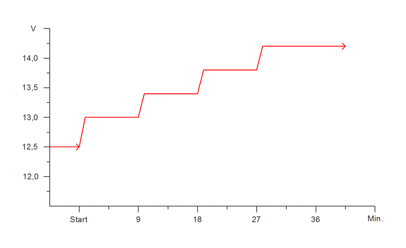

Following on the theme of Battery replacement I have cut and paste the following from a builders website namely “Dog Aviation”.
The “Silent Hektik” F-4118 Regulator is what we want as a direct replacement for the Ducati regulator. The F-4118 regulator also has an added built-in feature of a four stepped voltage output …
so it can be used not only on lead acid batteries, but also on AGM and Ion batteries as well … both of which benefit from the voltage stepping.
The voltage stepping ranges from 13 to approximately 14.3 volts in four steps spaced at approximately 9 minute intervals.
[img]cid:FA3BD131-8EFF-47E9-A8AB-05A4F5BB9B69[/img]
Photo of a charging graph obtained from the Silent Hektik site showing the charging steps for the F-4118 regulator.
