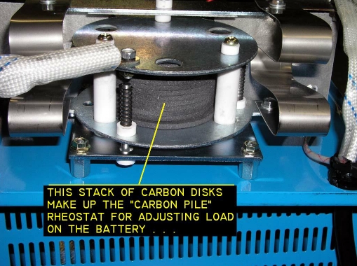

The discharge characteristics are not dirrerent enough to cause a problem using the carbon pile. If you try the pile be careful, they get quite hot. I prefer to use the CBA, but it takes many hours to discharge to 10 volts.
Yes . . . because these are entirely different
kinds of tests. The carbon pile tester does get
hot . . . it will stink at the end of your test.
5-600 amps at 9v is 5400 watts . . . enough snort
to run your house. This energy is dumped into
that little stack of carbon disks.
http://tinyurl.com/ybcc9v9r
[img]cid:.0[/img]
So yes, extending the test beyond 15 seconds
is probably not a good thing to do!

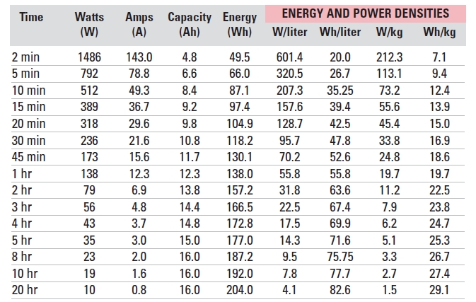

Well, an single SLA has very different amp-hour ratings depending on the discharge rate. And 'consumer' SLAs (PC680, etc that were originally intended for watercraft, and others that some of us use that were intended for UPSs and/or electric carts, etc) are rated differently from the certified a/c SLAs, if I've read spec sheets correctly.Â
SVLA batteries have very significant internal
resistance which wastes energy under load . . .
a loss that increases with load. The battery's
USEFUL capacity must be tied to the load.
Here's the spread sheet on a PC680
[img]cid:.0[/img]
Note that the LIGHTER you load it, the BETTER the
capacity. The PC680 is speced as a 16 a.h. device
at the 20 HOUR RATE.
But cranking your engine at 150 amps will get
your only 2 minutes of operation with a 65%
drop in capacity. The rest of that engergy will
be used up getting the battery hot.

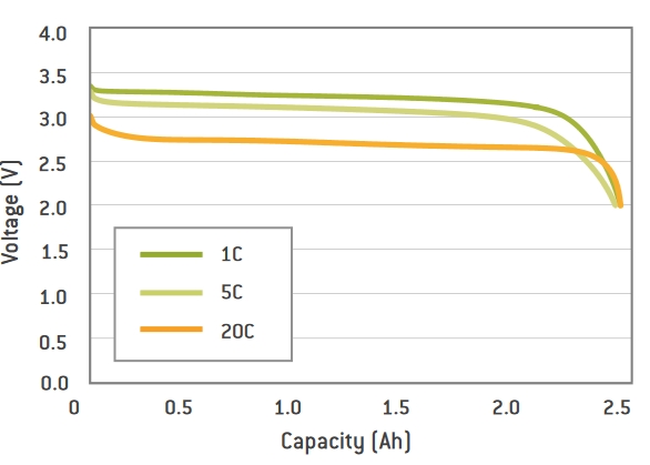

Lithium's very low internal resistance produces
very flat load vs. capacity curves. Here's
an exemplar family of LiPo discharge curves.
[img]cid:.1[/img]
Note that you get essentially ALL the capacity you
paid for irrespective of load.
