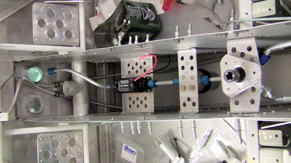

PostPosted: Fri Sep 08, 2017 2:14 am    Post subject: Fuel selector valve Reply with quote
Interesting what Tim mentioned and I compared to the plans he had, indeed from page 37-3 to 6 it is revision 2 12/18/07 and they did add Page 37-7.
They did as well add a bulkhead fitting on the tunnel instead of routing them through the tunnel walls and changed the valve fittings from 45 deg to 90 deg and no crossover routing.
I can however not find any plan update for chapter 37 on the Van's webside
I did modify that whole part with Andair parts just to have a more straight forward setup and will replace the aluminum lines with Bonaco braided fuel lines.
[img]cid:part1.440FD6FE.69C782F1(at)gmx.net[/img]
Cheers Werner
