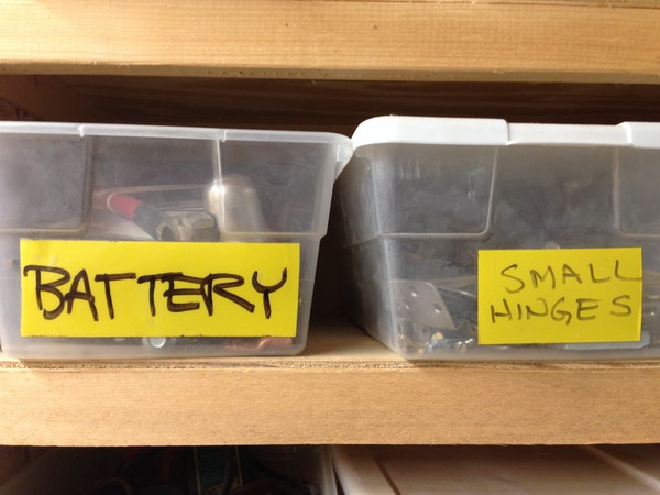

Something I've observed about Sharpie and/or
magic marker inks. I have been using the
6qt 'shoeboxes' by Stearlite as dust tight
materials storage in my shops for several years.
I label the ends of the boxes with yellow vinyl
tape captioned with a Sharpie. The label on the
right is about 10 years old. The drop in letter
density compared to the label on the left is
observable.
[img]cid:.0[/img]
The exposed lettering appears to literally
evaporate. Evaporation rate is probably temperature
and air flow dependent. There might also be effects
of ozone and/or hydrocarbons in the surrounding
air.
I've developed another technique for crafting these
labels. After captioning with the marker, I put a
layer of clear tape over the lettering.
. I'm thinking that the clear overlay will have a
profound effect on the robustness of my shop
labels. For wire labels laid on white heat shrink,
one might consider putting a layer of clear
shrink over the label.
I note too that Sharpies come in a 'permanent'
version which is also available in ultra-fine
points.
http://tinyurl.com/y8rj6t3j
One of these days I'll conduct some experiments
with this marking methodology and I'll hang
some samples under the hoods of my vehicles.

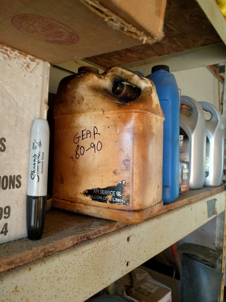

Waaay too many variables, like a lot of stuff we do with experimental a/c.One guy says it (whatever 'it' might be) will never work, 'cause it didn't work for me. Another says it works fine, 'cause it worked for me. Nobody can actually specify every detail, often because we don't know which details actually matter.
This morning, I needed to add gear oil to my finish mower's gearbox. As I was pouring the 90 weight oil, I noticed the 'label' on the jug. This jug is *at least* 10 years old; probably closer to 15, and it's been on a shelf in an open (no hangar door) hangar for its entire life. The marker ID was added after the original plastic shrink labeling fell off, due to oil/etc contamination and damage, very early in the jug's 'career'. Like everyone else, I can't say for sure which marker I used, or even if I cleaned the jug before marking it. I *think* I probably used the brand/style marker shown in the pic, and probably did a quick wipe with alcohol before marking. But it was a decade or more ago, so.....
Charlie

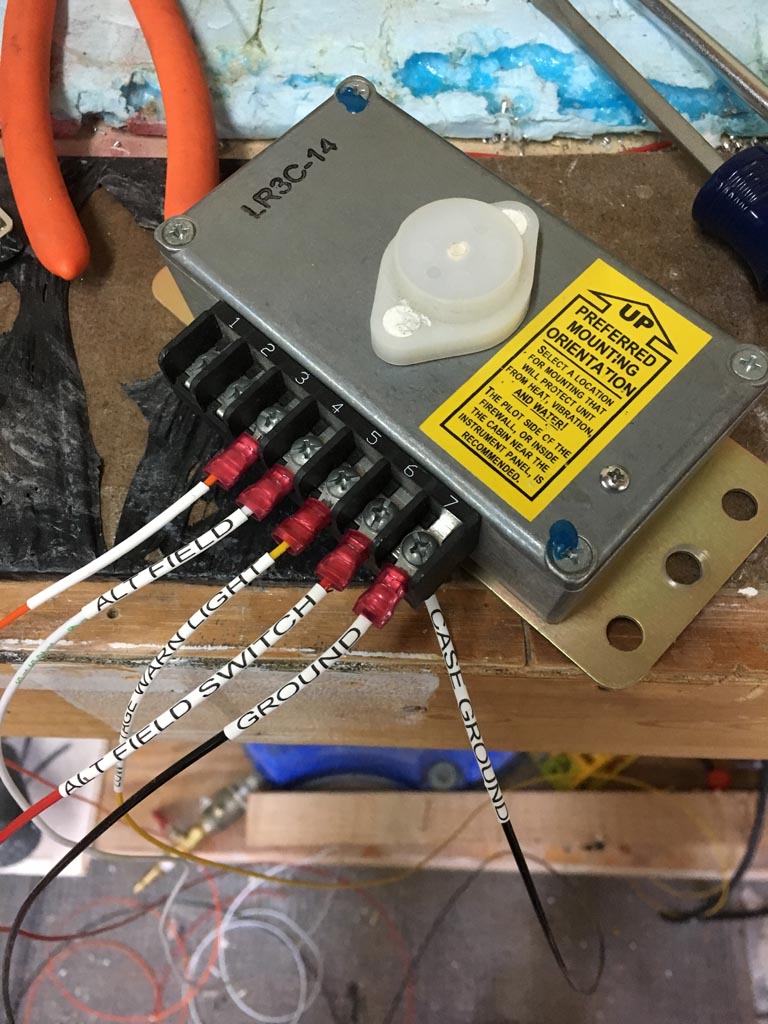

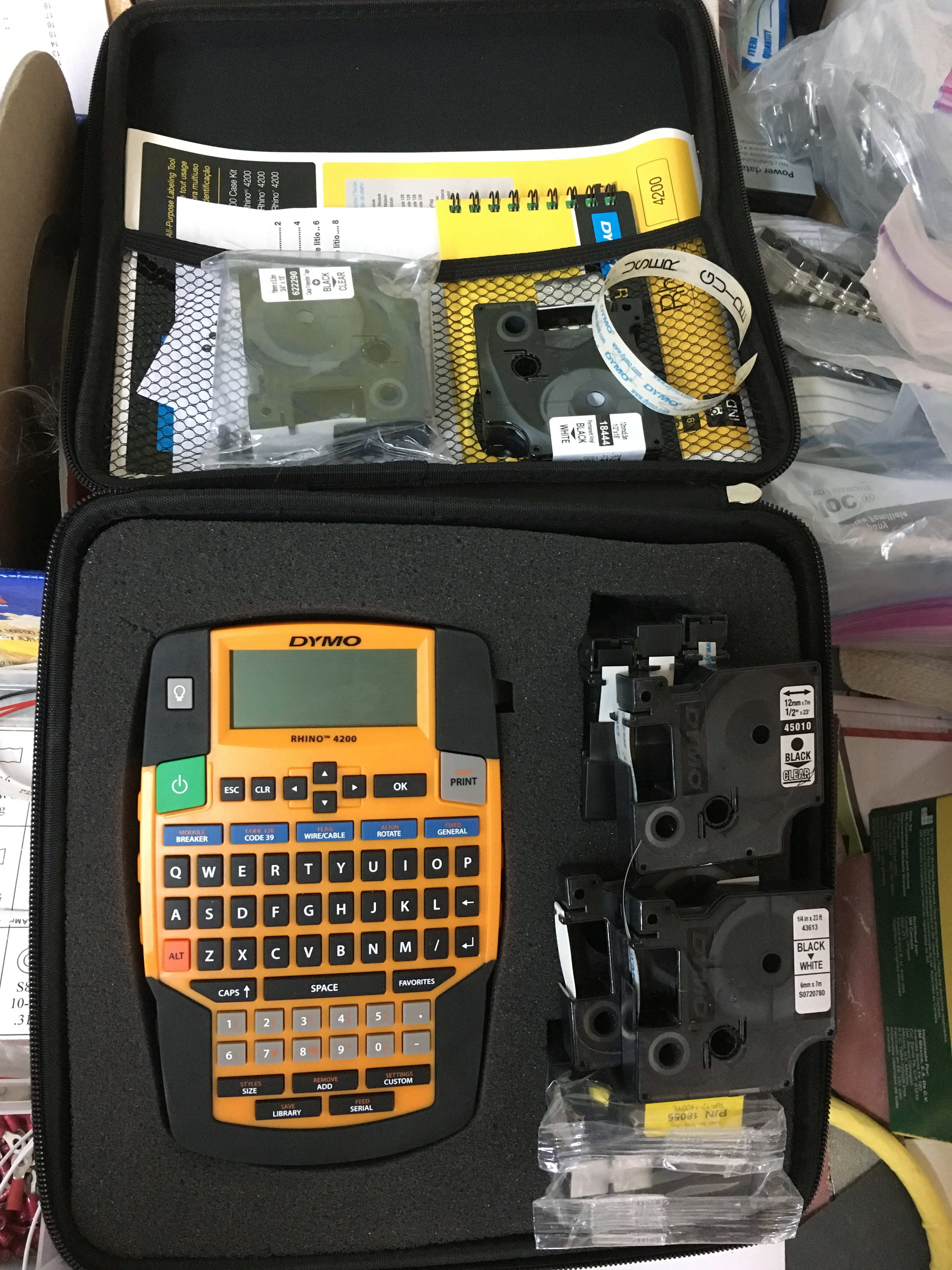

Gents,
Earlier this year I purchased a DYMO RHINO 4200 label machine to replace an old, 1st gen., RHINO I had been using for many years.
[img]cid:C46704E4-3D87-40E5-AD64-F6CB45578E72[/img]
These things print on several types of adhesive labels that seem to stick very well as well as printing on shrink tube. The labels come in clear, silver and white as well as printing in red, black and other colors. The shrink tube is in white or yellow. The labels & shrink tube are available in sizes of 1/4, 3/8, 1/2 and 3/4 inch. This thing is super easy to use. I do recommend not printing one label at a time. Identify and print a large batch all at once to save wastage between labels.
One availability is through Amazon but there may be other sources at better prices. But the Amazon listing shows all pertinent information and has a demo video.
https://smile.amazon.com/DYMO-RHINO-Label-Maker-1801611/dp/B005MR516Y/ref=sr_1_2?ie=UTF8&qid=1504450593&sr=8-2&keywords=dymo+rhino+label+maker

Boy, that thing is really BIG. Are you sure the labels will fit in the plane?
Wink
On Sun, Sep 3, 2017 at 10:50 AM, Robert Borger <rlborger(at)mac.com (rlborger(at)mac.com)> wrote:
Gents,
My best piece of advice is to be sure you are buying real DYMO cartridges as there are Chinese knockoffs that can be of highly variable quality (sometimes equal to DYMO,sometimes crap, use at your own risk).  Those ones you see in plastic bags are the knockoffs.  The real DYMO cartridges come in well labeled boxes as can be seen on the Amazon posting.
I did the print tiny labels on paper and hide under clear shrink, I did the fine line sharpie on shrink tube before the RHINO.  They work but can be a real PITA to accomplish well.  The DYMO is more expensive but it sure is quick and easy to do well.
Just my tuppence on the subject, YMMV.

Hi Charlie,
It’s really not that big. The printer is 4.75” wide x 7.0” tall. It must be the case that makes it look big :^)
Here’s a pic of some wire labels I did yesterday. These are much larger than I normally would print but I was playing with print sizes on some less expensive Chinese cartridges. But you can get the idea.
[img]cid:62128E09-BB24-4BA3-9B3F-1495CD510482[/img]
There are labels on my Europa that were done over 10 years ago with my old RHINO that are just as readable as they were the day they were printed.

That comment was a joke referencing the size of the image you sent. (Way bigger than the computer screen)
Sometimes it's hard to push a joke past the NSA's humor filter; it just comes out the other side meaningless.

Charlie,
I figured it was a funny. That’s why I had to add the point about “case making it look big :^)” But took the occasion to add a bit of info as well. As for the size of the image, I reduced the dimensions by a factor of 4 and quality by half to get it to that size! I guess I should have gone for an 8x reduction. I’ll try to remember that the next time, max dimension only to be 512!
