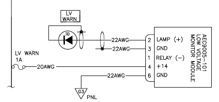

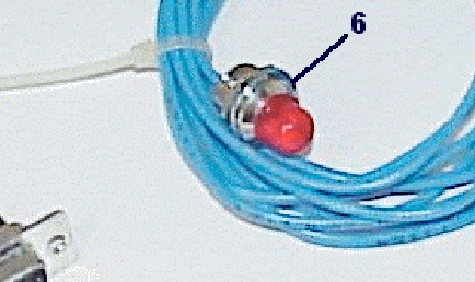

Example: I used to supply an LED annunciator
fixture where is was MECHANICALLY convenient
to use a single shielded wire to make connections
with the back of the LED.
[img]cid:.0[/img]
In this case, the shielding was NOT being
utilized as a noise mitigation feature . . . it
was simply one of the power pathways for the
lamp.
In this case, installation instructions
called out the appropriate treatment . . .
[img]cid:.1[/img]
[img]cid:.0[/img]
  lamp.
[img]cid:.1[/img]
