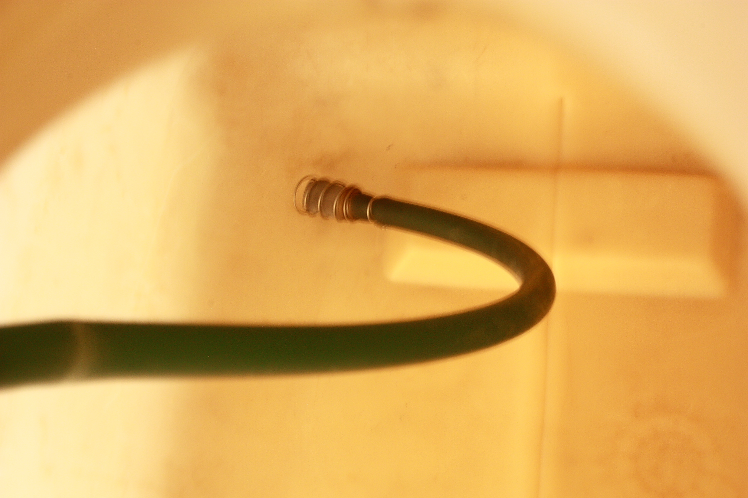

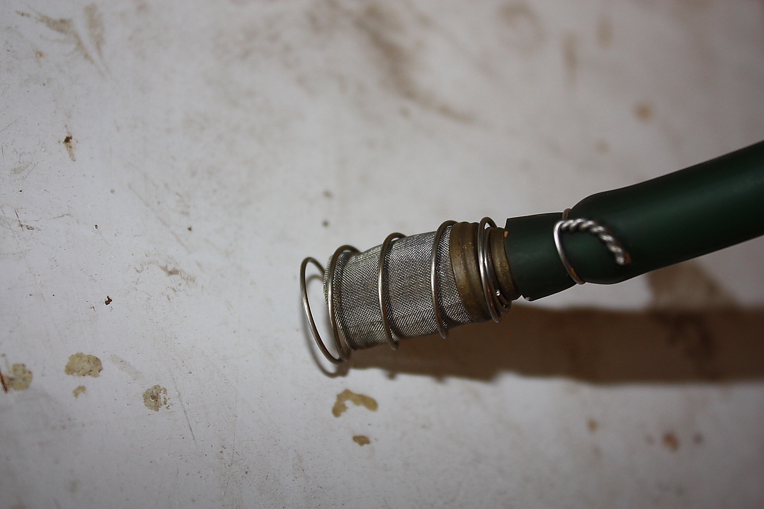

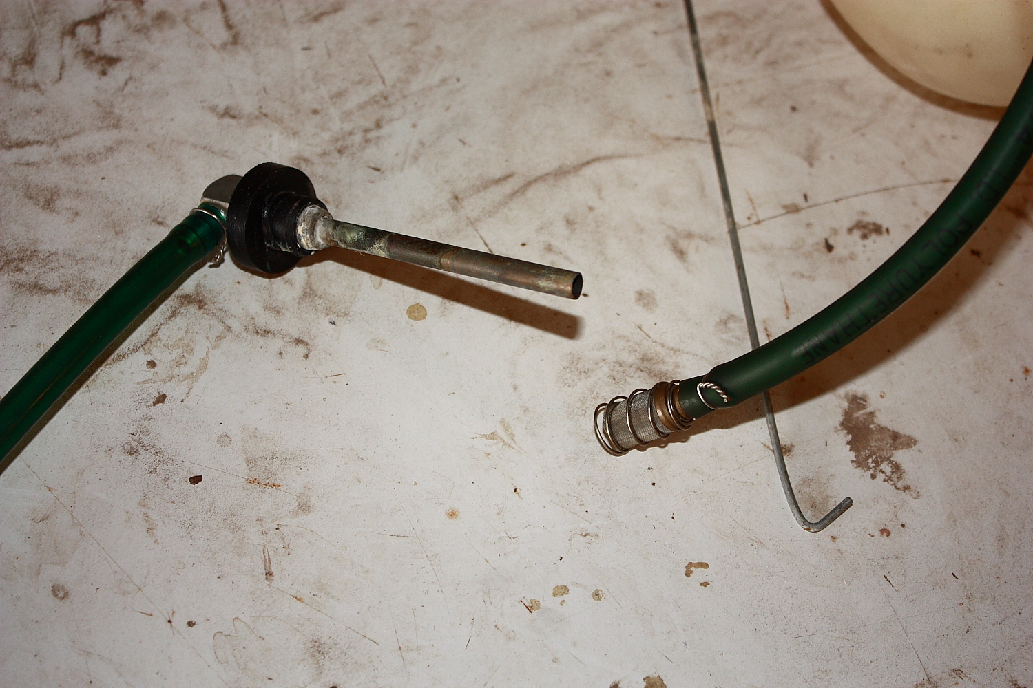

I don't recall how I managed to secure my extension, but I am sure I had to go to solder to get it done.
Here are some pictures of what I use. My theory was that a flexible tube with a weighted filter pickup that could slosh around to where the fuel was no matter the attitude would not be a bad thing.
The little filter was from Model airplane fuel pickups. The fuel line being inside the tank has never been a problem and is still flexible and it has been there for some 20 years.

I have the 6 gal tanks that Kolb sells and also the pickup tubes. They reach the bottom easily.

I agree Larry. Flexible fuel line pickups work great. Never had a problem with them on my MKII. I do think that the tubing should checked annually. And after a short time after initial installation just be sure the tubing used likes fuel.

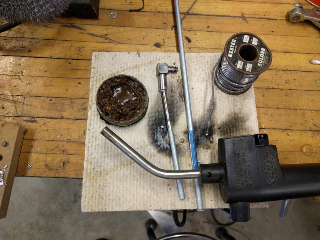

PostPosted: Thu Aug 31, 2017 10:25 am    Post subject: gas tank top feed hardware? Reply with quote
Well, finally gave up on the plumber's flux & went with tried & true electronics stuff. Heated the fitting & dipped it in my tin of paste flux; after that, soldering using rosin core 50/50 was uneventful. In case anyone's wondering, solder apparently can't go bad. That roll of Kester in the pic is my father's. He turned 100 last June. And it's entirely possible that he inherited it from *his* father, but there's no mfgr date on the spool.
