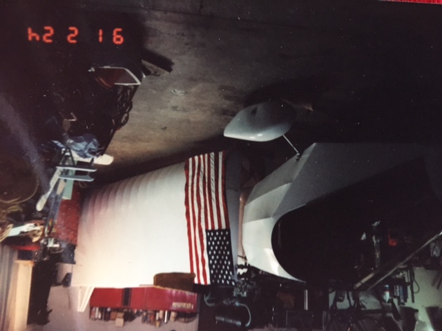

I ran a 503 single carb on mine. It liked 50 to 52 mph on climb out as I recall? It's been a lot of years ago. I built Twinstar, TS 205. It came with a wood 68" Tennessee Propeller. Which worked great. I later went to 64" three blade Ivoprop. It worked fine and was very smooth. I do think it climbed better with the two blade thou. I don't think there was a lot of difference in the gearbox loading. I changed my gearbox oil every 50 hours and never noticed any excessive wear. I flew the Twinstar for about four years. It was a good unit. A bit sluggish, but it is a two seater after all.
