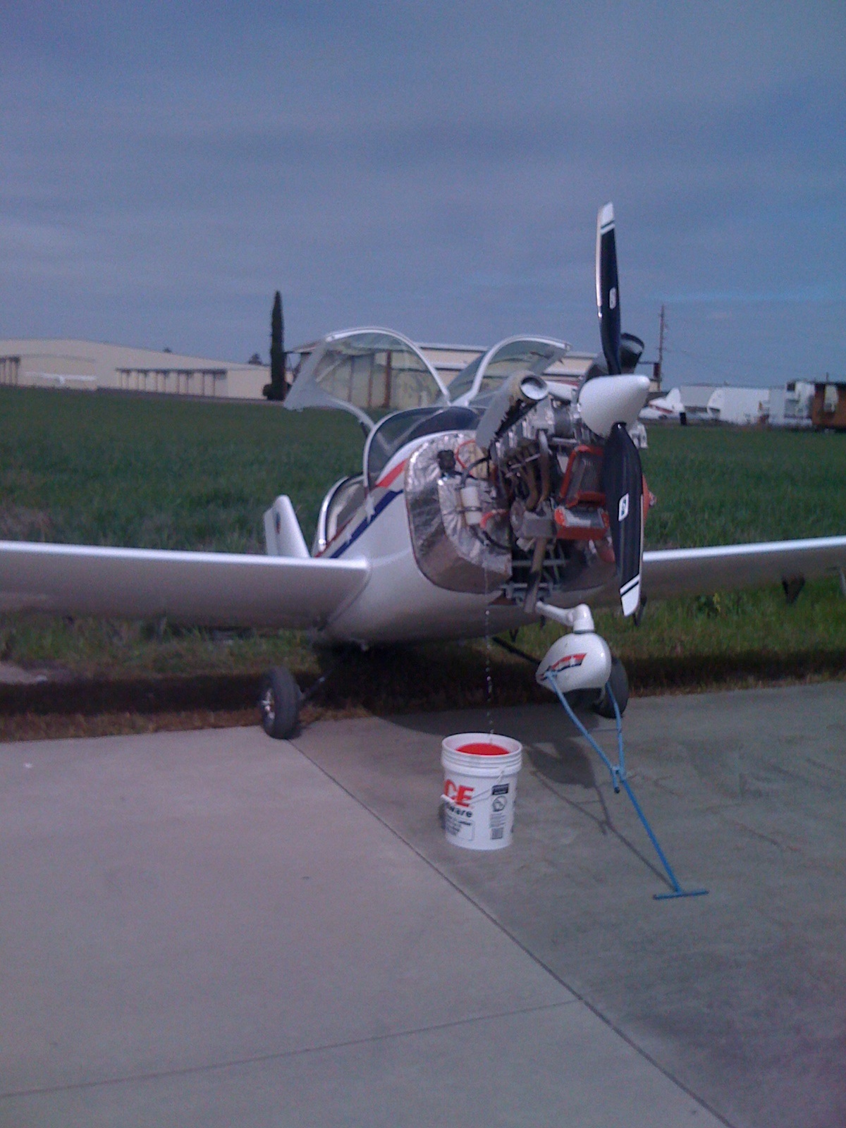

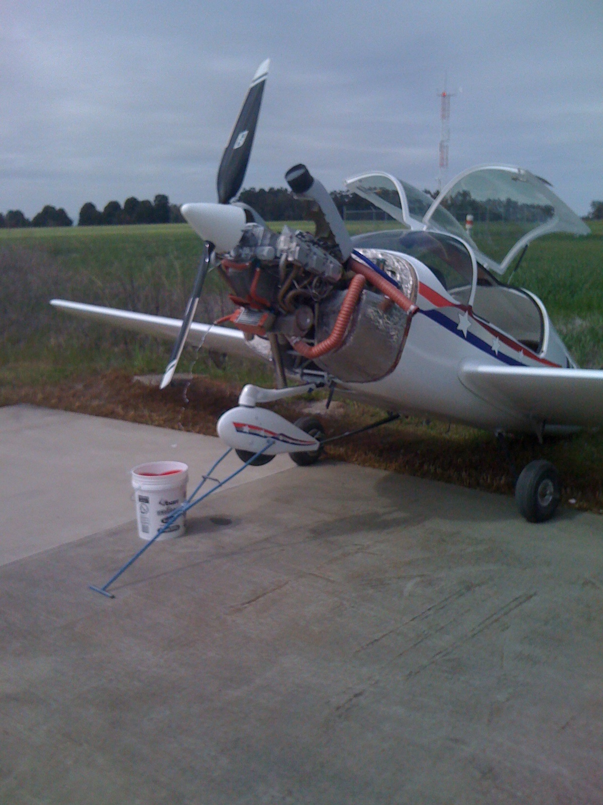

PostPosted: Fri Aug 25, 2017 6:36 am    Post subject: Re: unusable fuel Reply with quote
please read FAA AC90-89A http://rgl.faa.gov/Regulatory_and_Guidance_Library/rgAdvisoryCircular.nsf/0/D08FA9393154B636862569BA006F6D7F
Section 11, Para. 1 ,e Fuel Flow and Unusable Fuel Check. The whole AC is worth reading and as an EAA Technical Counselor for both Flight & Building I ask everybody to read it before first flight. After a number of accidents and incidents in this area I starting giving a class on first flight to the local EAA chapters. The EAA also has a book that can be downloaded.
I have attached two pictures of my plane undergoing the fuel test and unusable fuel test.
I timed the time it took for the fuel to fill the five gallon bucket then when it quit running cap the line and measure the remaining fuel. If you notice the angle was about 16 degrees or flare attitude. I think mine was about 1.5 gallons remaining.
 Filesize:  453.02 KB
 Viewed:  14447 Time(s)
 Filesize:  454.45 KB

PostPosted: Fri Aug 25, 2017 6:45 am    Post subject: Re: unusable fuel Reply with quote
Should have check the FAA web site before posting! AC-90-89B is current now.
Section 11, Para 1-19, e Fuel Flow (2) for unusable fuel
Hope this helps.
