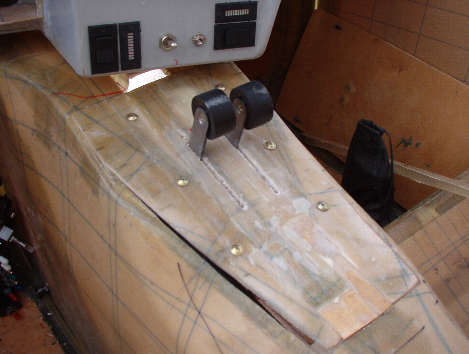

PostPosted: Wed Aug 23, 2017 6:42 am    Post subject: Re: Toe Brakes with Parking Brake Reply with quote
I highly recommend the finger brakes. I had trouble installing the toe brakes and gave up when Europa came up with the kit. One of the problems was the size on my feet and the narrow area of the rudder pedals. The other problem was trying to bleed the Europa brakes. I went with the Marco cylinders and use the brake and pucks supplied by Europa.
Good luck!
