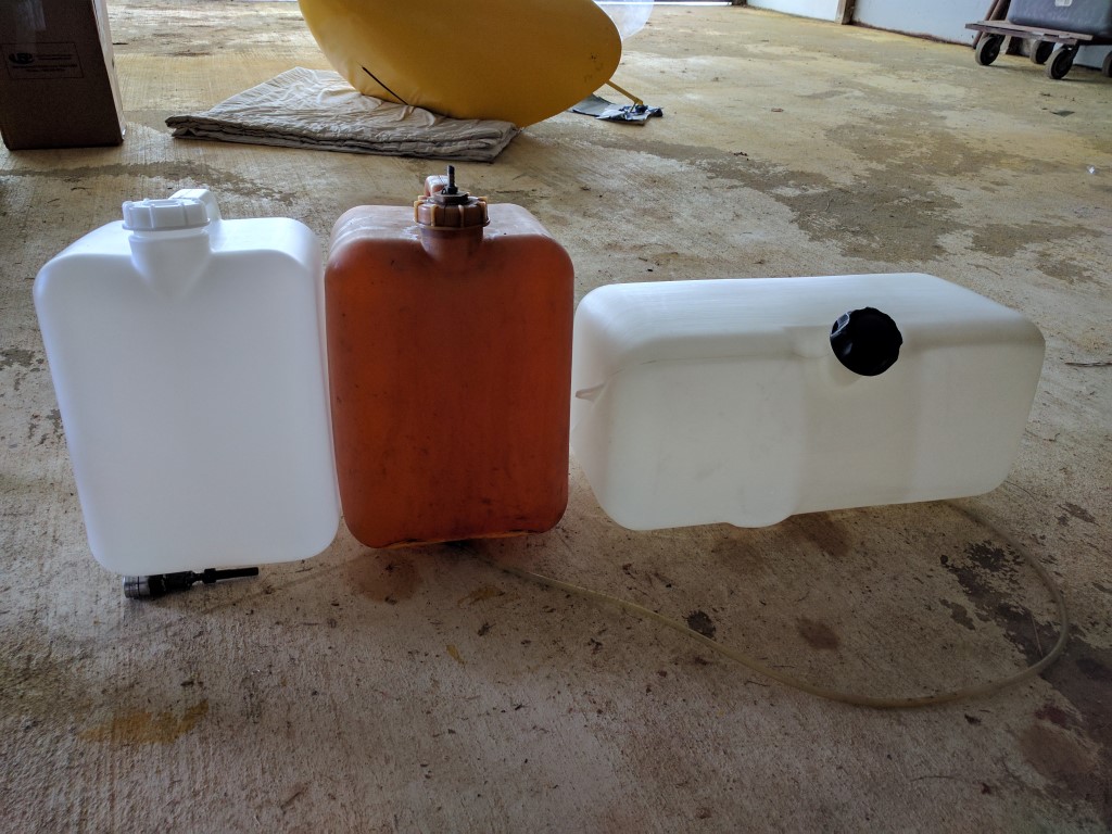

Got to thinking about replacing my tank (which did actually crack sitting here in the ground) and tried to call Kolb last week but I guess they were gone to OSH.  Wondered if I could find it 'online' & found what you see here. On left is a virtually exact replacement, except for the included capped vent on the handle (missing on the original). Less than $13 plus shipping. On the right is an 8 gallon tank from the same vendor. A bit more expensive, but still not bad. Bigger versions got closer to $100, so I didn't order 'samples'; at least not yet.
Not to start a 'feeder war', but how many of you are using top feed tanks? I'm looking forward to the re-fueling process, and being able to pull the cap/feed tube & sit the can on the ground seems like a much easier way to fuel the plane. What say the experienced?
Charlie

I think this a matter of personal preference. I prefer stationary mounting. I don't enjoy restrapping a heavy tank back in place every time. You must have an original Twinstar. The Twinstar MKII like I built had the fuel tanks (2) mounted behind you with a covered firewall so they really couldn't be removed.
In the early days, 1983, ultralighters who flew Phantoms and Avengers use to use top feeders with flexible fuel hose inside the the tank with weighted ends on them for aerobatics and inverted flight . The fuel pickup hose could move from bottom air feeder to top feeder. They also equipped the engines with pumper type carbs for sustained inverted flight. Was never my bag.
I just prefer not taken things apart and putting them back together. That's just my input. You know how opinions go. Whatever works for you.

Yep; very early kit. Hard to visualize either under-wing or over-the-top fueling, with the fill neck a few inches under the wing. It's tempting to mount that 8gal tank on the boom tube, under the engine, if it won't cause cg issues.
I enjoy acro, but I think I'll control the urge while flying this one. Smile
Thanks for the insight.

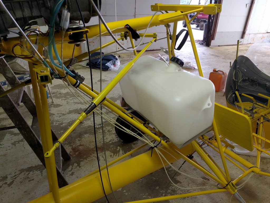

ceengland7(at)gmail.com
PostPosted: Fri Aug 25, 2017 10:27 am    Post subject: Twinstar fuel tank options Reply with quote
On Fri, Aug 25, 2017 at 12:10 PM, Jerry-TS-MkII <12flybellaire(at)gmail.com (12flybellaire(at)gmail.com)> wrote:
--> Kolb-List message posted by: "Jerry-TS-MkII" <12flybellaire(at)gmail.com (12flybellaire(at)gmail.com)>
Thanks for the info.  My intent is to get this in the air before winter... to do a bit of flying,and find out what it might truly need.  So the plastic tank(s) would only be temporary anyway.  In looking inside the fuse, I think a inverted saddle tank, that goes under the boom would be ideal.  But that also means vinyl ester, or aluminum/tig fabrication. better for a winter project.  Installation would be easy from below, and a "normal" fuel tank filler thru the side of the fabric would also be a nice addition.  Something about two tanks sitting right behind my head.. not ideal.  I'll do a search for tank installations or option photos asap.  jr
Aluminum/tank sealant/rivets is also a reasonable option. Closed head 'pop' rivets are available, if you don't have bucking equipment. Attached is a pic of the US Plastics 8gal tank I'm fitting. I wish it would fit between the bracing & the boom tube, but it's just a bit too tall. So, it has to sit in the original location of the 5gal tank. I'll try facing the filler forward, and hope I can set up the root fairing so I can peel it off for fueling. If that doesn't work, I'll just turn it around so it's oriented like the original tank. My ideal choice would be a tank that fits under the bracing, sitting on the boom tube just behind the seats, with the filler pointing forward between the seats (original Twinstar with no enclosure).
If you don't mind the fueling inconvenience (my big gripe with the stock 'high' location) and intend to bottom-feed from the tanks, two of the US-P 5gal chemical tanks is by far the simplest, and cheapest way to go. Probably under $30 including shipping.
