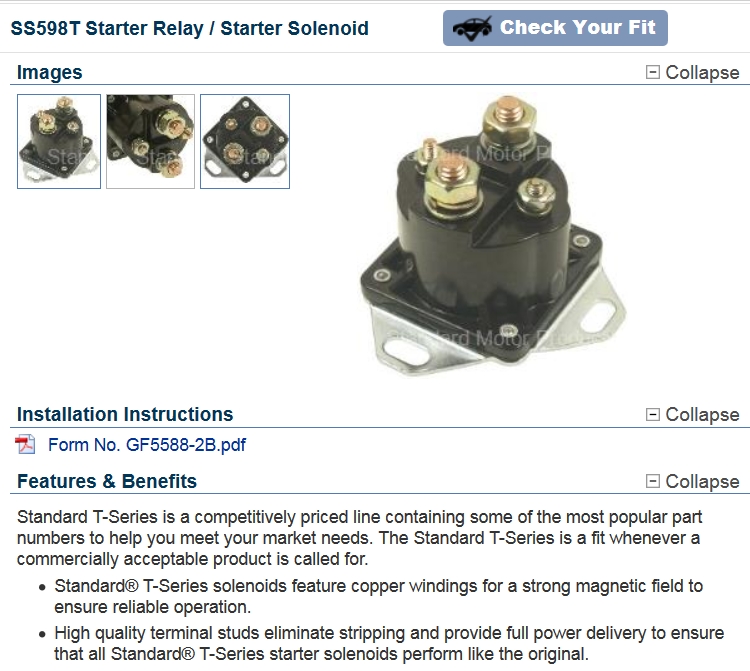

Go to any local parts store and ask for a Standard
SS598 or it's cross-referenced equivalent.

Looking at ebay item 1639535936 it looks very similar, though I gather that on the ebay option one of the two small terminals needs to be routed to ground, instead of to a starter engaged indicator. The seller lists in his compatibility charts that it fits a huge list of ubiquitous vehicles including the F150, Taurus, etc. If there isn't a closer match to the B&C, is there a good reason why this one wouldn't be a good choice to get back in the air safely?
Define 'safely'. There is no such thing
as a safe airplane. Airplanes are dangerous as
hell with all manner of hazard when
limits are not identified and accounted
for with training, planning and skilled
execution.
So your contactor failed. Did that create
a high risk condition? In what circumstance
would a contactor failure in flight represent
a more high risk condition?
If you're wanting to get back the air ASAP,
then hit the local autoparts store. There
are few, if any starter contactors offered
there that cannot be adapted to your needs
with immeasurable difference in levels
of risk.

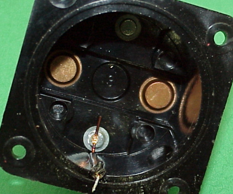

Starter contactor sticking is more likely to be
caused by high resistance in the cranking
and/or cranking control circuitry than for
any reasons of quality/design of the contactor.
The 'ford' style contactor has been around for
decades . . . long enough for manufacturers
to figure out how to do it right. The movable
contact looks rather 'flimsy' and indeed it
is flexible.

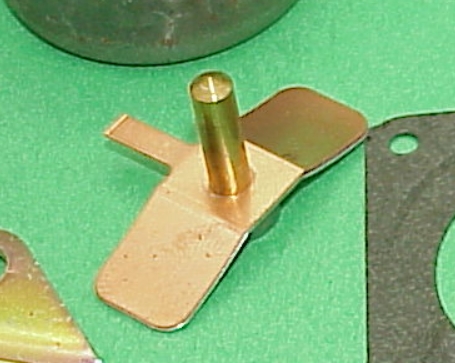

When the 'solenoid' winding is energized,
the movable contact is push up against
the stationary contacts . . .
[img]cid:.1[/img]
. . . hopefully with enough force to 'mash' the
contact surfaces together and develop contact
pressure needed for good connection through the
fat wires.
High resistance in the fat wire circuit and/or
the battery itself can manifest in excessive sag
of bus voltage during the starter's inrush transient . . .
just a few tens of milliseconds. That depression
in voltage reduces the closing forces on the
fat wire contacts and increases contact bounce
while increasing contact resistance. This is the
stuff of welded contacts.
The fact that you had a series of failures suggests
a high resistance scenario in some combination of
battery, fat wires, battery contactor, and starter
control wire. You may have noted that my Z-figures
show 20AWG wire to the starter switch . . . 18AWG
wouldn't be overkill. Has nothing to do with
wire 'overheating' and everything to do with minimizing
losses in the system during those first few milliseconds
after you hit the button.
Any 'stick' on the starter contactor, especially
a low time part is cause for close examination of
causes other than quality of the contactor.
