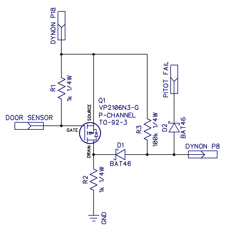

PostPosted: Tue Aug 01, 2017 10:01 pm    Post subject: Re: Do I need a Pull Up resistor? Reply with quote
Bill,
The data sheet confirms what you're seeing at the bench, but this sensor can be made to work. The fix is pretty simple -- you just need to invert the output logic. This can be easily done with a few cheap components.
However, paralleling the inputs to Pin 8 without knowing how the pitot fail signal works is potentially dangerous. It's possible for one input signal to short the other one. The two inputs should be isolated from one another so they can't interact.
See the attached schematic diagram. Resistor R3 provides a weak pull-up on Pin 8, holding it at 5V. When your air door is closed and the sensor output is pulled to ground, P-MOSFET Q1 is turned on, and both sides of Schottky diode D1 (and therefore Pin 8) are at 5V. When the air door opens, the sensor output goes high impedance, allowing resistor R1 to turn Q1 off, in turn allowing R2 to overwhelm R3, pulling Pin 8 to ground through D1. D2 prevents the PITOT FAIL signal from holding Pin 8 at 5V. Likewise, when the PITOT FAIL signal pulls low through D2, D1 prevents Q1 from holding Pin 8 at 5V.
A couple of notes:
1. This circuit will pull ~5mA from your Dynon's Pin 18 at all times. You should check that this is within specifications.
2. Please check that your PITOT FAIL signal puts 5V on Pin 8 (when the pitot is working normally), and not 12V. If it's 12V, then this circuit needs to be changed slightly: R1 and R2 should be 2.7k, and the connection point labeled DYNON P18 should instead be connected to 12V.
If you need help building this circuit, just say the word.
Cheers,
Eric

Hmmm...my plan is to insert the MP200703 into the foam board frame of the
air box (imagine a AA battery inserted into a foam board at a 90 degree) and
then on the fiberglass flapper valve I plan to bond the magnet (encapsulated
in fiberglass) onto the flapper door so that when the flapper door is closed
the aspirin pill shape/ sized magnet will be lying flat on top of the AA
battery with a thin fiberglass sheet in between.
THANKS AGAIN!!!

PostPosted: Fri Aug 11, 2017 7:53 am    Post subject: Do I need a Pull Up resistor? Reply with quote
!!!!!!!! IT WORKS... IT WORKS!!!!
Some POSITIVE FEEDBACK on my ICE annunciator.
I installed the Cherry Reed switch mp200 703 and connect it up the blue wire to ground and the brown wire to the Dynon EMS sensor wire that is shared with the Dynon pitot heater fail sensor wire.
The Dynon pitot heater fail annunciator is such that when the unit fails or is turned off the units sensor wire is grounded and since my new Cherry Reed switch is connected up in the manner that when the alternate air door is opened and therefore has moved the target magnet away it completes the circuit and provides a path to ground.
So now when the alternate air door opens due to ice blockage of the air filter and/or the heater system fails or is turned off I get my fancy blue ice annunciator on the EFIS screen
Conversely when the alternate air door is closed and/or the heater is turned on then I do not have an annunciation on the EFI screen.
As always, I am sincerely grateful for your time and help in this project!

Do you have to connect the pitot sensor and magnetic sensor to the same EMS input?  Is there another input that you can use?
I have used all of the input pins so I thought that it would be cleaver to combine the ice systems into one sensor pin.
Yeah, the data sheet is confusing.  It says "OFF" when the transistor is actually on.  If you ignore the "ON" and "OFF" and just read the rest of the text, it makes sense.  It sounds like the sensor is working properly, a close magnet causes the output to go low.   If you want the signal inverted, another transistor can do it.
I assume that "another transistor" means I need to buy a "another sensor"?
Do you by chance know what the name of the correct unit will be? Regular switches are called Normally Open or Normally Open so what would a Normally Closed sensor be called?
THANKS AGAIN!!!
