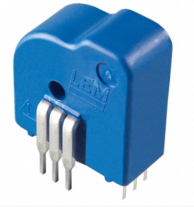

And he wrote that hall effect sensors contain an induction coil. Do they?
Some do . . . the more accurate, 'closed loop' sensors
do feature nulling magnets wound onto the gapped core. The
sensor assembly includes electronics configured
to drive the nulling current such that force in the
gap is maintained at net zero flux.
http://tinyurl.com/yb8rqoo7
This same article speaks to open-loop sensors. While
not as accurate and free of drift they are getting
better. I keeps some around quick-n-dirty look-see
on some unknown current . . . or when I want a really
small sensor mounted right onto a circuit board.
[img]cid:.0[/img]
Here's an open loop device that will convert a 200A
current flow into a +/-2.5v signal.

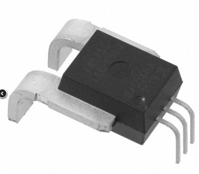

[img]cid:.1[/img]
This little board mounted device is one of my
favorites . . . VERY linear and low temperature
drift.
Bottom line is that they come in both flavors.
The alternator output sensor on the B&C standby alternator
regulator is an open-loop device.
