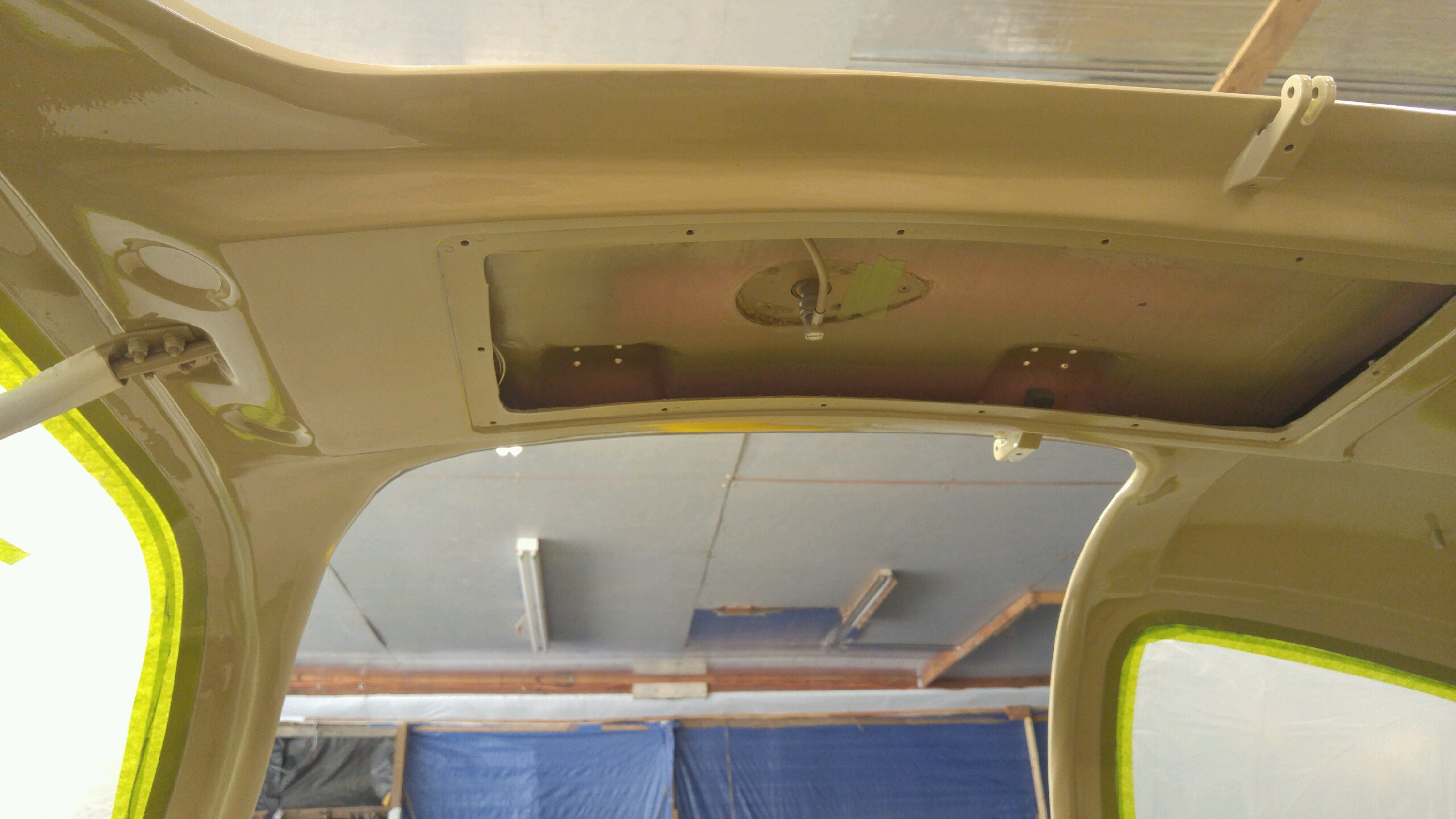

PostPosted: Tue Aug 08, 2017 4:50 am    Post subject: Re: GPS antenna mounting Reply with quote
The antenna is flush with the inside surface, and the TNC is a 90 degree fitting. there is no clearance issue. The antenna and filler consume the void tightly, and a ground plate covers the inside skin cut out.
Antenna cable and wires run up the center post.
Here is a photo prior to the ground/mount plate installation.
Best,
Frank

PostPosted: Tue Aug 08, 2017 5:09 am    Post subject: GPS antenna mounting Reply with quote
Frank,
That's a clever use of what seems like wasted volume, but please consider that the thickness of the cabin top provides a structural function.  Are you taking some measures to reinforce the compromised area, like a cover plate that acts as a doubler, or additional plies below the antenna?  Of course we can do what we want, but it sure seems to me like that mod gives up some crash worthiness.
--Dave
