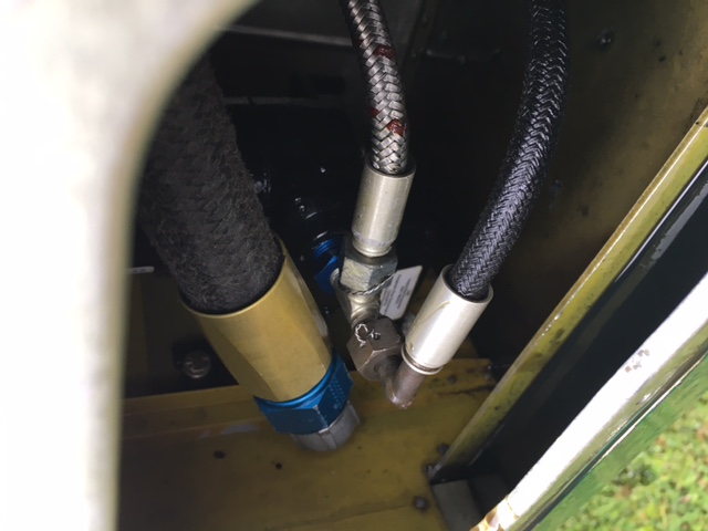

Here is a photo of the failure, after some cleaning. The failure was actually a split in the upper braided hose about 1/2 inch from the connector. It would appear it is not the standard hose. The hose has now been removed.
 Filesize:  77.34 KB

PostPosted: Tue Aug 01, 2017 11:53 am    Post subject: Blown oil hose CJ - connectors? Reply with quote
Jay-dub;
That is an AN standard, Aeroquip #491 fitting assy. on what looks like an
Aeroquip 303 hose but I do not recognize the location as "just aft of the
firewall" in a CJ6.
There should be no oil hose connection in that immediate area at all. Can
you confirm this is the lower RH firewall area of a CJ6.
The MIL H 8794 (303) hose has a layer of steel wire braid below the outer
fabric cover. The failure you have suffered is almost inconceivable
without pre-existing external damage.
Also do not recognize the two small dia. (Chinese or Russian) hose
connectors below the large (-12) hose as a CJ6 assembly. The upper small
dia. hose is similar to an Aeroquip 600 series (probably a Russell
knock-off) and is not compatible with the Chinese/Russian end fitting.
Walt

PostPosted: Wed Aug 02, 2017 9:54 am    Post subject: Re: Blown oil hose CJ - connectors? Reply with quote
Thanks, Walt.
The removed external panel is just aft of the firewall on the lower right side of the forward fuselage. I'm interested in your comments above as we have no immediate means of comparison. If I get chance, I will ask to open the same panel on one of the other two Huosai powered CJs in the UK to see.
For the avoidance of doubt, the hose which failed is the middle one of the three in the picture - the silver coloured one.

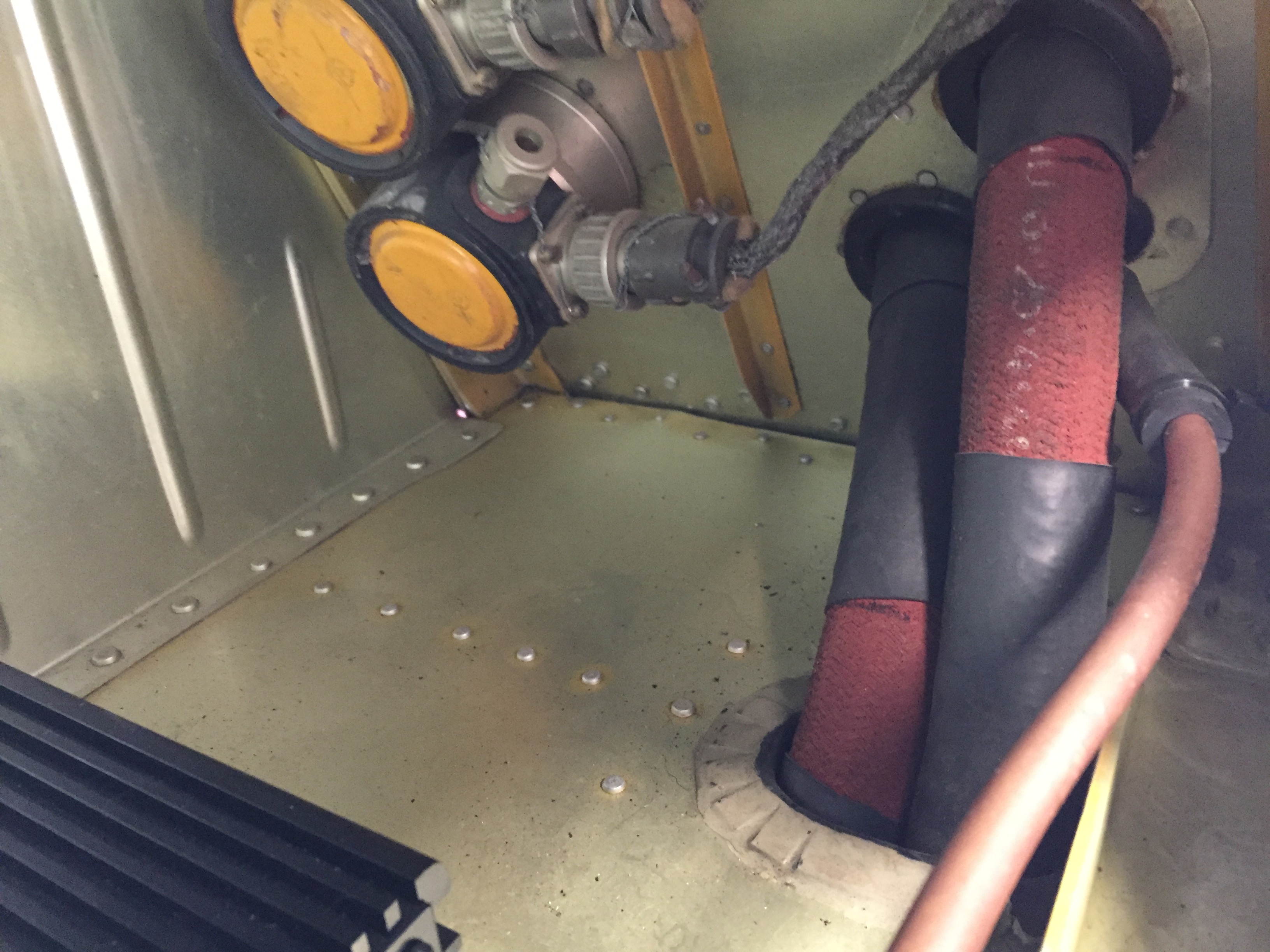

PostPosted: Wed Aug 02, 2017 10:35 am    Post subject: Re: Blown oil hose CJ - connectors? Reply with quote
Jay-Dub, do you oil hoses pass through the firewall with fittings?
On my 85 CJ-6 both oil hoses run through the firewall via grommets without fittings. My oil hose is Chinese so I assume they are original since 1990's when it was exported to the U.S.
I have considered adding fittings as firewall pass through when I replace the oil hose. However, the firewall is only aluminum so any benefit of the fittings may not be realized in case of fire.

PostPosted: Wed Aug 02, 2017 11:06 am    Post subject: Re: Blown oil hose CJ - connectors? Reply with quote
They go through the firewall with grommets.

PostPosted: Wed Aug 02, 2017 11:36 am    Post subject: Re: Blown oil hose CJ - connectors? Reply with quote
So the pic is you posted is taken looking through the STB side fuselage access panel which makes more sense.

Oil hoses running through the firewall, the fitting you see connects to the excellent Craig Payne oil filter bypass system
 Filesize:  1.51 MB
 Viewed:  22695 Time(s)
wlannon(at)shaw.ca
PostPosted: Wed Aug 02, 2017 8:18 pm    Post subject: Blown oil hose CJ - connectors? Reply with quote
Jay-dub;
Attaching a photo taken inside the RH lower, forward, fuselage panel
(approx. 5" X 7") just aft of the firewall and above the floor. The LH
side has an identical panel in the same location. The two oil hoses you see
(though new a few years ago) are exactly as original. They are approx. 6
ft. long and join the oil cooler hoses in the area of an access panel under
the RH fwd. wing LE/fuselage fairing.
All you see in the photo is stock, with the exception of my 24/12 voltage
converter at the bottom. In the upper LH corner is the fuel pressure
transmitters the hose connector for which attaches on the fwd. side of the
firewall.
In the lower RH corner of the photo there is a heavy metal section which is
the inboard side of the RH lower longeron. This is a wide, "U" shaped
structure (one of four) which carries the major fuselage loads.
In viewing your photo the longeron is also visible (full of oil) but is
located in the LH lower corner of the image. If the photo as taken aft to
fwd as the firewall image appears to suggest I am really confused.
Mine is a 1965 version and at least to the late 1970's this area is
unchanged. Maybe not true of later models?
Cheers;
Walt

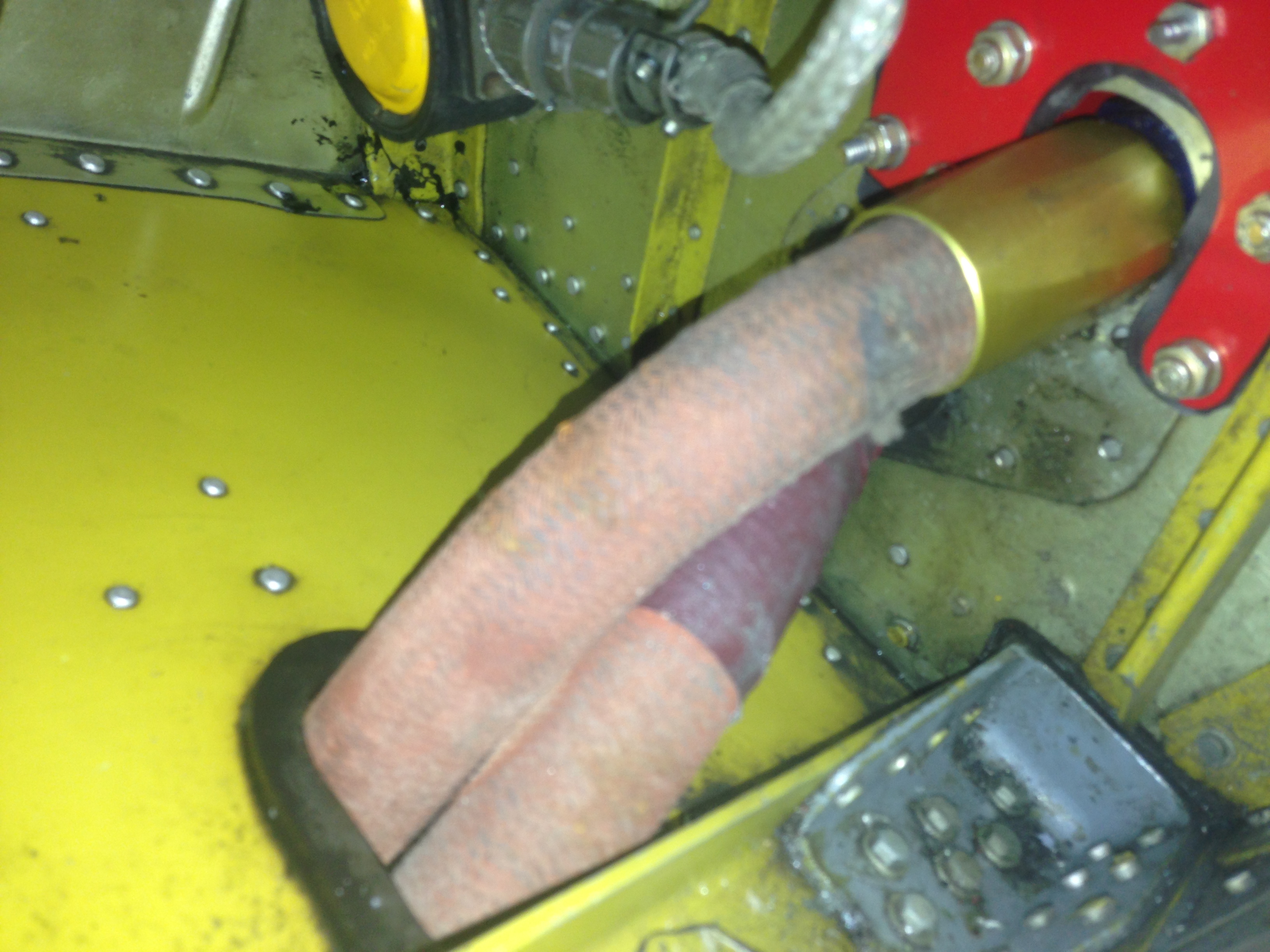

jay-dub
Joined: 31 May 2014
Posts: 99
Location: UK
PostPosted: Thu Aug 03, 2017 2:18 am    Post subject: Re: Blown oil hose CJ - connectors? Reply with quote
I'm with my aircraft tonight so will take a picture for you.
The only possibly explanation I can think right now is someone has done a very nasty modification with the engine oil feed line to the cooler buy adding a fitting and running two smaller hoses (possibly for ease of replacement??) rather than obtain a new Chinese hose.
It has certainly doubled the failure mode (as you have found out) and I'm quite surprised whoever maintains your AC hasn't insisted this was removed (that's just my 2pence worth) in the normal course of performing the 3 year periodical hose pressure test Shocked but that assumes they "know" these aircraft.
As you know, there's not a great deal of CJ experience in Europe. I'm very keen to have it torn apart totally and a ground up IRAN rebuild but not sure whether that's viable ultimately. As to converting it back to the correct specification, not even sure I'd know where to start....
Edit: Just noticed the picture I posted has rotated itself through 90 degrees, which probably explains the confusion.
