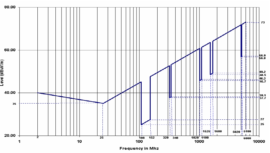

[img]cid:.0[/img]
A fairly recent edition of DO160 offers these testing
limits for radiated emissions. Note those 'notches' in
the allowable emissions plot. They are centered over specific
ranges of spectrum where RECEIVERS of itty-bitty signals
would like to have a clear shot at detecting the information
on those frequencies.
Note the notches cover vhf nav/comm, uhf nav/comm, transponder/
tcas and gps bands. Not sure what service is being protected
up round 5 ghz . . .

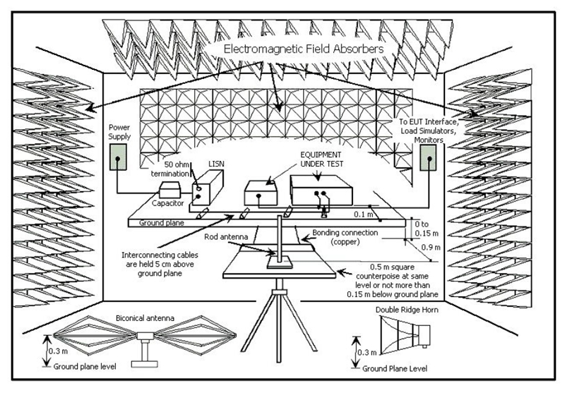

The energy levels allowed are the sum total of energies
radiated from all components of a device and associated
cables when laid out on a copper-top table like so.
[img]cid:.1[/img]
All this is fine and dandy for potential antagonists
that are NOT designed to radiate buckets of energy on purpose
. . . i.e. transmitters. Tests for bkackbox/harness radiation are
generally no big deal . . . I've never failed one.
Then there are transmitters. By nature, they're intended to
radiate signal levels on the order of 130 dBuv/m at 3 meters
from an antenna. Given that 'extraneous' emission limits
at GPS frequencies are on the order of 85 dBuv/m LOWER, this
means that the 13th harmonic (121 mHz x13 = GPS) power has to
be on the order of 1 times 10^-8 lower than the fundamental.
Modern designs have no problem achieving this goal but
there's a goodly number of legacy comm equipment that
was designed and qualified before GPS became the backbone
of aerial navigation.
