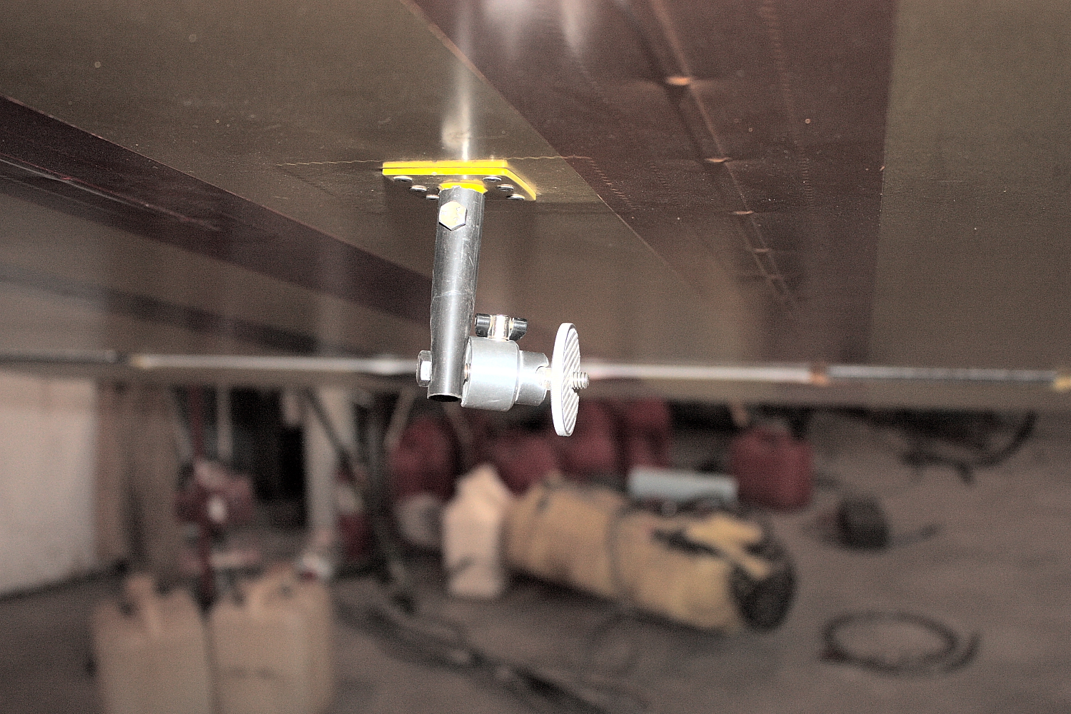

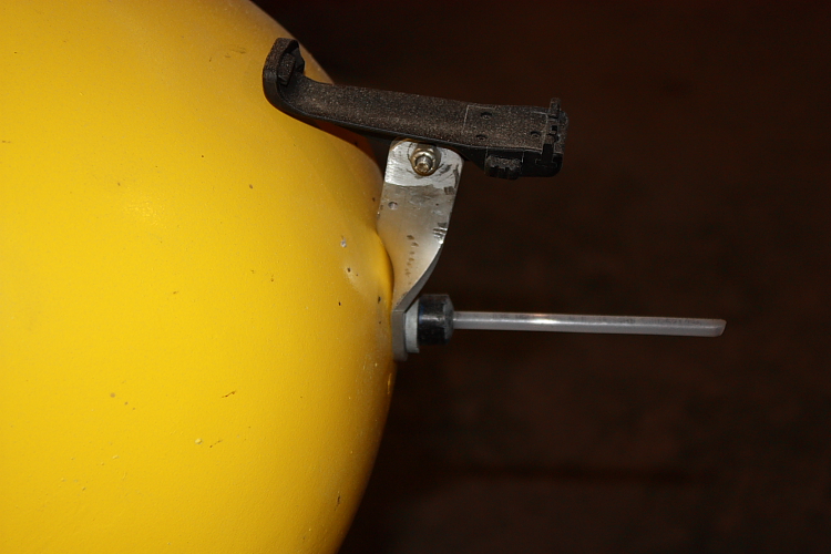

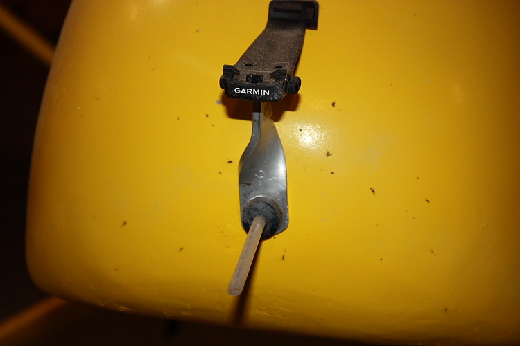

This is where mine is located. I have tried every where else and this is the only place on my plane that gives me a decent video.
I have a pitot tube right through the front of the pod. I think I got it from LEAF and the original attraction is that the pitot tube can be removed. I had one bent at a airshow. By someones spoiled kid of course, so I got this one. The shorter you can keep the connections and extensions the firmer the mount.
The other spot would be on the fold hard point on the wing. You can record right side up or upside down in the settings, just no in between.
The mount is set up for a drift camera now, you would have to secure the cradle rather than the screw in. If you are fond of selfies the wing would be the way to go. Smile

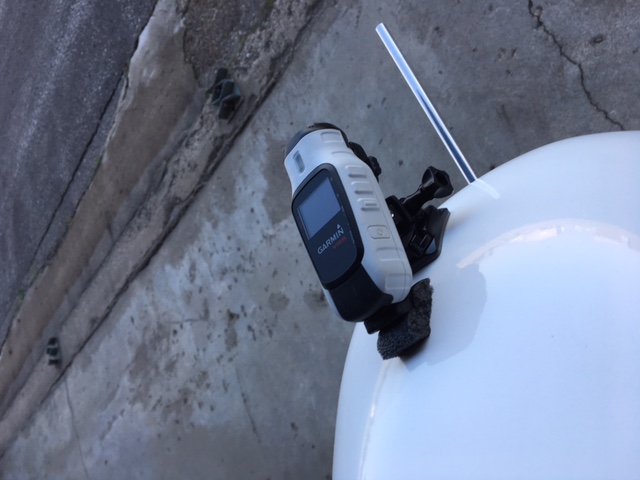

Well, I tried this mount today. I'll see how it worked as soon as the video finishes downloading?[img]cid:934AB4EB-68A3-47D0-AA1B-C58FE8B82E87[/img]

Well Larry this setup seems to help the jitters some. I think a lot of problems are related to harmonic vibrations caused by running a two blade prop. When changing power settings.
I'm going to try a wing mount next. I may try reinforcing under the nose pod where the camera sits too. Thanks for your help, George
