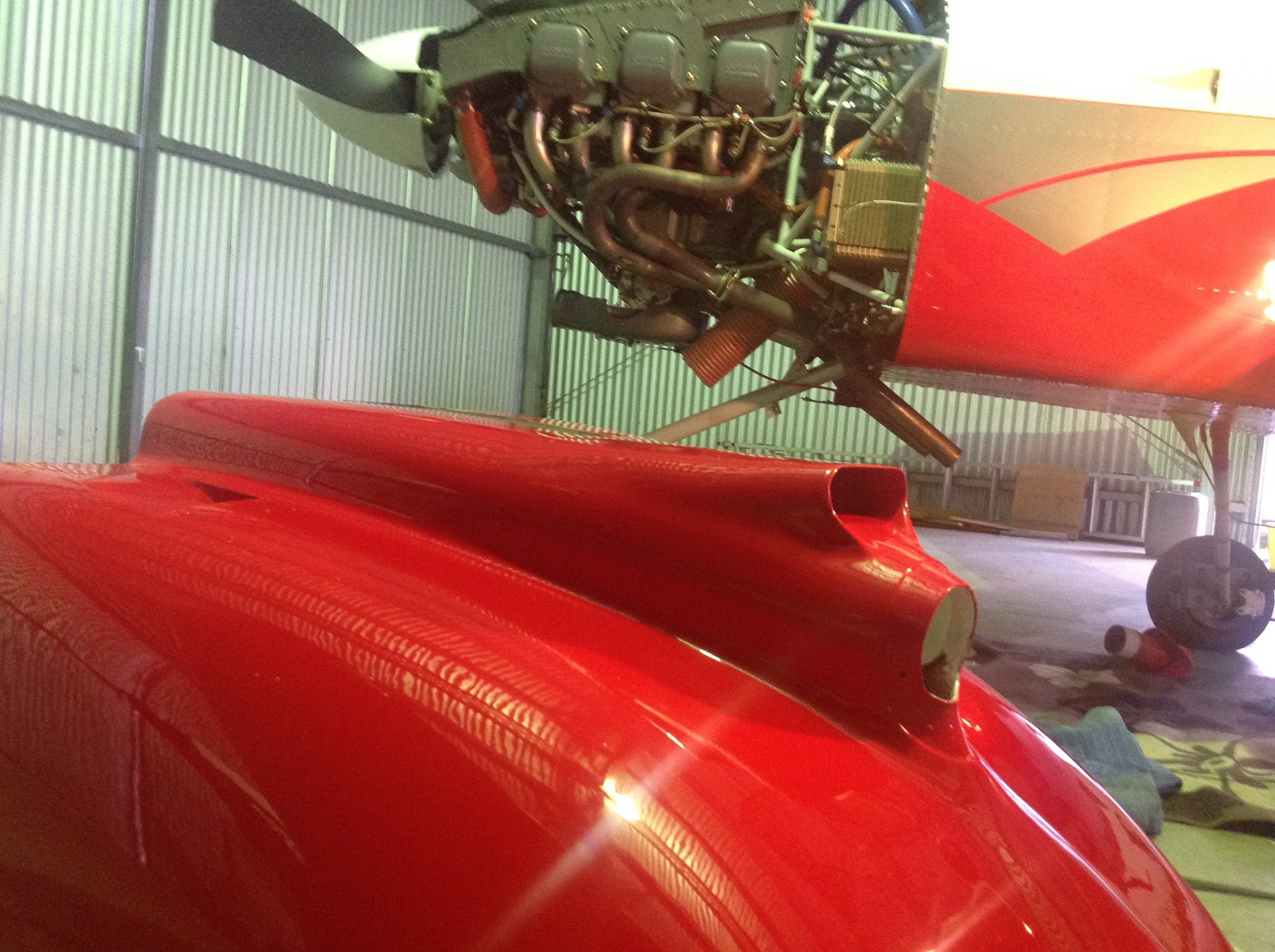

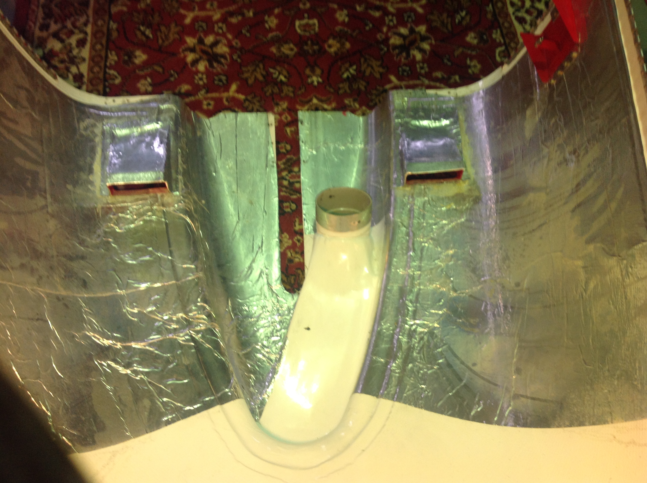

PostPosted: Sat Jun 24, 2017 4:03 am    Post subject: Re: Removing cylinder head flashing Reply with quote
I was concerned about high CHT & Oil temps in local RV10s here so I was very lucky to get some details from Deems about his mod when I was fitting my engine, I took his idea a bit further and I'm pleased to say that it has worked out extremely well. I can keep CHT under 350 and oil at 180. (we have mid 30 to 40*C conditions at times) As the pics show I added an intake for the oil cooler to the bottom cowl, a manifold then takes the air to the left of the front wheel slot (1/2" below the fab) and then via a 4" scat to the vertically mounted standard oil filter. Air is regulated by a push/pull butterfly valve at the oil cooler (Not visible) and exhausts out of the oil cooler couple inches from the side of the cowl. No air is bled off the top of the engine so all is available for CHT cooling. CHTs are even on all cylinders. I didn't fit the flimsy louvres or cowl flaps but installed letterbox vents on both sides. I did fit a "cowl flap" on the side of the cowl next to the oil cooler because I didn't know if the air flow through the cooler would be enough, but this hasn't been needed so I've now permently fixed it shut. One downside to the mod is that the scat hose must be removed before taking the bottom cowl off, not a big deal, the scat is a push fit into the manifold and is secured by hand with a -3 bolt into a nut plate. Anyway, not really about CHT flashing but related to the cooling discussion. Cheers from Western Australia
 Filesize:  1.64 MB
 Viewed:  15737 Time(s)
 Filesize:  1.35 MB
