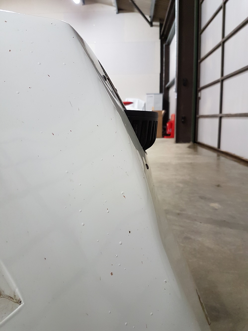

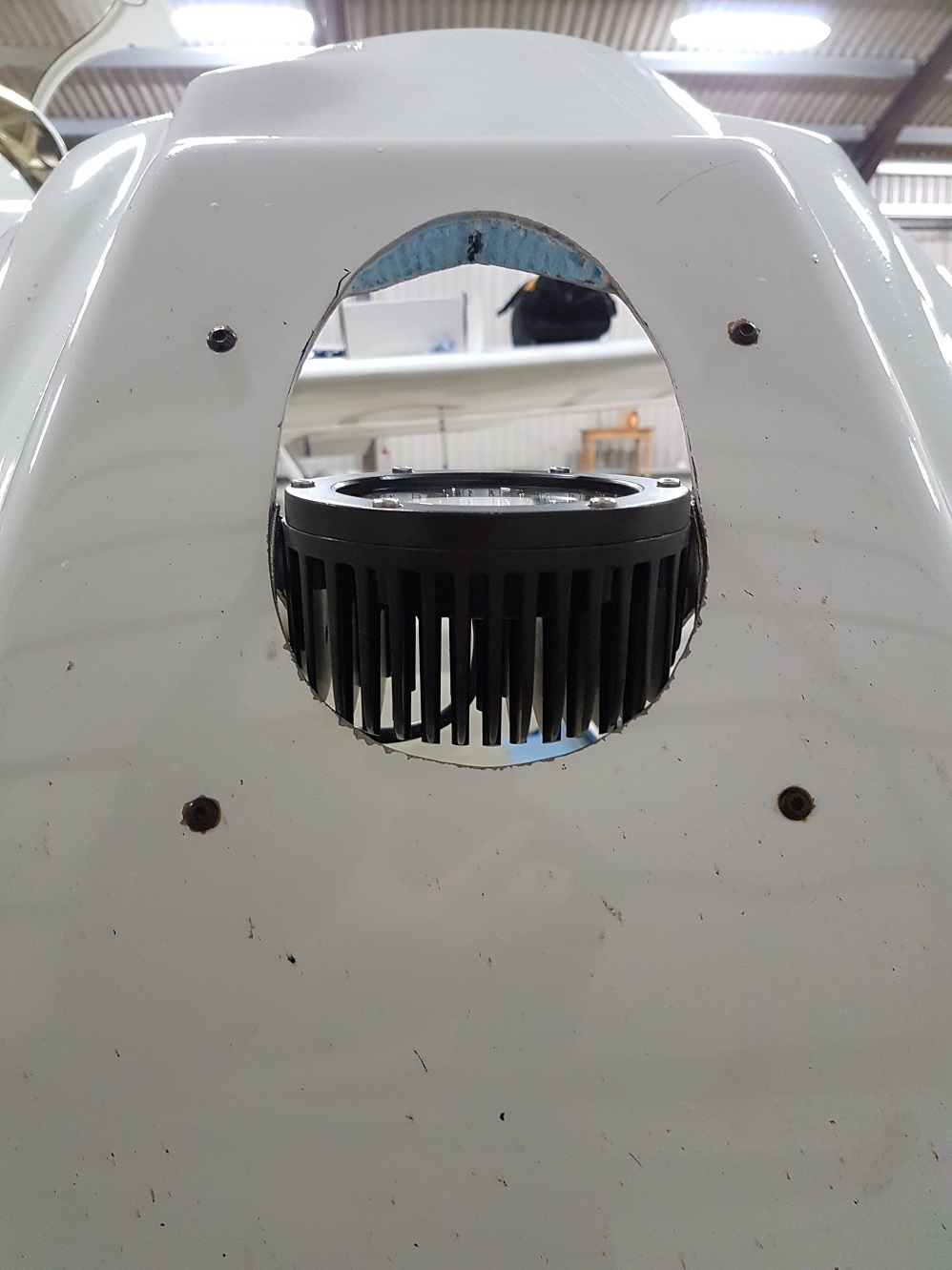

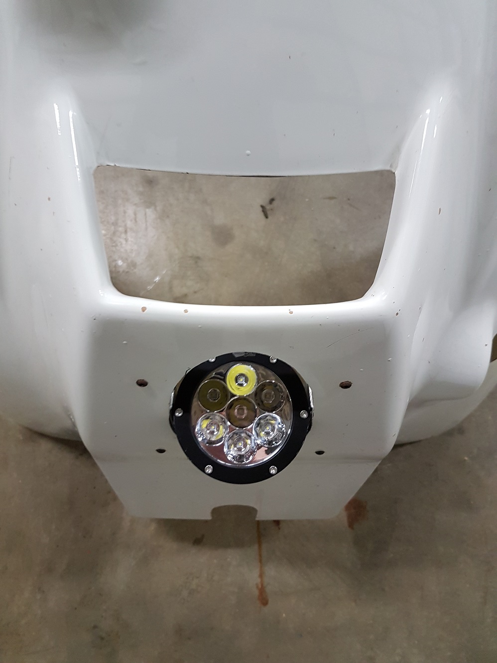

Hi,
I've just fitted a powerful 3480 lumen LED landing light to the cowl of my Europa (G-URMS). It's powerful enough to light-up an unlit runway at dusk/night. It is very similar to the expensive LED lights available from the various aircraft parts suppliers, but it's designed for cars/trucks, so it's much, much cheaper. I bought it from Australia and with shipping it came to about £80. It has been inspected and approved by the LAA. The LAA mod number is 14394.
I can send you pictures if required.
Carl
P.S I've attached some pictures and the doc describing the fitting.

The installation looks interesting but raises a few questions about efficiency of cooling air flow. Is there a moulded cover on the inside? Does it reduce the cruise speed (a Go-Pro sized camera on mine reduces the cruise by a noticeable amount).
Did the LAA approve the Mod without any supporting stress calcs?
My scheme does not involve making a sizable hole in the cowling - just a 1/2 dia hole for the cables, sealed with silicon. The light and moulded support sit around 2.5in max off the OML.
John Wighton
Europa XS trigear G-IPOD
carlp101
Joined: 07 Mar 2016
Posts: 120
PostPosted: Thu Jun 29, 2017 4:57 am    Post subject: Re: Landing Light Positioning Reply with quote
Hi John,
Good questions.
The body of the light is designed as a heat sink and as such has channels through it for the air to pass through. These are aligned with the flow of air into the cowl, providing minimal reduction in flow.
I can't say I have noticed a reduction in the cruise speed. I'm burning about 15 liters per hour at 110 kts.
The LAA didn't require any stress calculations as this is not a load bearing part of the cowl, and the metal bracket helps reinforce the area in any case. The mod number is 14394.
