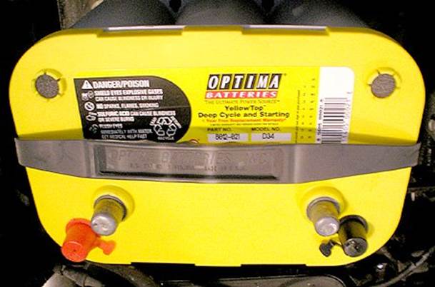

So…I left my battery charger connected to an Optima battery overnight on the 10 Amp charge position. In the immortal words of Homer Simpson “!!!DOH!!!”
The Optima battery can be installed in any position other than upside down and my battery was installed on its side. Well in the morning, I noticed that clear liquid was leaking out of the two small gray ports so I assume that these ports are some kind of vent to release the internal pressure in the instance where some DumbBass left the charger plugged in all night and the battery overheated.
I felt the battery was not hot nor even warm however the liquid was definitely dripping out a fair amount.
I thought that these things were supposed to be “spill proof” because they are “gel filled”. In the past I noticed that when in the battery charger is in the 10 amp position the battery charger only puts out a voltage of about 13.0 volts so I would not have thought that it could cook a battery.
How can one (me) determine if the fluid/gel level of an Optima battery is still adequate? I can weigh it and/or I can get it tested at the auto parts store?

The 13.0 volt observation seems valid . . . and certainly
not enough snort to cook an SVLA battery. Yet, here we are.
I would do a cranking load test on it first. Go to a battery store
and have them load it DOWN and HOLD at 9 volts for 15 seconds. At the
end of 15 seconds, note the current. A new battery of that genre would
probably dump 400-600A. This test will normally consume less than
10% of a battery's snort. Follow up with a cap check. Hook a 55W head
lamp to the battery and see how long it runs before the voltage drops
below 11.0 volts. Again, for a battery of that ilk, 8 to 10 hours
is healthy.
After the first test, put it on a known-good charger/maintainer
and repeat the test.
Now, even if it still performs electrically, I wouldn't
recommend using it for anything other than ground ops.
It's obviously compromised.

Yet, here we are.
Yup…THANKS Bob for the words of encouragement.
I betcha if I would have had the battery sitting straight up that the “gel” would not have leaked out.
Maybe . . . but I've been getting search hits on
Optima leaks that do not correlate with laying
the battery down.
Optima may well be suffering from acquisition creep
and often profound if not terminal degradation of value
for a product or service.

In any case, leaking from the Optima products is
mystifying and surprising. I'll see if I can
find out more about it. In the mean time, it's
sure bet that your existing battery is not
flight worthy. Why did you choose so hefty a
battery?
