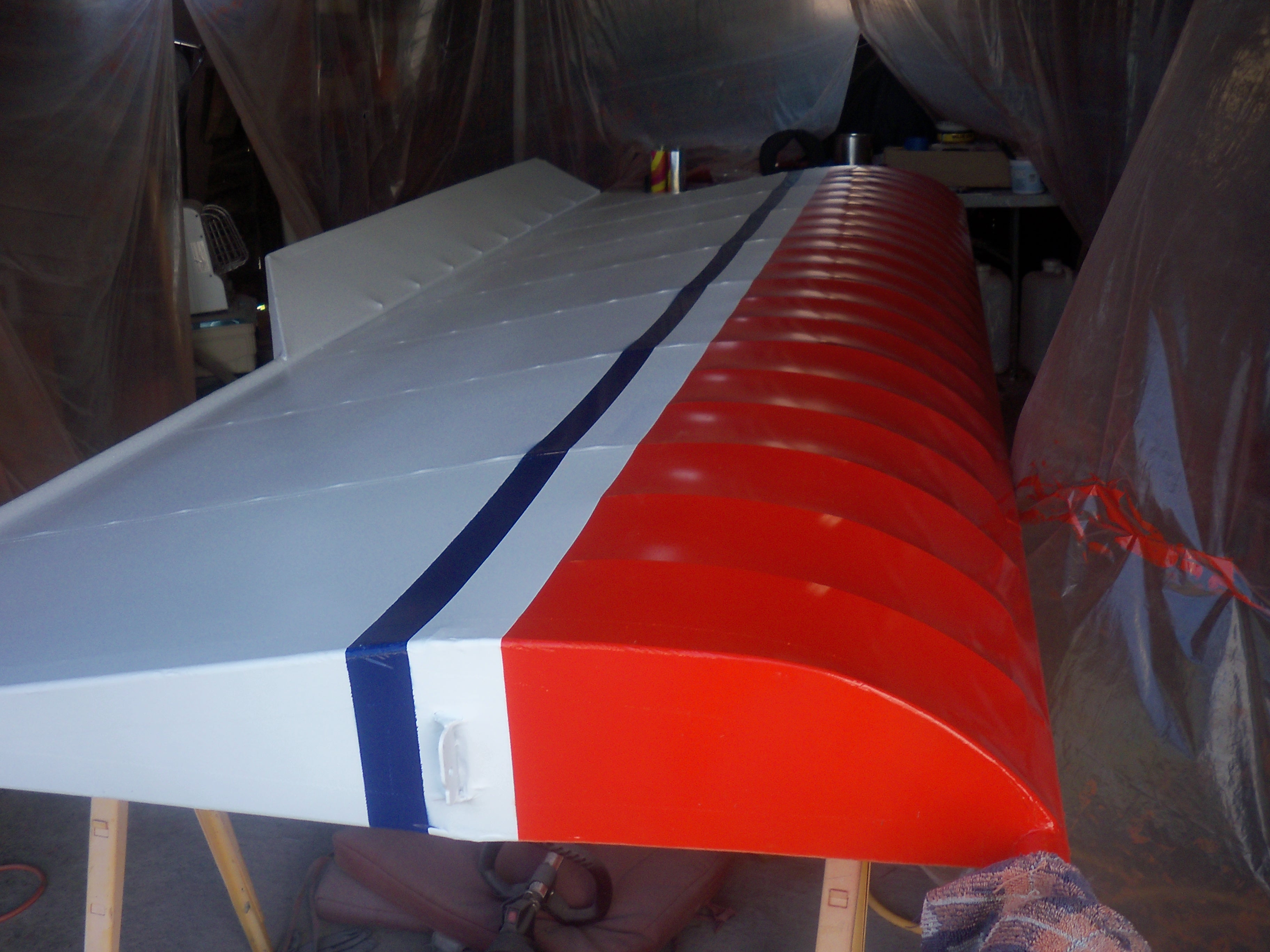

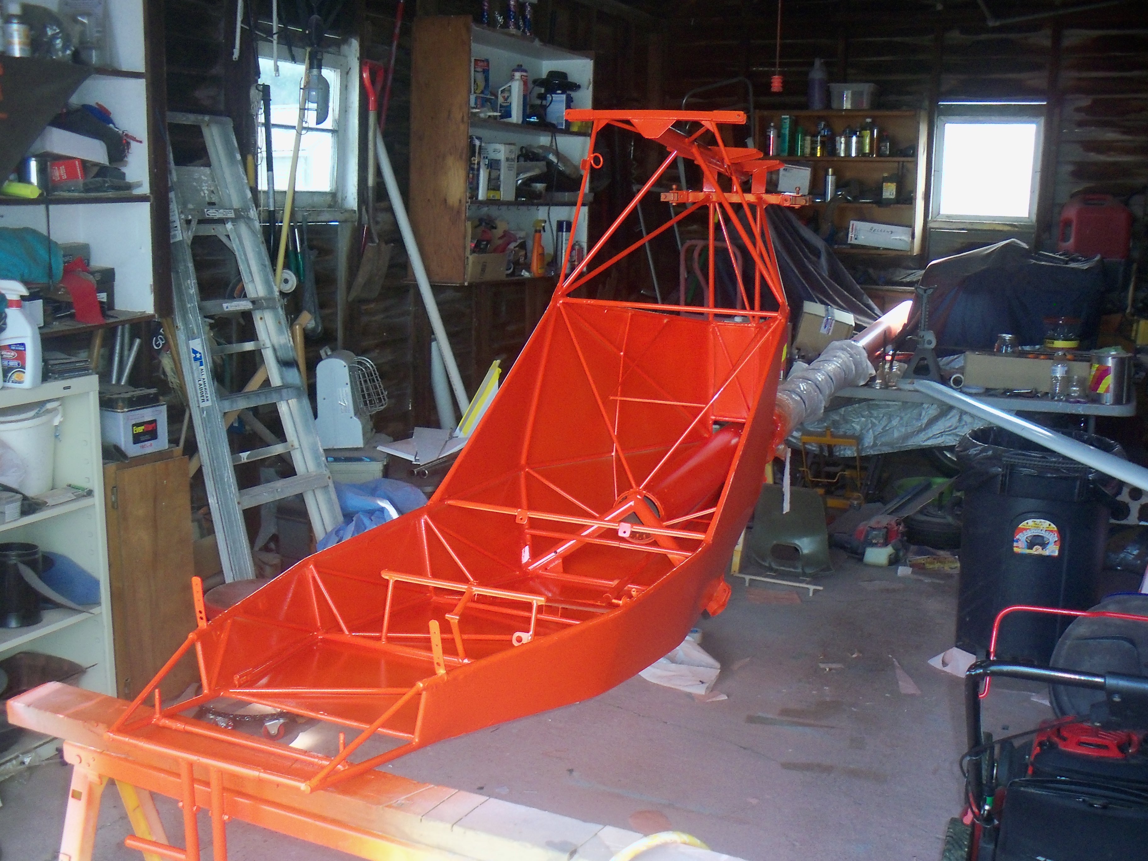

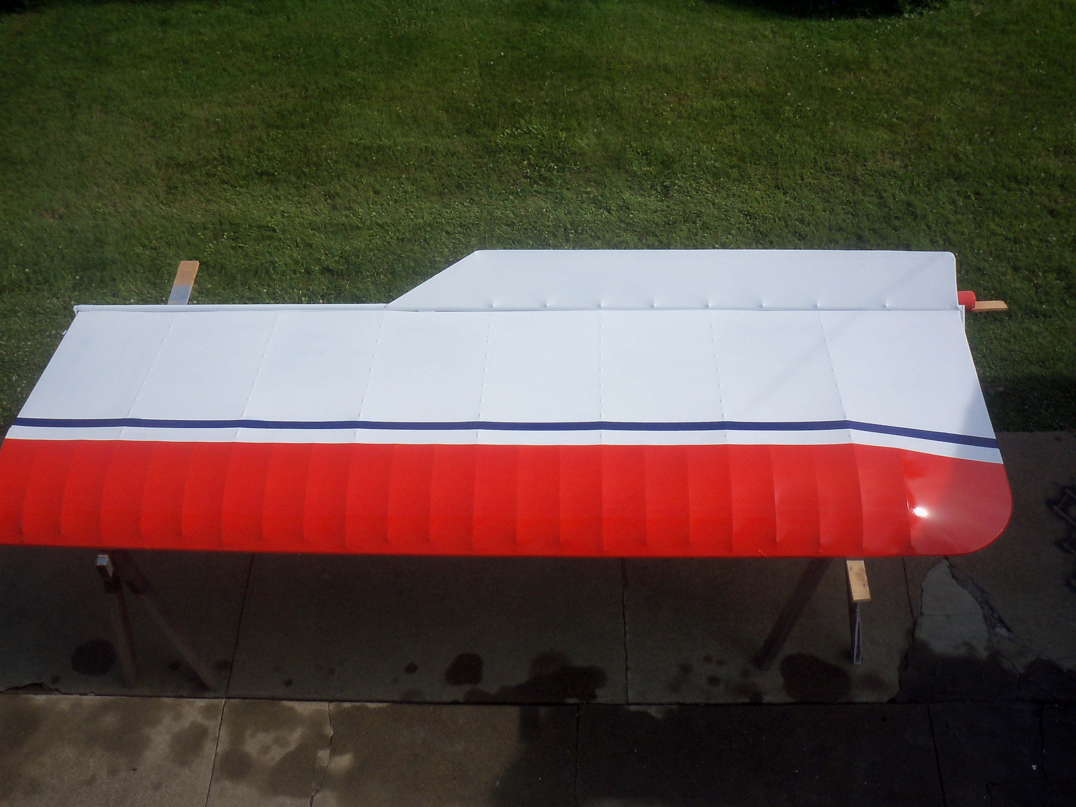

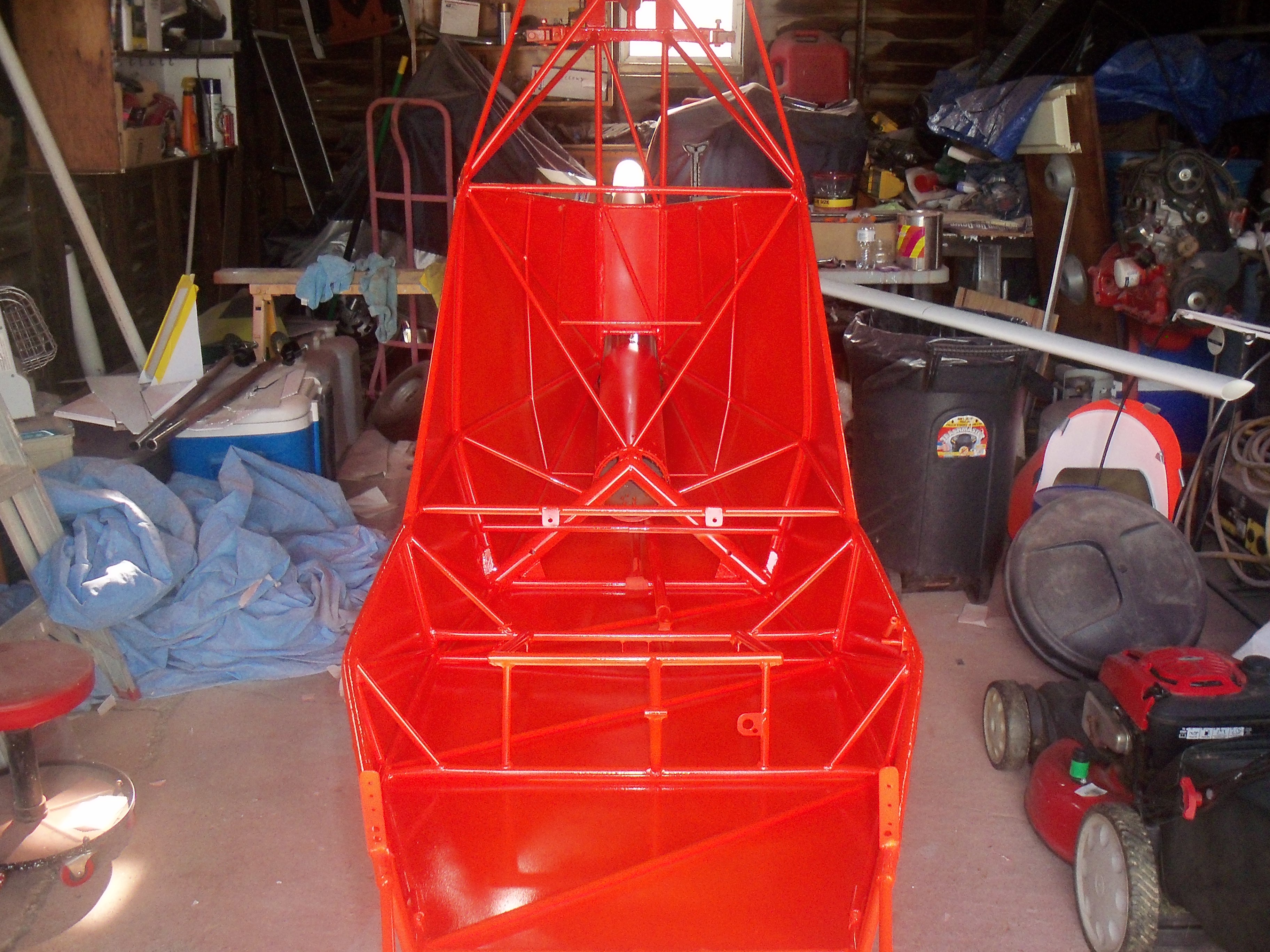

Since the list is dead and since I am slowly making progress on the project that I purchased from Rev. Pike back in December, I thought I would post some of the progress. I have rebuilt the wings and fuselage and now have them under paint. I fabricated a set of 4130 gear legs and tundra tires. I am in the process of fabricating a more comfortable seat similar to the one Richard has. I am trying to decide which way to go on the windshield, short or full. I will be installing hydraulic brakes and a trim system. Wings are set at 3* dyhedral and I have a set of fairings for the struts and the gear legs.
Progress is slow but I'm having a blast. Richard gave me a lot of tips on building this thing that has really been great. Also, I picked up a chute from Ted in Bama and also a lot of building tips. Trying to decide on the instruments, EIS or analog. Don't know the advantages of either except for the warning light.

My only comment would concern the wind screen. If you get too short on
the screen and do not wear a helmet. The wind will hit you somewhere
around the chin and if it is a bit cool then you will have problems
with snot getting on your glasses. The streaks tend to distort your
vision a bit. Roger Hankins met me at a place called Paisley in
Eastern Oregon. He had always flown by himself and didn't need or use
a radio, so he had always worn a Motorcycle helmet. I insisted on a
radio, so to counteract the wind effect he had to resort to breaking
the connecting line to some ear plugs and stuffing the plugs up his
nose. I thought he looked quite dashing in his little plane with two
blue strings hanging out of his nose.
The short screen will cost you on speed however. Some where in the
area of 5-7 MPH.
Just an observation
Larry

Looks good!

I would go full. Had a short and put on a full. A good 5 to 7  faster. Better mileage. Only down side is photography.

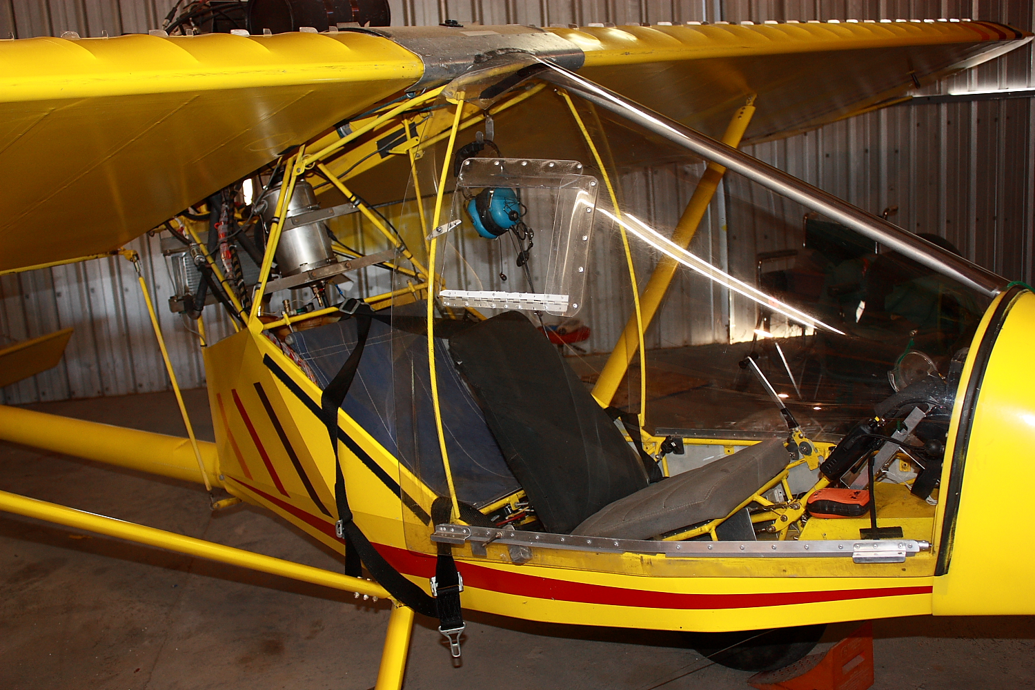

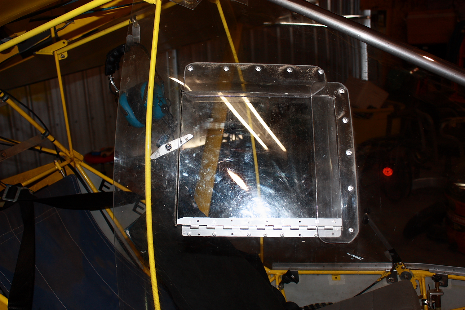

Try this solution. The only thing is, that I made it with the plane
sitting flat. So when it is in flying attitude, the window is a bit
tilted. Just decide whether you want the angle to be aligned when
sitting or flying.
