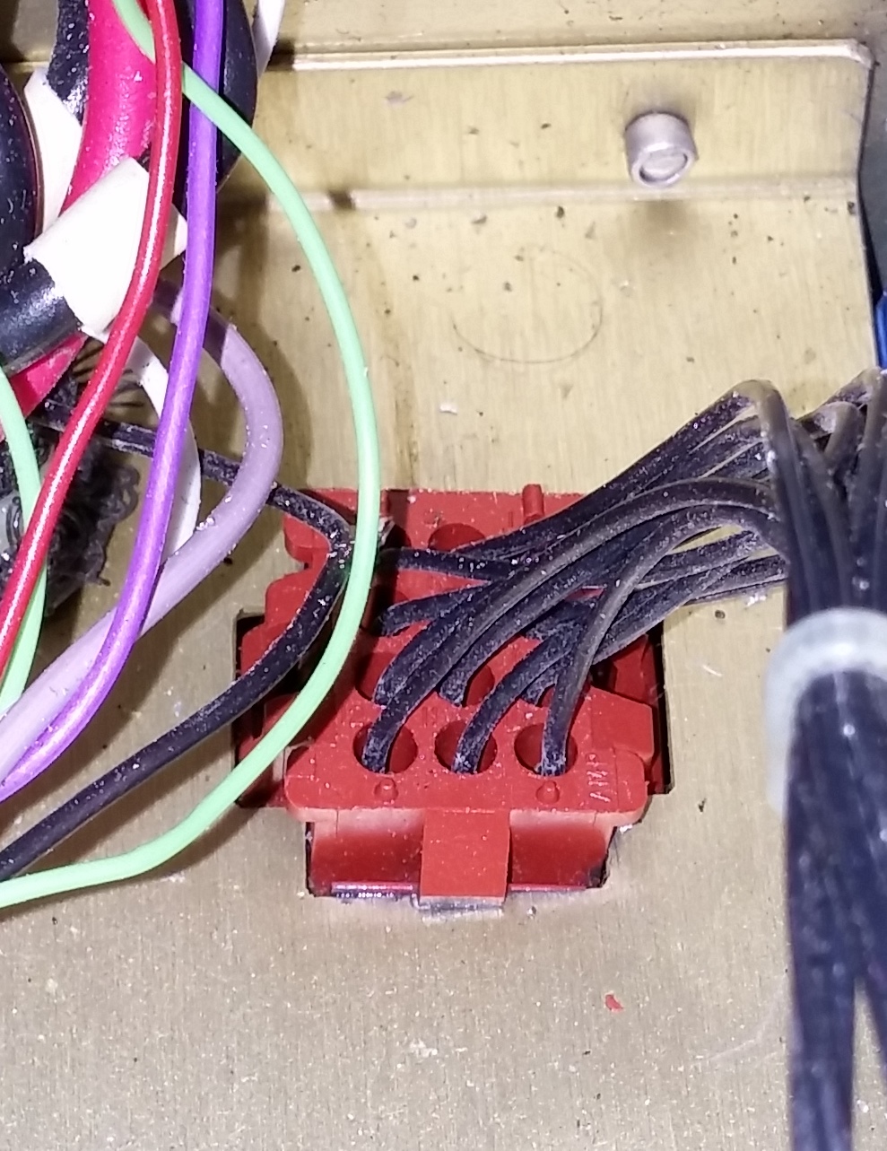

Hi All,
I need to rearrange the wires on this AMP 12 pin connector and my hope is to simply pop out the terminal ends and leave the wires still connected and just move them to the proper pin locations and pop them back in (I might have to re-bend the metal retainer tabs).
The questions are:
Does anyone know what terminal connector this is?
How does one (me) unseat the terminal ends from the connector and what tool should be used?
THANKS!!!
Bill Hunter

Bill Hunter On Jun 21, 2017 11:21 AM, "Robert L. Nuckolls, III" <nuckolls.bob(at)aeroelectric.com (nuckolls.bob(at)aeroelectric.com)> wrote: | Quote: |
It would really help to see the other
side of the connector.
I 'think' this is the tool you'll need
or one very similar. exact p/n to be
determined.

The photo is of an AMP Mate'n'lock connector. There are three or four sizes of Mate'n'lock connectors based on pin size (diameter).
The contact removal tool is a sleeve and plunger tool. The sleeve compresses the retainer tangs into flush with the contact body and the plunger pushes them out of the housing.

That is exactly it. THANK YOU SO MUCH for the help.
