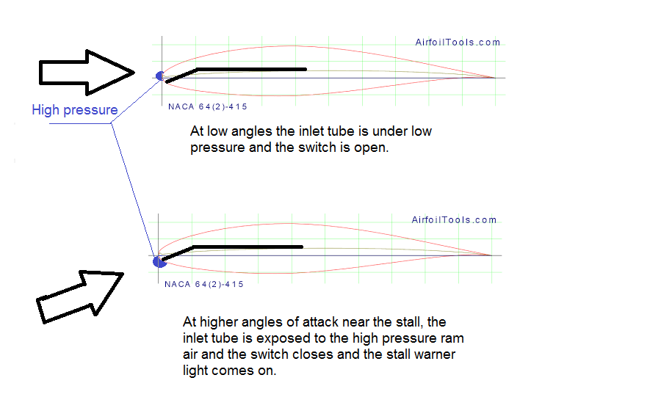

I haven’t had much of a problem with the stall warner switch itself, but now days, I put the switch in the wing and run wires to the panel and place the light near the airspeed indicator and the buzzer, if wanted, on the underside of the panel top so it will resonate. The switch is adjustable from the aileron belcrank access door with a Phillips head.
I had problems in some installations running a long tube from the wing to the cockpit as the Europa Mod installation states, and getting the accuracy I expected even with tight connections. I moved the sensor to the wing and it was fine. Go figure. The tubing is quite firm and doesn’t expand so I couldn’t figure it out and it wasn’t worth the time.
At 7.5 mbar or 3 inches of water(about 45 Knots IAS) pressure it is pretty easy to check on the ground. Check your wiring first. Bypass the switch and check the light/buzzer. Push 3 inches of water pressure to the inlet tube and or the sensor in the fuselage (using a manometer) and check the switch operation. If it checks on the ground it should work in the air. Your Ops check for your periodic inspections is: Light should be on when stopped, stay on until about 50-55 on takeoff. Come on about 3 Gs at Vman or maneuvering speed or 5-10 knots above the straight ahead stall of course... Since the wing stalls near 17 degrees, and the inlet tube is pretty close to that, you should be getting full pressure in the tube and if the switch ground checks, it all should work.

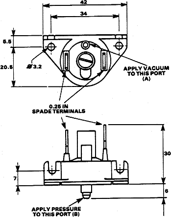

RS 317-443 and Herga 6753 are identical switches.  Honeywell has switches but are not adjustable so are worthless.
China has a manufacturer:   Antunes controls. Their SMD series is in the range.   Big and heavy and is plus or minus .5 inches water, so not terribly accurate.
8021203090
0.17" to 6" W.C.
Yes

Now I am really confused. I have fitted the Europa stall warning mod and switch but not yet used in anger.
How is this switch designed to work?
Is it normally closed and held open by pressure above a certain speed.
Or is it normally open and is closed by low pressure (vacuum), like a conventional Cessna stall warner, caused by the angle of the wing.
The mod leaflet suggests it is operated by vacuum, but your description of it being on until above a certain speed suggests the first option.
The switch has a hose connection to both sides of what I assume is a diaphragm, so it is easy to connect incorrectly.
If it is normally closed then does that result in the buzzer operating continually on the ground until above the stall speed?
I think that would eventually get to be a bit of a pain, especially during long holds on the ground.

It's normally open, and activated when sufficient vacuum is applied.
Roddy kesterton g-ikrk

If you go onto the Radio Spares web page and search. Pt No. 317-443 there is a full tech description.

PostPosted: Wed Jun 28, 2017 6:23 pm    Post subject: Stall Warner - switch problems Reply with quote
Kelvin,
The switch is a pressure switch. With the relative wind nearly straight on the air into the tube is under suction. The switch is assembled to the hose to the leading edge using its pressure side. The switch is normally open so with suction on the tube, the light is off at low angles.
At about 14 degrees angle of attack the switch is now under pressure from the ram air. The switch is normally open and at about 3 inches of water ish, the switch will close and allow current to flow to the light/horn.
Once you land, and the speed diminishes, the pressure drops and the switch opens and the horn goes off.
Not rocket science.
See photo below:
Bud Yerly[img]cid:image001.png(at)01D2F05D.21C06F50[/img]

IanCook_1(at)hotmail.com
PostPosted: Thu Jun 29, 2017 1:40 am    Post subject: Stall Warner - switch problems Reply with quote
Bud,
  Not very often I disagree with you, but the stall warning switch does not work as you describe. Under normal flight the switch senses +VE pressure (connecting an ASI up to the stall system) both the A/C normal ASI and stall warning see almost the same pressure and read the same value. As the angle of attack increases the air separation transition point (-VE pressure moves down the leading edge) and it is this suction that operates the switch as the stall is approached. With the trial ASI still connected, at this point it reads zero or below with the ASI pointer on the stop. Next test flight will be conducted with a +VE and -VE 5” water gauge connected to the stall system to measure the actual +VE and -VE pressures. This work is being done as part of the Permit work for the UK MG test flight programme as the LAA are insisting on a stall warning system on the motor glider. On trying to use the standard EUROPA XS system we are having trouble getting the switch to work consistently. Note: the wing LE profile of the MG is different to the XS and the stall speed is much lower at 42 KIAS at max 1370 lbs lower with the airbrake just cracked open. On my machine, the stall is very benign with very little airframe buffet.

PostPosted: Thu Jun 29, 2017 11:47 am    Post subject: Re: Stall Warner - switch problems Reply with quote
Hi Bud
I think I might have to go with Ian on this one.
The Europa Mod 61 leaflet does state:
Inside the fuselage an adjustable vacuum switch, triggered by reduced pressure in the line
It also describes connecting the hose to the same side of the switch as the terminals.
Looking at the tech details on the switch, this is side A and should have vacuum applied to operate the switch.

PostPosted: Sat Jul 01, 2017 9:44 am    Post subject: Stall Warner - switch problems Reply with quote
A thousand apologies. Writing late at night to get a quick answer is not good .
It is a vacuum hookup in the Europa Mod 61, and normally open. Once you go past the angle, you get suction and the interior wing is positive pressure so the switch closes. It is pretty clear in the mod61 , I should have read it while awake eh!
Under ram pressure or no movement it is open. Once the relative wind point exceeds the angle of the tube it goes to suction prior to the stall.
Very sensitive to adjustment still. The cockpit hookup and setting it in the copilots lap does work well provided the connections are very tight. I just got into the habit of hooking it up in the wing as wires are quick and easy to hook up with a multi connector as my customers normally have lights and such in their wings. But vacuum lines or pitot-static lines are just as easy to hook up with the right connectors. The switch will need a service loop for the adjustment tinkering in the cockpit is all. Clean up after install in the fuselage.
Sorry if I added confusion.
