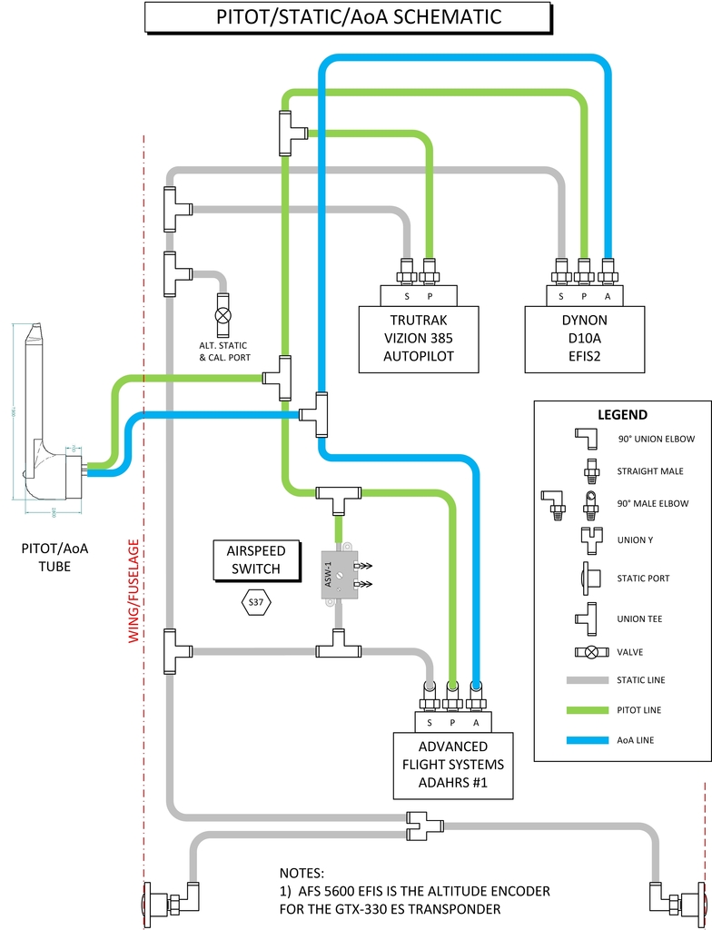

PostPosted: Mon Jun 05, 2017 10:35 am    Post subject: Pitot and static lines Reply with quote
FWIW most builders use:
White - Static
Green - Pitot
Blue - AOA
As seen in the attached drawing.  I did the same.
