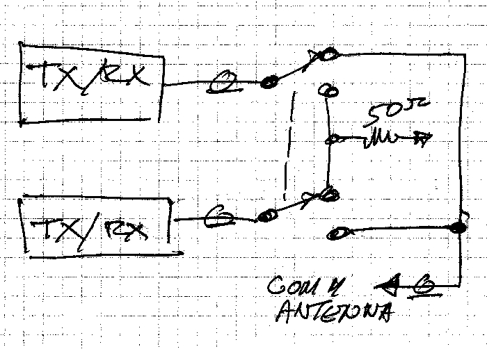

The 'power splitter' is used to let two small
signal devices to share the same source/load.
They are used with two receivers and in some
bench test situations. As others have pointed
out, it is not suited to the proposed task.
I once proposed a panel mounted dpdt toggle
switch and dummy load that would transfer
a single antenna between two transceivers
while presenting a proper load to the transceiver
not in service.
[img]cid:.0[/img]
The switch can be a miniature toggle.
Coax to the hand/held can be routed
of the switch to a bnc jack on the
panel . . .

Thanks everybody, for saving me from my myself. I have tried to review all the previous threads, and cannot figure out how I came up with doing what I did.

PostPosted: Fri May 19, 2017 7:30 am    Post subject: Re: coax splitter Reply with quote
I did a little more poking around online and found this device:
http://shakespeare-ce.com/marine/product/as-2-switch/
It covers DC-600MHz and handles 30W. It sells for between $70 and $130 online. I found it on eBay, Walmart and a number of marine retailers.
One big caveat, however: it requires 12VDC to operate, so in the event of total electrical failure, it won't switch. If the panel radio was the last to transmit, your handheld/backup radio would not see the antenna. That said, how likely is total electrical failure?
If you want an active, automatic switching device, perhaps one that defaults to a handheld-to-antenna connection when not powered would be the best solution. Haven't found one of those yet...
Eric
EDIT: This will need a few PL-259 male to BNC female adapters. Cheap on eBay.
