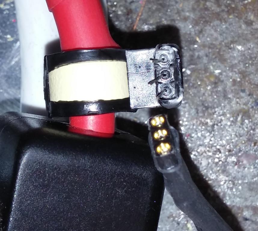

The Grand Rapids CS-02 is a POS!!!
I bought one and while wiring it up it fell apart. The wires snap onto the ring with a plastic clip and this clip is VERY fragile.
Grand Rapids replaced it for free and the second one fell apart during the assembly so I will not go that route again.
Can someone please give me a suggestion for a ring type current sensor that I can use in lieu of the GS-02?
Cheers!!!
Bill Hunter

Been there, done that, didn't get a t-shirt.
The issue with these is very easy to fix (if you want to). Here's what I found out happened:
See how pretty the pins are? The wires are supposed to be soldered to those pins. But the guy they had assembling these was just stripping the wires, laying them next to the pins, sliding the heat shrink tubing down and then heating it up.
So all I did was solder the wires directly to the pins and cover with heat shrink.
Been working great for the past six months.

Thanks Don... my soldering skills + very small wires = POS.. so I better think of something else.

The sensor itself is okay, it's the choice of
connectors. Those are not designed for life
under the hood . . .
I used them INSIDE totally enclosed appliances
and even then, they're secured mechanically
against vibration induced disconnect.
I designed that line of sensors into B&C's
standby alternator controller decades ago and
it has performed well.
But you do need to solder the leads on . . . and
Grand Rapids would do well by their customers
to rethink their choice of attachment. B&C ships
the sensor with lead wires already installed.

The picture you posted appears to be the
three pins on a hall-effect sensor threaded
onto a current carrying conductor.

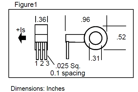

We use the AmpLoc series devices similar to
what I thought I see in your picture.
[img]cid:.0[/img]
I can install a harness on the sensor for you
if it would help.
