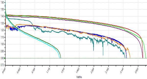

The energy traces below show a generic pair of alkaline
AA cells that have delivered ~1.4 Watt-Hrs of energy . . .
about the same numbers as the first experiment in 2002.
Then we have a trio of traces that have delivered 3.6
Watt-Hrs of energy or about 2.5 times that of the
non-lithium cell.
There are three additional traces of interest . . . they
too are generated by the discharge test of some advanced
lithium cells. The general shape of the curves are the
same as for the first three described above . . . but they
averaged a 15% lower value of delivered energy and the output
voltage is 'ragged' or unstable.
[img]cid:.0[/img]

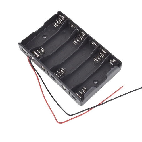

This is caused by tiny amounts of resistance introduced
by the connections to the test equipment that can arise when
the cells are connected with the spring-loaded holders
common to 99.999% of all cylindrical cell powered products.
[img]cid:.1[/img]
These resistance values are small . . . and generally have
little effect on appliance performance for applications
with smaller current demands. The tests I'm conducting use
a 300 mA constant current discharge rate. At this rate . . .
and anything higher . . . there is a potential for battery
holder resistance to degrade system performance.

My energy studies are being conducted with cells having
SOLDERED leads eliminating the holder issues . . .
indeed, one could build up disposable cell arrays using
similar techniques. But they need to be done with care
lest the cells be damaged by soldering heat.

I have encountered AA cells offered with creative
advertising hyperbole . . . and found them to
be short on snort.
However, the cells I posted about earlier today
were discharged on an well instrumented, 300 mA
constant current load. So irrespective of the
cell's c-rate, I was comparing the various
offerings under identical test conditions.
I'll do some more detailed comparisons of these
cells and get some internal resistance measurements
at various points along their discharge profiles.
non-lithium cell.
[img]cid:.0[/img]
[img]cid:.1[/img]
This fact is part of the foundation for why I explored
and ultimately recommended the 9v alkaline cells in a standby
battery application a few days ago. The very low current
demand in the application under discussion did not exclude
the 9V cell.
Obviously, the AA cell offers a larger energy bucket for
such tasks . . . but getting a firm electrical grip on
the cell's electrical energy is a bit more problematic.
It would be really cool to use tab-welders common the Ni-Mh
and Li-Ion arrays. The AA alkaline cell has a really small
(+) terminal . . . more difficult to weld on. I have some
alkaline D-cell arrays for video cameras that were welded . . .
but the AA-cell is more problematic.
I may do an article on the techniques I use for soldering
to AA-cell . . . it's not difficult.
