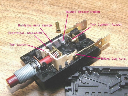

Speaking of some circuit breakers that are not suitable to the task, I can vouch for that. I purchased a Schurter 3 amp circuit breaker, part number
4400.0010 to protect an over-voltage relay circuit. Before installing it in the airplane, I tried it out on the workbench. Instead of tripping when the crowbar circuit shorted out, the breaker continued to conduct and smoked. Although the smoke was not enough to be a hazard, it could be enough to distract a pilot and contribute to an incident.

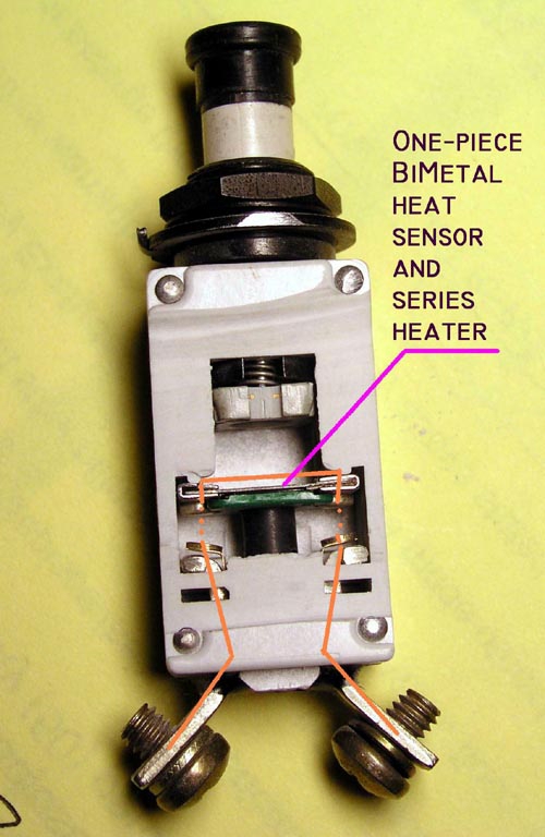

Some off-hand numbers were offered a dire
predictions for failure-to-perform under
extreme fault conditions. I did some bench
demonstrations that measured much more
benign conditions than 'predicted' along
with citations from a military test
protocol by which our favorite breakers
are judged.
[img]cid:.0[/img]
These guys are tested under conditions far more
severe than those impressed upon it with
a crowbar ov protection system.

But in any case, demands placed on the breaker
used with crowbar ov protection are beyond the
capability of some products. Fortunately, the
commercial clone of the military qualified
miniature breakers are quite suited to task.

Was it you who sent me this breaker?
[img]cid:7.1.0.9.0.20170506201431.04e4a280(at)aeroelectric.com.0[/img]
I think it's a Schurter breaker. Uses a thin metal
'heater' to warm a bi-metal trip 'thermostat'. High
current faults would burn the strip before the thermostat
could sense and react.
