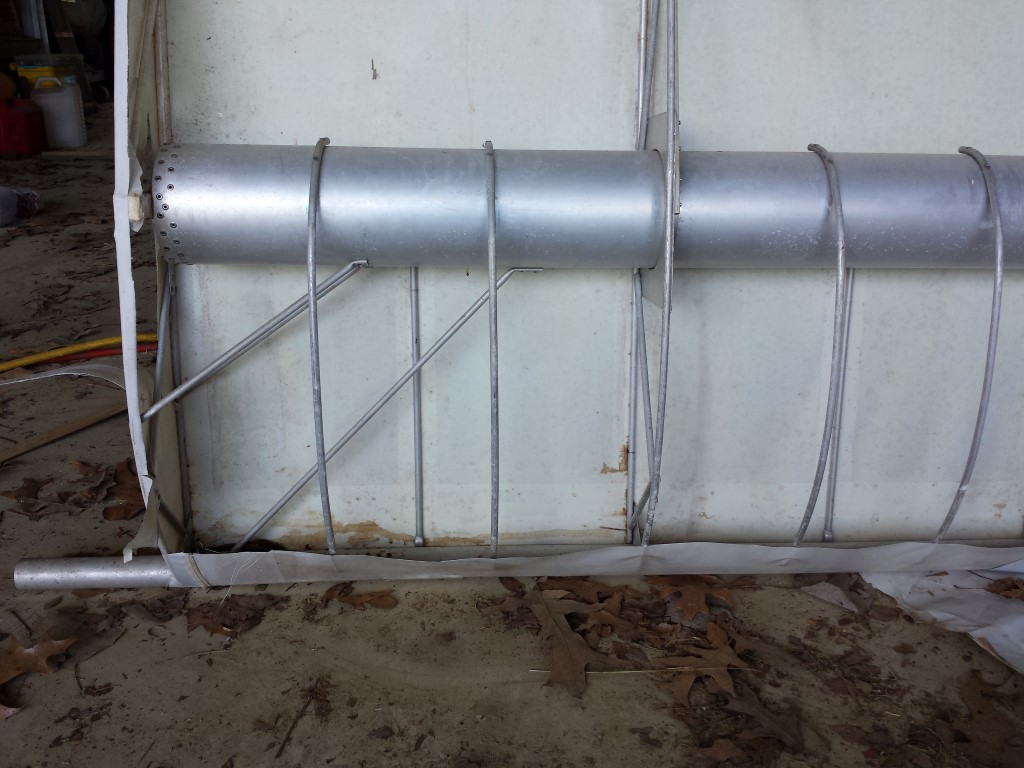

John,
You mentioned leading edge bracing. This is all I see in the Twinstar I'm restoring. There's nothing along the rest of the leading edge that triangulates/ braces the leading edge.
Would you consider this adequate? It's easy to add now, with the cover coming off.
Charlie

PostPosted: Thu Apr 13, 2017 6:17 pm    Post subject: Re: Leading edge bracing; was: Kolb Twinstar (original versi Reply with quote
I'm not John, but if you scroll down to page 21 in the MKIII Yellow Book, you will see Dennis Souder's drawing of what Kolb thought to be a very useful reinforcement for the outboard rib. Combined with the bracing you already have, it helps keep the leading edge ribs in column.
