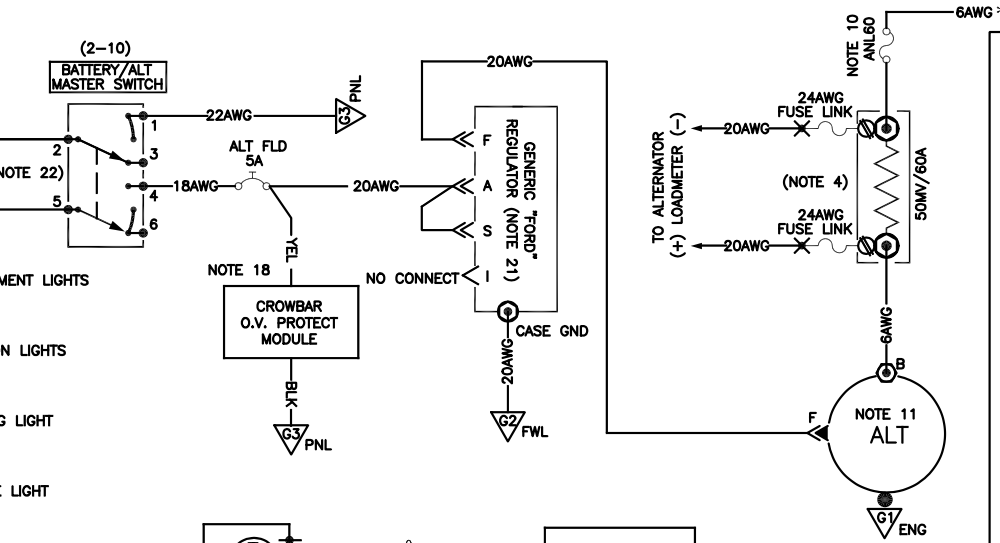

One point that is not clear for me about the internal/external VR discussion. I apologize in advance if this has been clarified somewhere else and I just missed it.
I don't understand why or how an external voltage regulator can safely cut the field using the crowbar method and an internal regulator cannot. If I look at the wiring diagrams there does not seem to be a difference. Is it just that the external VR is more robust?
Thanks for any clarity you can provide.

The internally regulated alternator gets its field power from within the alternator. There is no easy way for the pilot or for an over-voltage protection module to interrupt that power.
The externally regulated alternator gets its field power from a panel mounted fuse or circuit breaker or switch. It is much easier to interrupt the external field power source.

Yes, this is what I thought as well, but looking at the Z diagrams for how to wire an external VR, it looks like control of the F is only done by the VR, so I'm struggling to see a difference between and Internal and and External VR.

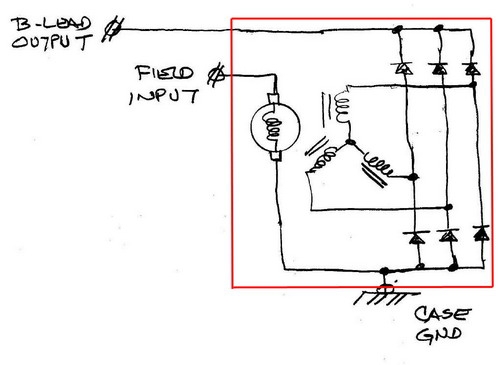

The externally regulated alternator has NO electronics
inside . . . just a rudimentary alternator.
[img]cid:7.1.0.9.0.20170425080902.0207e8c0(at)aeroelectric.com.0[/img]
Interrupting the 'field input' line offers total
control over alternator output.

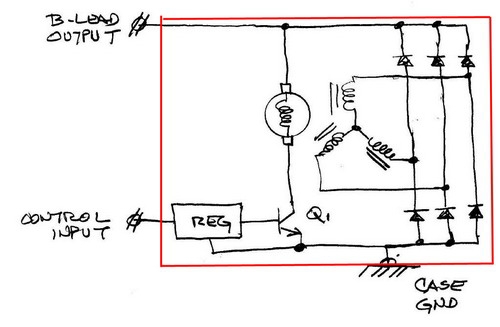

The internally regulated alternator has solid
state devices that control alternator output.
There is no field power input connection, only
a 'control' connection that talks to the
electronics.
[img]cid:7.1.0.9.0.20170425080902.0207e8c0(at)aeroelectric.com.1[/img]
There are failure modes INTERNAL to the alternator
that can cause an over voltage condition . . . a
condition not controllable from outside.
But the crowbar ov module in turn controls power
to the external regulator. Opening the field power
source to the regulator will also shut down the
alternator. That 'control' lead into an IR
alternator cannot be guaranteed to offer
absolute control under all failure modes.
