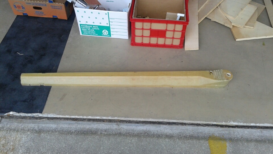

I apologize in advanced but I may need the forums help to identify some of the parts on kit A291 (I'm sure Marty will also chime in). I have been able to do well with most of them but I haven't been able to identify some of the parts I have.
One part I haven't been able to identify is this I include a picture of. It is a long slender part made of glass with a wood core at the wide end.

Thats the sternpost, along the rear of the vert stb, that the rudder hinges attached to and the tailwheel spring goes through (thus the hole).
Arildite 420 is the adhesive for the bonding of the prepreg parts. Huntsman sells it in the US. Aeropoxy is used for layups on the Europa.

Thanks on identifying the Sternpost. Now I remember that for a brief moment I though about that (due to the xsection). But I didn't make the correlation. Thanks again.
