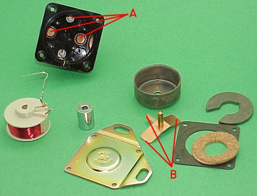

Actually, the "I" terminal is a holdover from
the early days of the transition from 6 to 12
volt cars. It was deduced that the original
6v Kettering type ignition coil could be
retained if one simply added a resistor in
series with the coil . . . the added source
resistance REDUCES coil charging time and
you got better performance at higher RPM.
A further benefit was realized by adding
the "I" for ignition terminal to the starter
contactor. This was used to bypass the coil
resistor increased spark energy at low
RPM of engine cranking. You can see the
full disclosure of the 3-terminal starter
contactors here:
[img]cid:.0[/img]
All three 'floating' terminals of the
power path through the contactor get connected
together simultaneously with the motion of
"B" against "A" as suggested by the schematic
below.
Fully floating contacts were necessary to achieve
design goals for the automotive world . . . and
they're handy for our purposes 60 years later to
drive a light bulb . . . but the same goal can be
achieved by attaching driving the light directly
from the starter motor's power input terminal.
Don't forget to fuse the wire at the starter
end if driving a lamp . . . or you could put
the LED's current limiting resistor in series
with the wire at the starter end and eliminate
the fuse . . . the resistor will protect the
shorted wire.
