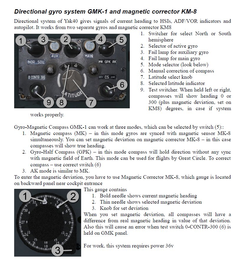

Getting rid of the deviation is easy if the whole card needs to be adjusted, like Walt says, just turn the flux valve to suit.
Does anyone know how to adjust the KM-8 Correction Mechanism that hides behind the back seat on the yak-52? It looks like this..... https://forums.eagle.ru/attachment.php?attachmentid=135933&d=1457048380
I am guessing that by looking at it the adjusting know makes the same correction as turning the flux valve does, but has anyone else played with it?
Cheers
Chris

Ttail
Joined: 24 Jun 2013
Posts: 122
PostPosted: Mon Apr 10, 2017 2:09 pm    Post subject: Re: [Non-DoD Source] Re: Gyro compass adjustment Reply with quote
This from a YAK40 manual might be of use:
 Filesize:  193.29 KB
 Viewed:  6837 Time(s)

PostPosted: Fri Apr 14, 2017 1:06 pm    Post subject: Re: [Non-DoD Source] Re: Gyro compass adjustment Reply with quote
I fly from a grass airfield so no compass rose painted on the ground here!
We use the old school method with a calibrated compass. The gyro compass system in the Yak is awesome! The Correction Mechanism behind the rear seat has an adjustment for the deviation, and a slave indicator for the ones on the panels. Mine was accurate to within a degree on all the compass points straight out of the box.
The little magnetic compass however wasn't quite so accurate, but a few tweaks and it is now close enough for government work.
Job done, and it didn't turn out to be rocket surgery at all! Thanks to all for their input.
