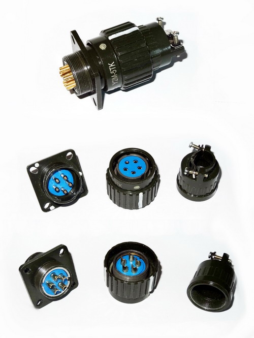

There's a relatively new kid on the block in
the community of robust connectors. I've
been seeing offers for several years but didn't
have time/inclination to explore them.
A few weeks ago, I ordered a Y2M-5TK, 5-pin
'military' connector for a hands-on, look-see . . .
[img]cid:7.1.0.9.0.20170411122838.0547c8e8(at)aeroelectric.com.0[/img]
This connector has lots of cousins offered all
over the 'net. An exemplar constellation of
offerings can be found here.
http://tinyurl.com/mt78ajg
The prices are VERY attractive. The quality is excellent.
The only down-side is that you need to hone your
soldering skills. I'd have no problem with using these
connectors in application on our airplanes.
Note: The backshell on the cable end has a fine LEFT
HAND THREAD. Further, you need to have the connector
halves mated thus securing the cable innards for
tightening the backshell. The fine thread is a
little fussy getting it started . . . easy to
cross thread.
