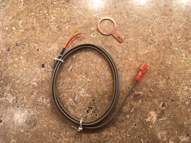

I recently purchased the MGL 18mm spark plug CHT probes from Aircraft Spruce.  The photo on both their website and MGL's shows a copper ring soldered to a K-type thermocouple wire, a pretty standard setup.  What they sent me is pictured below.  Since the bare wire ends connect directly to the RDAC brain box, I deduced that the other end- a 1/4 PIDG fast-on, crimped to the thermocouple wires- must just attach to the copper ring.  The tab end of the copper ring is exactly 1/4 inch, so this makes sense.
This seems like a pretty cheeseball setup.  From what I know of K-type thermocouples (mostly from reading the 'Connection) that wires must be silver soldered to the probe and to each other.  Or, am I mistaken and is this a reasonable setup?

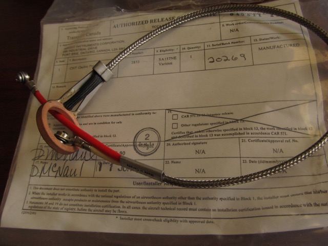

What you have will probably work just fine but yes, the high dollar thermocouples usually silver-solder the wires to the copper ring and incorporate a support (pic), however they’re amazingly expensive.

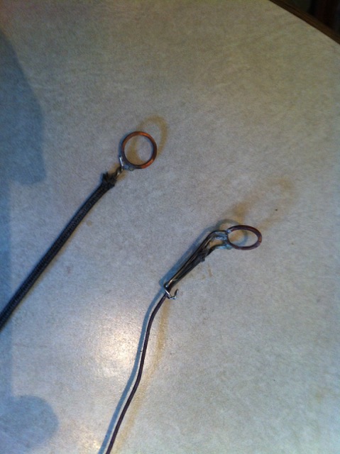

Silver-soldering is a good skill to learn and does not take much more than a propane torch and the proper materials. Here are a couple I made as an experiment (2nd pic). They use copper sparkplug gaskets and a piece of stainless welding wire as the support. A “resist” is a material applied to the parts that you don’t want the solder to flow onto. Wite-out makes a pretty good resist. The tricky part is jigging the parts while you heat them. This place has all the supplies and there are many Youtube videos.
