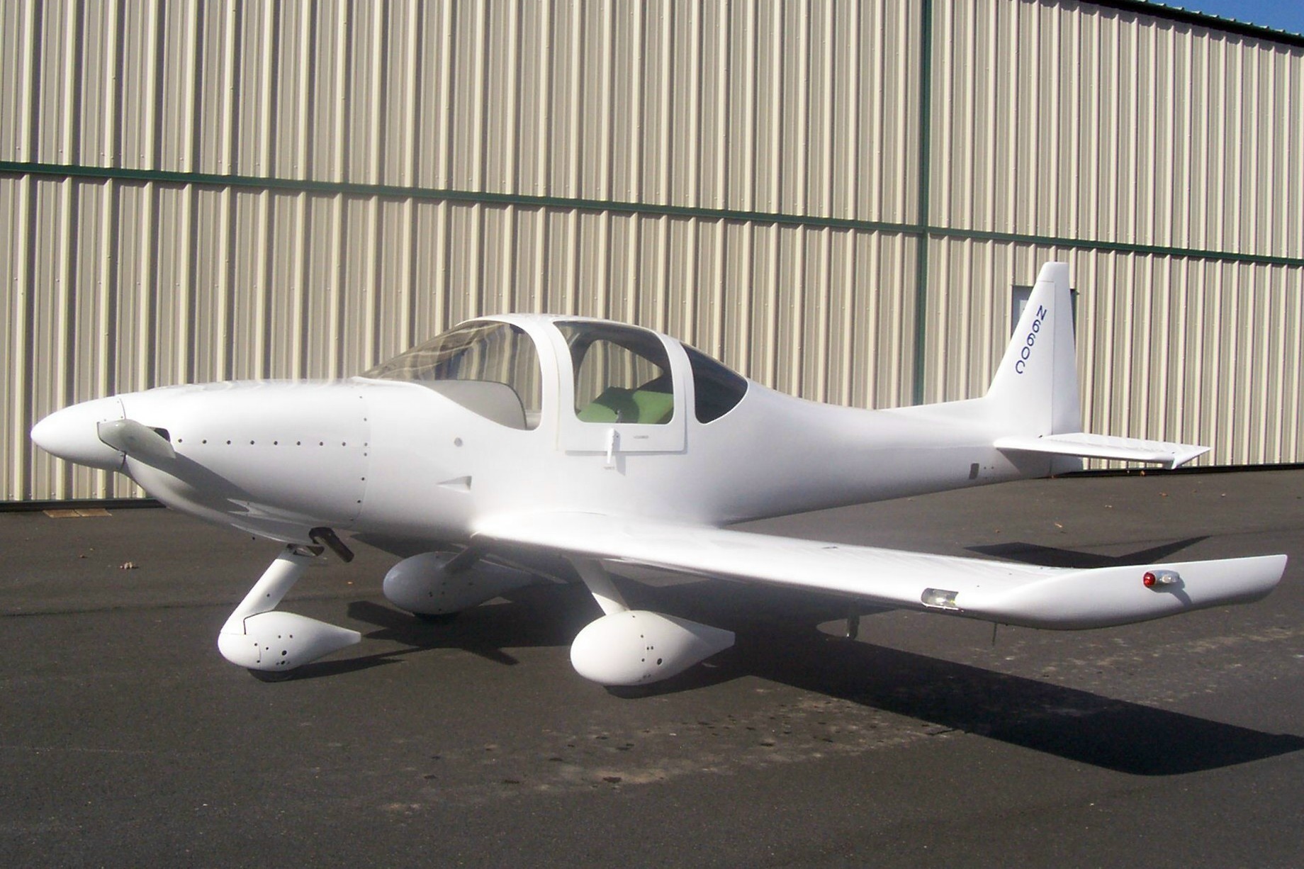

Hello Steve, You are continuing to get input regarding your comment about
desiring to put wheel pants on your airplane. Please let me add my 01.5
cents (remainder of 02.0 cents to follow -- maybe). Let me also add again
that this is not a trivial, bolt them on and go, project.
1) Here is the Van's Aircraft web site where you can purchase the below
listed items (you don't have to be building or own an RV aircraft in order
to purchase these items):
https://www.vansaircraft.com/cgi-bin/store.cgi?ident=1491153716-334-519&browse=airframe&product=wheel-pants
2) This pair of items will fair the KIS TR-1 main landing gear strut legs.
Do not attempt to use the hinge pin method of closing the trailing edge --
it won't work. I use the same white tape that the glider people use when
they take their sailplane out of the trailer and assemble it to fly:
Fiberglass fairings for the RV-8 flat bar main gear legs (per pair).
Part Number = GEAR LEG FAIRING FLAT
Price = $175.00
3) Here is almost everything you need for your main landing gear wheel
pants. Creating the lower end of the landing gear strut fairing into the
wheel pants is your job:
Wheel pants for RV-8 flat bar gear
Part Number = WHL FAIRING KIT,PRFLT
Price = $375.00
4) Here is what you need for the nose wheel pant:
Wheel pant for 6A/7A/8A/9A Nose Gear
Part Number = WHL FAIRING KIT,NOSE
Price = $140.00
If you have not been thoroughly intimidated by now and want to continue on
to create a fairing for the nose landing gear strut and an interface between
that fairing and the nose wheel pant (see the attached 100_0311.jpg picture)
just let me know and I'll lay it on you. I still intend to take some
pictures of the pants off the airplane the next time I get out to the hangar
and send them to you.

OK, here is what I did for the nose gear leg fairing:
1) I contacted Glasair, (360-435-8533) got assigned a customer number, and
ordered the two fiberglass pieces that are part of the Glastar / Sportsman
kit nose gear leg fairing. See here:
http://glasairaviation.com/
and here:
http://glasairaviation.com/wp-content/uploads/2016/07/GlaStarSportsman_Tech_Info_Kit_Contents_GA_-_Revised_Small.pdf
2) I acquired the pages from the Glastar builders manual and put together
the fairing. If you purchase those two pieces in 1 above I will mail you a
copy of those pages.
3) After a couple years of head scratching I put together my Glastar strut
fairing and my RV nose wheel pant. Pictures to follow.
Please let me know if you have any questions.
OC
Price = $175.00
Price = $375.00
Price = $140.00
between that fairing and the nose wheel pant (see the attached
100_0311.jpg picture) just let me know and I'll lay it on you. I still
intend to take some pictures of the pants off the airplane the next time I
get out to the hangar and send them to you.
OC

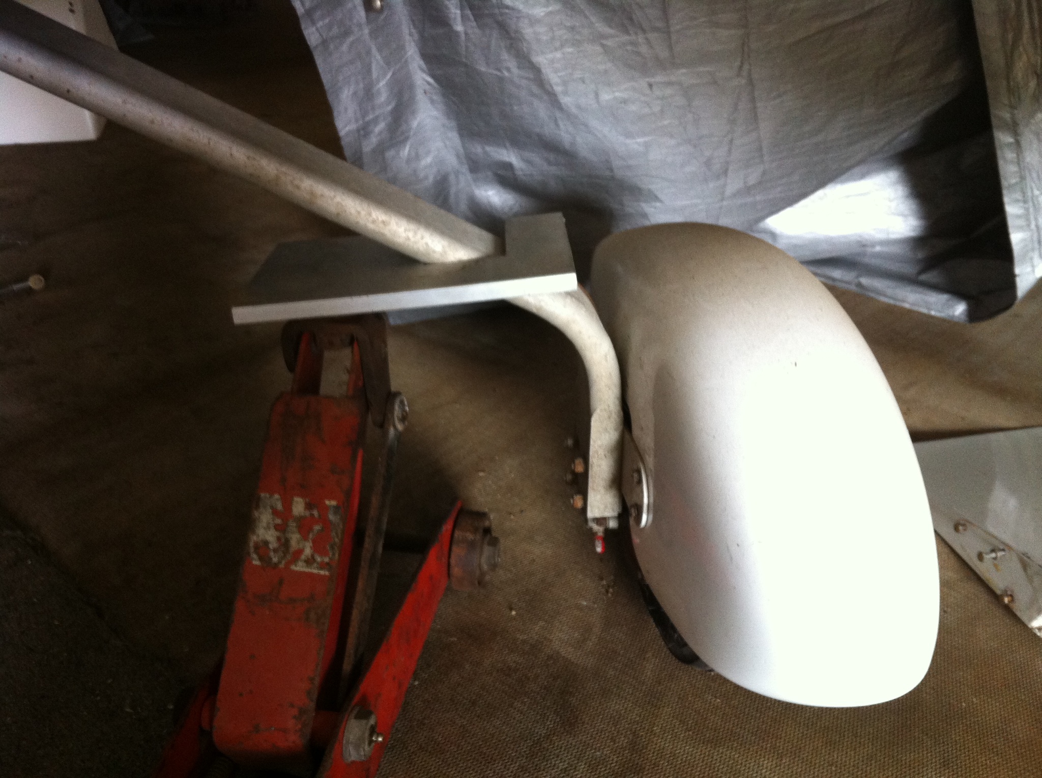

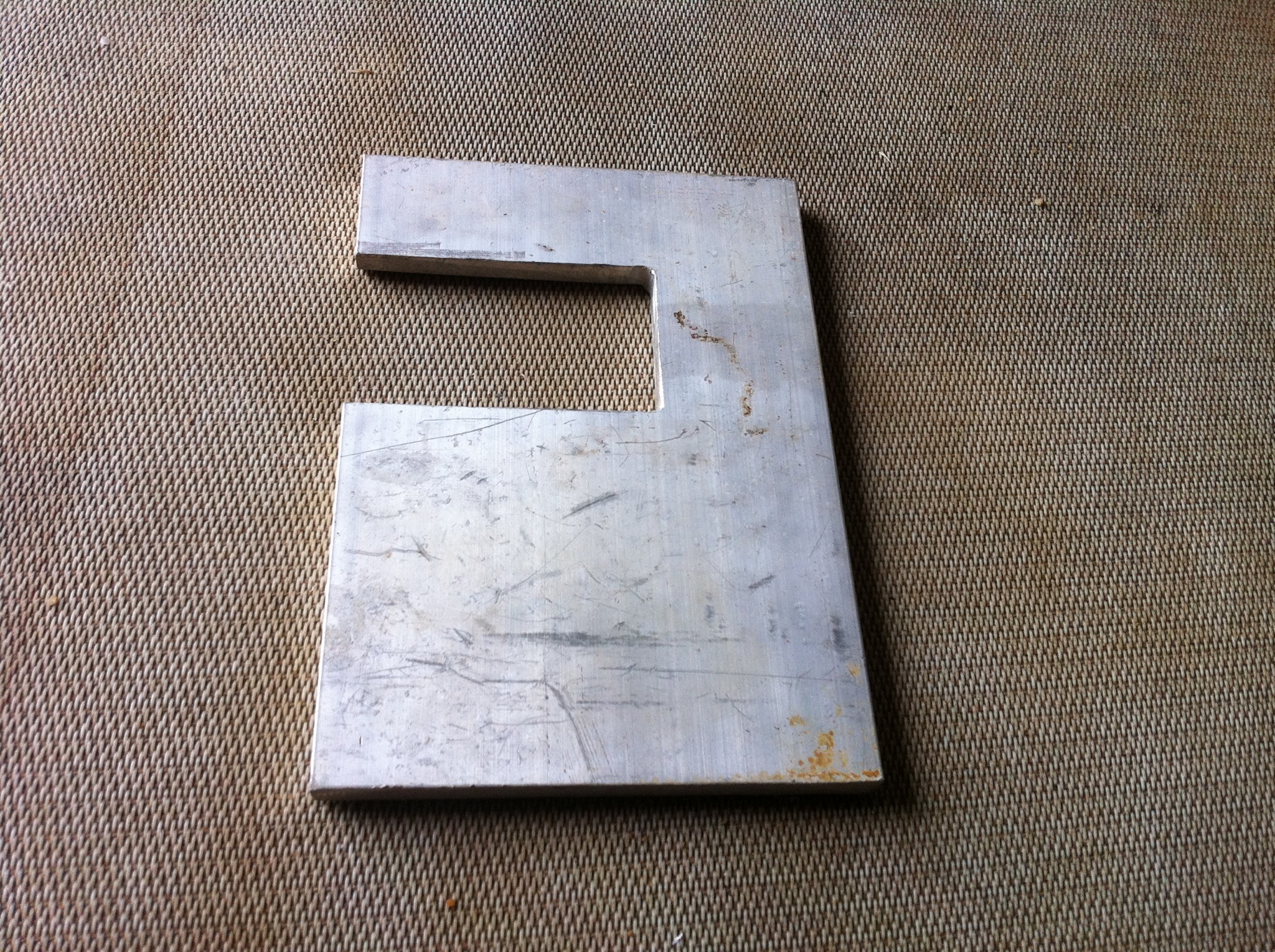

Howdy .... My Flat bar Main Gear Hoop jack
Sent from my iPad

> The original Wheel fairings supplied by Rich are very similar to Aircraft Spruce wheel fairing MF-4 part number 05-01218. This is not exactly like the originals but should work if you have some fabricating ability. Aircraft Spruce does not supply any attachment brackets, you are on your own to figure that out, but as owners of experimental aircraft that is what we do.
> The size of the original KIS “Boots” as Galin refers to them (after all as kids we put on boots to go out and play) are as follows:
> 10.5” Tall
> 6.5” Wide
> 29.5 “ Long
> Wheel Opening:
> 5.75” Wide
> 14” Long
> Richard also supplied a inside cover that covered the Gear leg and mounting bracket. Builders had to fabricate their own attachment brackets as well as landing gear leg and transition fairings, which some builders did, and some did not. Builders also (to the best I can recall) had to cut the nose gear boot apart and fashion their own joggle joint. Vance issued a supplement to the builders manual in a newsletter depicting how this should be done.
> Another excellent choice would be a set of boots from James Aircraft. http://www.jamesaircraft.com/?page_id=47
> You must call this guy on the phone, he is not electronic. These are very similar to the RV boots (OC has a set of RV boots on his TR-1) but are much more petite, way cooler, and probably more efficient. You would not have to split the nose gear boot down the center like you would the Aircraft Spruce MF-4s, these have front and back halves. JA may also supply mounting brackets. If you were careful you might even be able to mount them without having to go through the trouble of fabricating gear leg, and transition fairings.
> MT
> http://forums.matronics.com/viewtopic.php?p=467952#467952
> <100_0311.jpg>

Oh .. and the how it works .. ( tried before .. not sure if this is a repeat
send or ?)

OC, I was wondering, with the wheel pants etc, did you see any
improvement in speed at cruise and max throttle?
If so what was the difference from speed without wheel pants etc.
Rob
> order to purchase these items):
> legs. Do not attempt to use the hinge pin method of closing the trailing
> edge -- it won't work. I use the same white tape that the glider people
> use when they take their sailplane out of the trailer and assemble it to
> fly:
> Price = $175.00
> Price = $375.00
> Price = $140.00
> on to create a fairing for the nose landing gear strut and an interface
> I get out to the hangar and send them to you.
> OC
