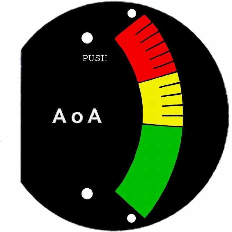

PostPosted: Tue Apr 04, 2017 6:26 am    Post subject: Re: VG's, tail stall, angle of attack Reply with quote
We shouldn't get upset because some people like to use correct and accurate terminology when talking about a phenomenon.
Charlie, I think your response is brilliant. For those of us who do want to use the correct term to describe what is happening I applaud your insight
and I can help with that. I make (and sell) an inexpensive Angle of Attack indicator that dozens of people love. After my last batch of probes and gauges ran out I haven't pushed it but am redesigning the probe for it and can offer it again. There is a link to it on my site ranss7.com New faces will have the needle more or less horizontal with red at the top (high angle) and green at the bottom.
And on the subject of VG s on stab, aren't they usually placed just ahead of the hinge line where the air is going to break as it goes over the elevator not up near the leading edge???
