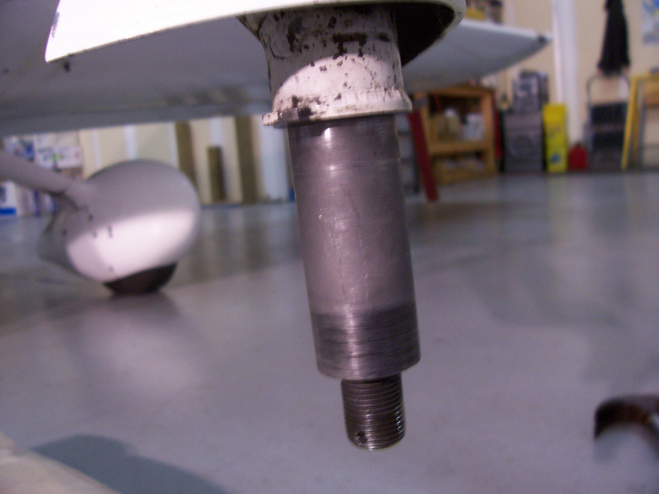

1) I was never happy with my first (#1) Lyle Hendricks round tube nose gear
strut. It was very sturdy, but it had two manufacturing / design defects in
my opinion.
a) The bottom vertical 3/4-16 threaded stud potion was too short. This meant
that a thin AN320-12 castle nut must be used instead of the normal
thickness AN310-12 castle nut. This further meant that the total nut-to-stud
thread interface holding the aluminum shoe and any washer stack up into
place was pretty limited. I was concerned that that interface could fail and
the entire shoe and nose wheel could fall off in flight.
b) The cotter pin hole through the bottom of that stud did not pass through
the center of the stud. This off set meant that the pin would not pass
through the normal castle notches in the AN320-12 nut. A person had to grind
/ file the nut notches wider in order for the cotter pin to pass through the
nut. This had two effects: ONE) The nut could not be rotated one notch at a
time to adjust the friction keeping the shoe from shimmying on landing roll
out unless each pair of notches was ground or filed wider. TWO) Grinding or
filing all pairs of notches wider further reduced the nut-to-stud thread
interface.
2) So my solution after over 500 flight hours with no problems other than
dealing with the two irritating issues described above was to have Lyle make
for me a new nose gear strut (#2) with modifications to eliminate the two
issues. I also had Lyle make some other design modifications to this #2
strut assembly such as a longer threaded portion at the top of the
compression rod and a welded cross bar at the bottom of the rod. The longer
threaded portion at the top of the rod gave more vertical adjustment
opportunity for the rod and the welded bar permitted one to hold the rod
from rotating when wrenching nuts at the top of the rod.

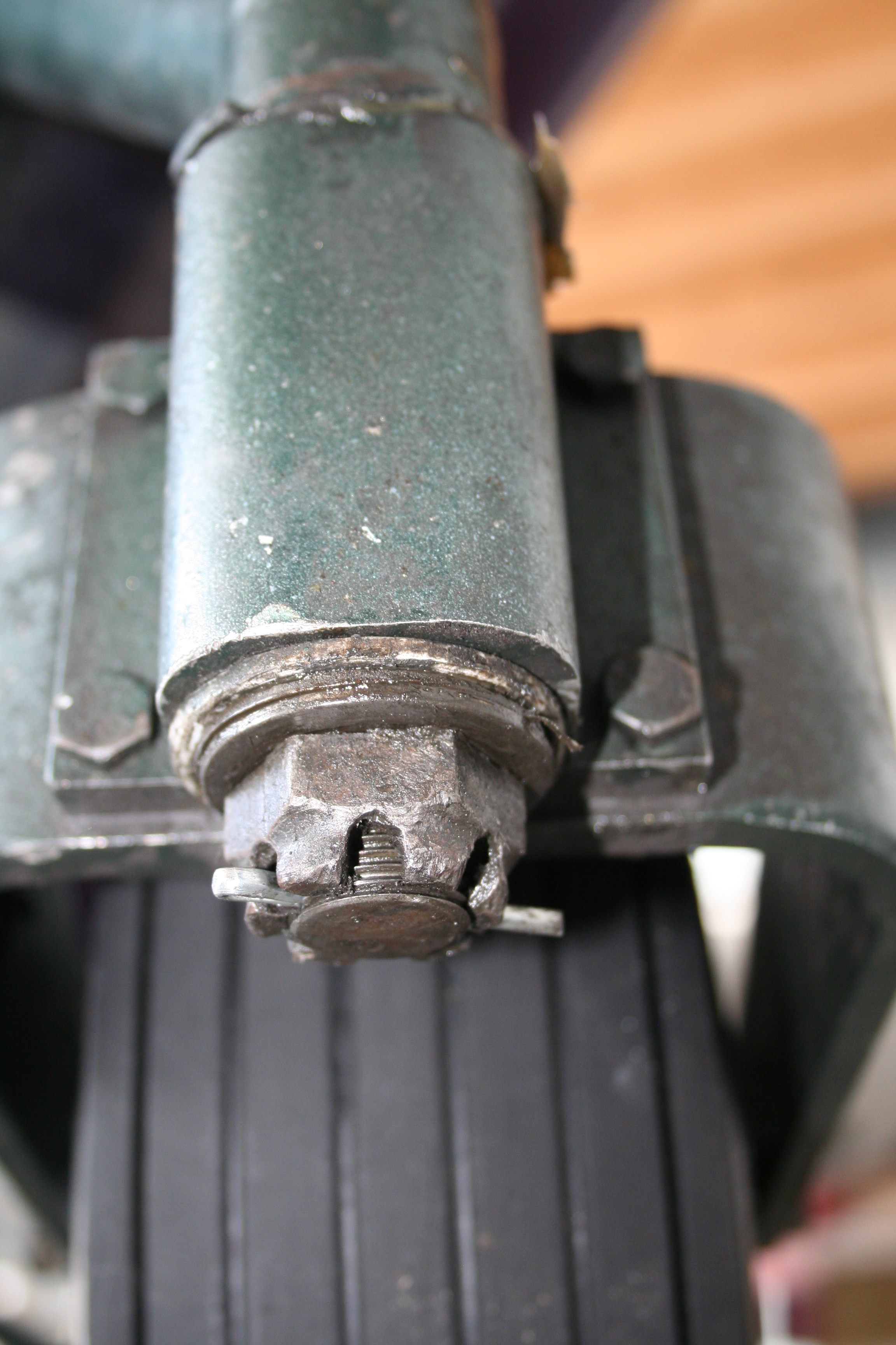

PostPosted: Mon Mar 27, 2017 6:52 am    Post subject: Can anybody confirm this? Reply with quote
I think it was a bit a bad luck with OC 's shortened stud . Mine was made a
few months later by Lyle and he had noted the problem and fixed it, so i
guess it depends upon when it was made in the production series
(See attached file: IMG_9929.JPG)

bakerocb
Joined: 15 Jan 2006
Posts: 727
Location: FAIRFAX VA
PostPosted: Mon Mar 27, 2017 9:22 am    Post subject: Can anybody confirm this? Reply with quote
3/27/2017
Hello Keith, Thanks for your input. You wrote:
1) ".... he had noted the problem and fixed it..."
I don't think so. Your picture appears to also show a thin AN320-12 shear
type castle nut in place with a fairly thin washer stack up (Bellevilles?).
This would be consistent with the same length of the 3/4 inch diameter
portion of the vertical stub as my #1 Lyle gear. I have seen no evidence
that Lyle changed the length of the 3/4 inch diameter portion of the
vertical stub until (at my request) he made it a bit longer for my #2 and #3
weldments.
See the attached picture of the vertical stub on my #1 Lyle nose gear. I
initially thought that the 3/4 inch diameter portion of the vertical stub
was a machined out and threaded continuation of the vertical stub steel
immediately above it (all one solid piece). I later learned that I was wrong
and that the 3/4 inch diameter portion was, in fact, a separately obtained
bolt whose head (maybe machined round first) was inserted into a hole in the
steel above it and welded into place. Only after removing my #1 Lyle gear
from the plane and examining the end of the vertical stub with a bright
light and a magnifying glass was I able to see the evidence of a weld bead.
I speculate that Lyle obtained these bolts from McMaster-Carr and that the
quality control of the original manufacturer of these bolts was not
pristine. The cotter pin holes were not exactly through the center of the
bolt (I have noticed a bit of this on the bolts in my #2 and #3 Lyle gears
as well) and the cotter pin hole in the end of the bolt in my #1 Lyle gear
was too close to the end of the bolt for my comfort.
Any questions?
OC
<4-9-16 CAMERA 003.JPG>

See the photo from Keith Miller (thanks Keith) that is attached to this
email.
This shimmy can become violent enough to damage the nose gear linkages,
collapse the nose gear, and cause the nose of the airplane to fall down and
contact the runway surface.

> On Mar 27, 2017, at 1:21 PM, Owen Baker <bakerocb(at)cox.net (bakerocb(at)cox.net)> wrote:
> 3/27/2017
> I don't think so. Your picture appears to also show a thin AN320-12 shear type castle nut in place with a fairly thin washer stack up (Bellevilles?). This would be consistent with the same length of the 3/4 inch diameter portion of the vertical stub as my #1 Lyle gear. I have seen no evidence that Lyle changed the length of the 3/4 inch diameter portion of the vertical stub until (at my request) he made it a bit longer for my #2 and #3 weldments.
> See the attached picture of the vertical stub on my #1 Lyle nose gear. I initially thought that the 3/4 inch diameter portion of the vertical stub was a machined out and threaded continuation of the vertical stub steel immediately above it (all one solid piece). I later learned that I was wrong and that the 3/4 inch diameter portion was, in fact, a separately obtained bolt whose head (maybe machined round first) was inserted into a hole in the steel above it and welded into place. Only after removing my #1 Lyle gear from the plane and examining the end of the vertical stub with a bright light and a magnifying glass was I able to see the evidence of a weld bead.
> I speculate that Lyle obtained these bolts from McMaster-Carr and that the quality control of the original manufacturer of these bolts was not pristine. The cotter pin holes were not exactly through the center of the bolt (I have noticed a bit of this on the bolts in my #2 and #3 Lyle gears as well) and the cotter pin hole in the end of the bolt in my #1 Lyle gear was too close to the end of the bolt for my comfort.
> Any questions?

On Mon, Mar 27, 2017 at 4:26 PM, Owen Baker <bakerocb(at)cox.net (bakerocb(at)cox.net)> wrote:
3/27/2017
Hello Steve, You wrote: "Is there an adjustment I can make?"
This is very dangerous. DO NOT FLY THIS PLANE until the friction nut on the bottom of the nose gear has been properly adjusted.
See the photo from Keith Miller (thanks Keith) that is attached to this email.
This shimmy can become violent enough to damage the nose gear linkages, collapse the nose gear, and cause the nose of the airplane to fall down and contact the runway surface.
I recommend:
1) Elevate the nose of the plane so that the nose tire is off the ground. (Contact me if needed for tips on how to do this.)
2) Attach a fish scale to the shoe holding the nose wheel in the vicinity of the wheel axle. See how many pounds of pull that it takes to move the shoe from side to side. This is to establish what the friction level is now. If it is several pounds less than 27 pounds (which it probably is because of the shimmy) you must adjust the friction level.
3)  Use a black sharpie pen to number the nut notch above the cotter pin head as notch 1. Make a vertical mark on the shoe above notch 1 with the sharpie.
4) Remove the cotter pin holding the large AN320-12 castle nut from turning. Go around the nut with the sharpie numbering each notch in sequence. This is so that you can keep track of the notch that is under the vertical mark.
5) Using a 1 1/8 inch box wrench tighten the nut one notch. Use an ice pick or similar item to ensure that the new nut notch and the cotter pin hole through the vertical stub are aligned. Leave the ice pick in place.
6) Use the fish scale again to move the shoe back and forth to ensure that you have adjusted the friction to the vicinity of 27 pounds.
7) Remove the ice pick and repeat 5 and 6 above if needed. When you have the desired friction level set, install a new cotter pin and lower the nose tire to the ground.
Cool Go fly the plane.
Any questions?
OC

Speaking of the nose gear. I'm getting quite a bit of shimmy on take off and landing. Is there an adjustment I can make?
Thanks!!

Thank you for the info!  I just got back from a 10 hour flight time with several landings.  I wish we could do a fly in weekend some where for especially for us novice TR-1 owners. It would be great to just here from other experienced owners!!
Steve

> 3/27/2017
> I recommend:
