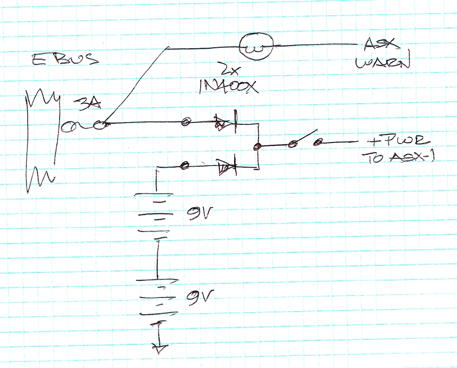

Consider this:
[img]cid:.0[/img]
I guess my priorities are accuracy, minimum weight, and cost in that order
I would value your opinion.
The legacy, alkaline 9v battery has a nominal
energy rating on the order of 500mAH. Suggest two
such batteries in series for a nominal operating
output of 16v falling to 12v at end of life.
The reason for suggesting these devices is their
WIRING. You can purchase snap-clips that make
good connection with the batteries. The 'ideal' cell
for a tiny DIY standby battery is the alkaline AA.
But battery trays for cylindrical cells are rather
flakey under environmental stress and you can't
routinely buy AA cells with welded tabs for low risk
soldering.
The schematic above shows two steering diodes that
insure power to the ASX1 from EITHER source
when the switch is closed. You need the switch to
(1) eliminate drain on the standby battery when
parked and (2) facilitate pre-and-post flight
testing of the installed batteries.
Your check-list would turn the ASX-1 on FIRST
to show that the device comes alive on the standby
battery. Then bring ship's power up and proceed
as you normally would.
The ASX-1 would be turned off last . . . again
showing that the battery is at least capable of
powering the instrument.
Requirements for continued air-worthiness would
simply call for replacing the batteries every year.
The alkaline cell will loose about 15% of capacity
in first year if stored at about 120F.

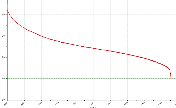

I stuck one of these batteries on the WestMountain Radio
Battery-runner-downer and it tells me that when the
fresh battery is loaded at 40mA (I de-rated from the
13.8V/50mA value in the manual . . . we're battery operating
at a slightly higher voltage into a constant power
demand).
[img]cid:7.1.0.9.0.20170326205809.05379958(at)aeroelectric.com.1[/img]
The fresh Duracell 9v delivered a solid 2 watt-hours at the
40mA rate. A pair of cells would be 4 watt-hours. At 14v
the specified demand of the ASX1 with the display illuminated
is 14v x 0.05A or 0.7W.
Hence, the pair of Duracell 9v batteries can be expected
to carry the instrument solidly for 6 hours . . . for
4+ hours at end of year assuming storage at elevated
temperatures.
The installed weight of this system would be under 0.3 pounds.

The FMEA looks good . . . the system gets pre and post-flight
tested.
This would seem to be the minimalist approach to meeting
the regulatory demand for a back up system that is, like a circuit
breaker, exceedingly unlikely to ever see real service.

PostPosted: Mon Mar 27, 2017 8:18 am    Post subject: Lightweight rechargeable battery backup unit Reply with quote
Bob,
Hesitate to display my ignorance but with the schematic you drew won't the ASX-1 draw power from the higher voltage source, the batteries, until they are depleted to below the E-bus voltage?  Won't replacing the diodes and SPST switch with a SPDT (even an on - off - on) with the center contact going to the ASX-1 solve the issue and provide the same functionality?
Tom Kuffel
